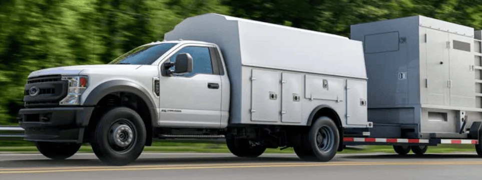

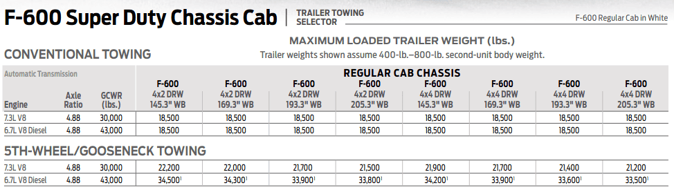

Even the largest Ford Super Duty F-550 & F-600 trucks only need one set of dualies (one axle with 4 wheels) to reach towing capacities of 30,000- 33,500 lbs
Tesla Cybertruck What about us who just want the single motor? ford-Screenshot_20211212_111822
Tesla Cybertruck What about us who just want the single motor? ford-f600
2021 Ford Super Duty Chassis Cab Trailer Towing Selector
https://www.ford.com/cmslibs/conten...df/guides/21Towing_Ford_SuperDuty_CC_Dec3.pdf
Why would Cybertruck Max Duty need dual dualies (two axles with four wheels each) in the rear?
To hold four motors since two would not be enough.
The F-600 uses a huge 6-7L V8. The dual set of dualies allows for better trailer tongue carrying. The photo shows the truck porpoising caused by too much tongue weight. I'm making that judgment based on the slightly wider gap between the front tire and the body. There are plenty of commercial trucks that only use two axles instead of three but I believe Tesla is designing the Semi to tow commercial trailer rigs with a typical post mounted between the two rear axles.

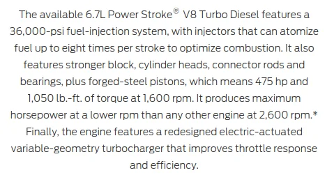

2022 Ford Super Duty POWER
https://www.ford.com/trucks/super-duty/features/power/
Tesla Cybertruck What about us who just want the single motor? diesel-Screenshot_20211212_125752
2017 3/4-Ton Premium Truck Challenge: Diesels on the Dyno
Posted by Mark Williams | May 1, 2017
https://news.pickuptrucks.com/2017/05/2017-34-ton-premium-truck-challenge-diesels-on-the-dyno.html
Power to the Rear Wheels
The Chevy's all-new turbo-diesel 6.6-liter V-8 Duramax made the most horsepower and torque of our four players, recording 385 peak hp and 775 pounds-feet of torque on the chassis dyno. This was just slightly ahead of the Ford's 6.7-liter V-8 Power Stroke, which made 369 hp and 721 pounds-feet of torque. Ram's 6.7-liter inline-six-cylinder Cummins came in third with 332 hp at 2,700 rpm, and 663 pounds-feet of torque at 2,200 rpm. The Nissan's 5.0-liter V-8 - the smallest engine of the group — came in last, making 267 hp and 437 pounds-feet of torque.
