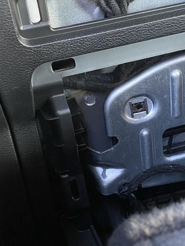

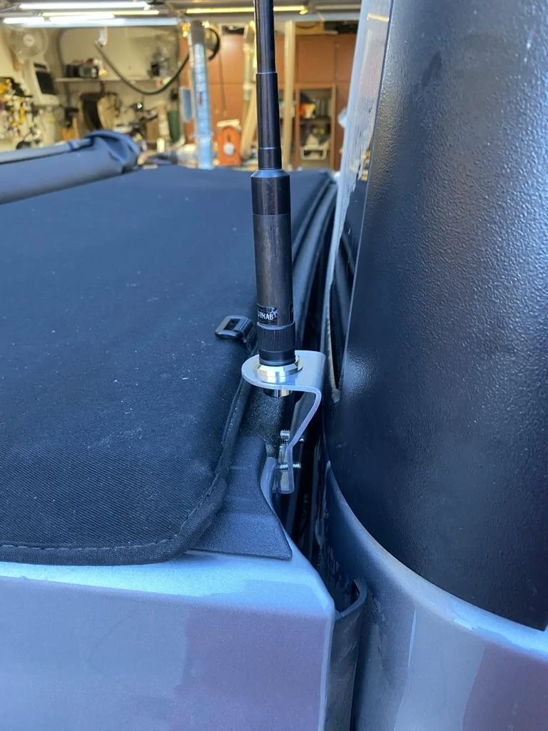

I made my own bracket for my current truck. It's not rocket surgery.
Tesla Cybertruck Where to mount VHF/UHF and HF antennas on Cybnertruck? 1632773555838
Wire entry did require drilling...
Tesla Cybertruck Where to mount VHF/UHF and HF antennas on Cybnertruck? 1632773569886
