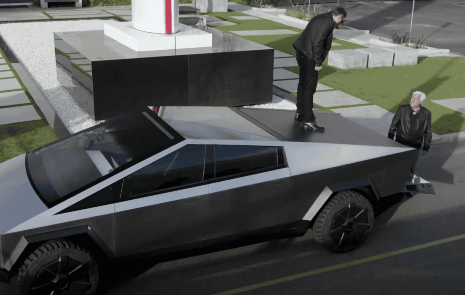

... Where the heck can I mount an antenna that is fed by a coax cable? Drilling 3mm thick steel? Oh no. Any suggestions?
Isn't Elon clearly showing where the antenna should stand?
It is also possible to attach an antenna to the rear gate like the bicycle holder.
With a small flag on it your CT's rear will look like a stern of a navy destroyer.
