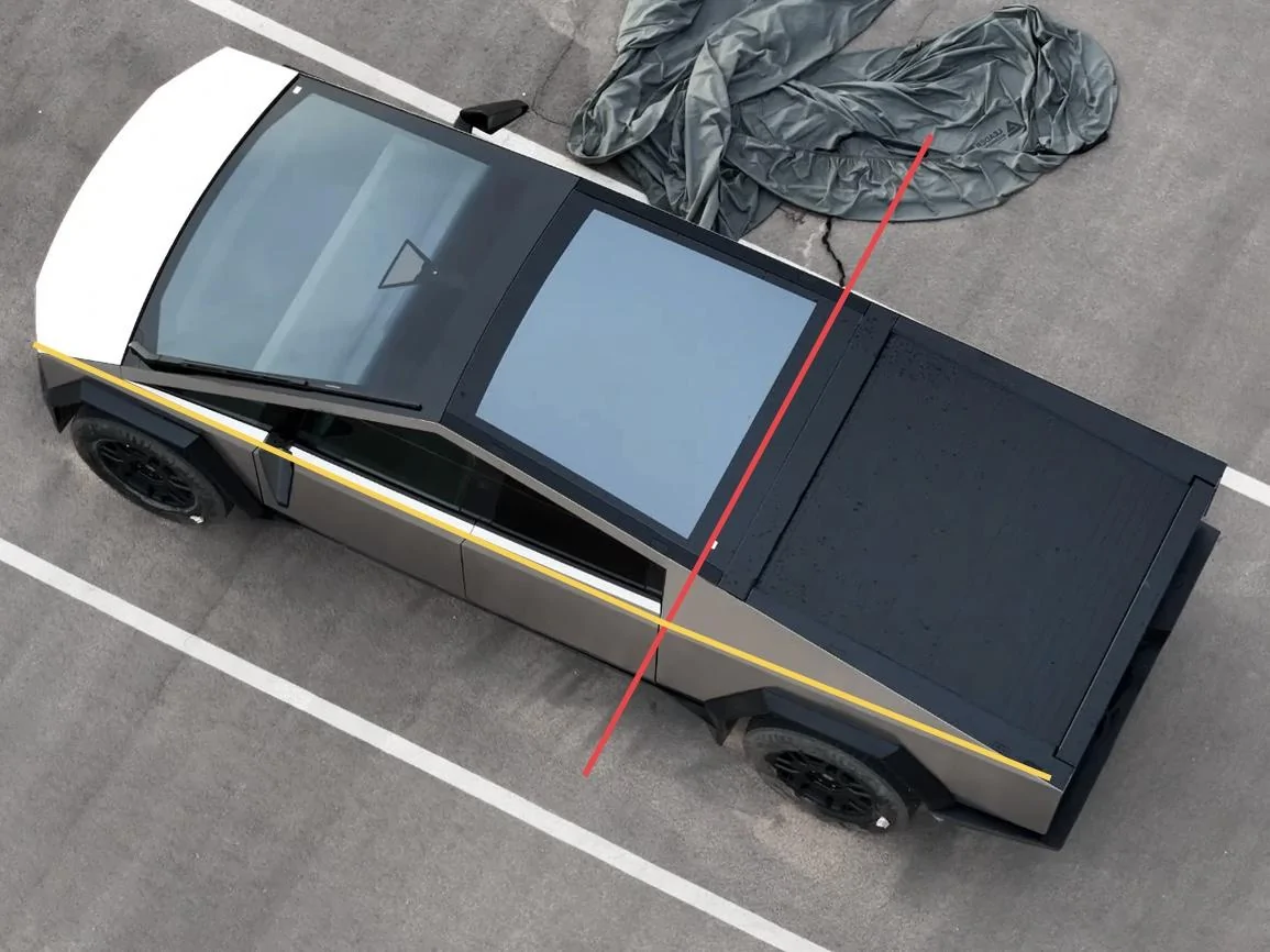

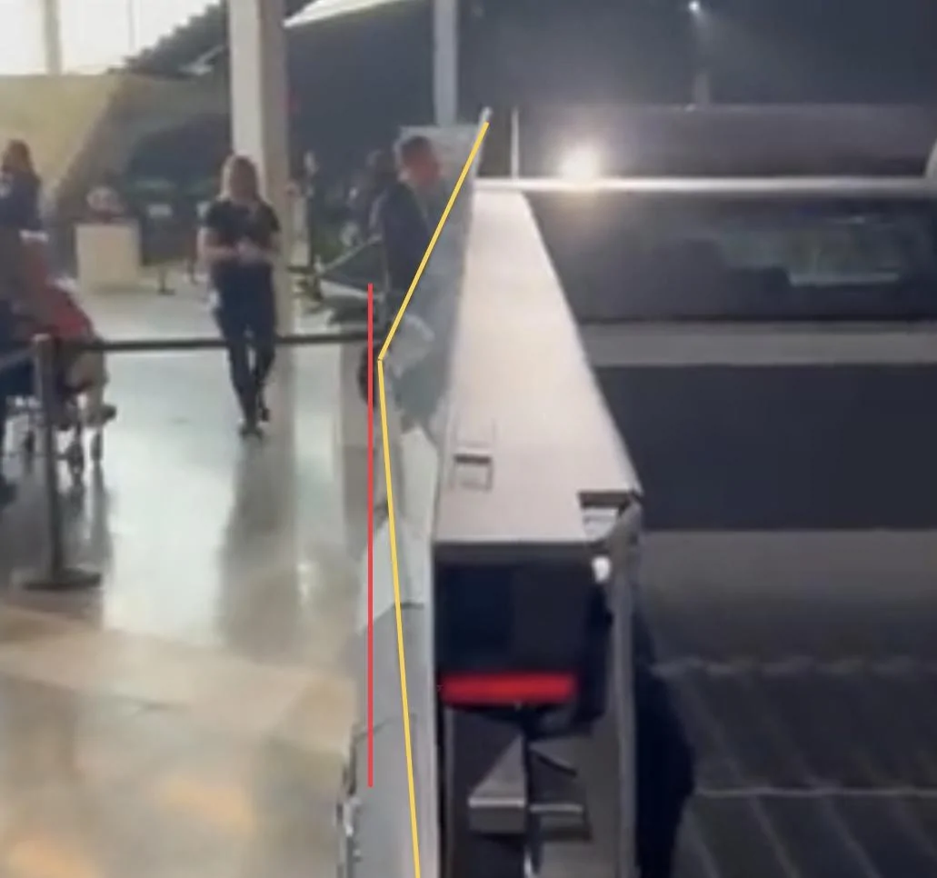

Ok so I went to see the CT in person today and it was huge IMO.
Have been trying to figure out its width withOUT mirrors.
Tesla website says 86.6 w/ mirrors folded but what the body and fenders width?
Other websites say 80, 79.9 or 86.6 without mirrors.
anyone know the actual dimensions?
7,153
13,769
It’s 79.9 w/o mirrors, at it’s widest point (just behind the rear door seam, at the belt line - in the SS, and at the outer edge of the rear fender flares)
79.9 is also the max width w/o mirrors of an F150, etc.
Tesla Cybertruck Width w/o mirrors? FDE0BF49-10E2-48F8-A7E5-895DBD6C71AC
Tesla Cybertruck Width w/o mirrors? C6D99633-1C64-4AB8-AABF-AFB977F1E9D0

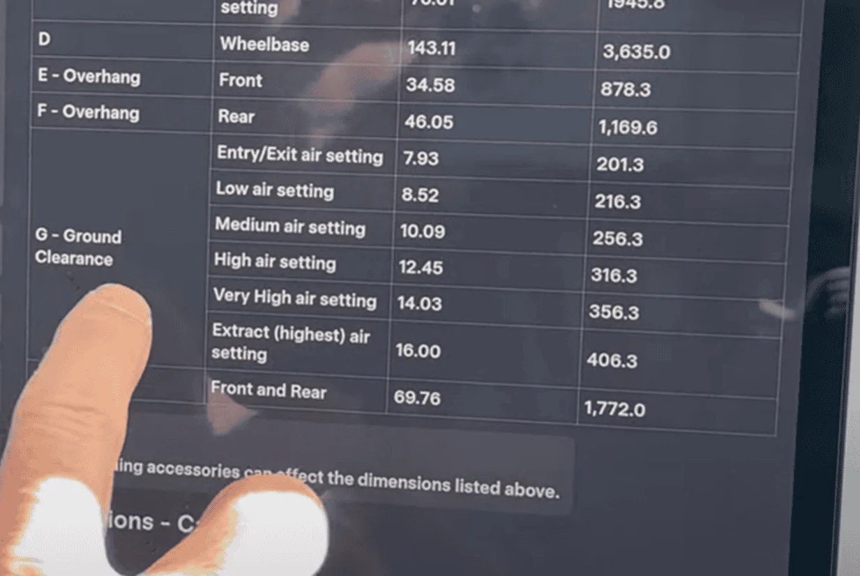

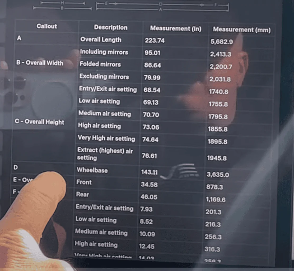

Screenshot taken from the Cybertruck :
Tesla Cybertruck Width w/o mirrors? 1704162130036
Tesla Cybertruck Width w/o mirrors? 1704162160508
These are great! Thank you!
My wife thinks the Cybertruck is way too big so these numbers will help me to give some comparisons to other cars/suvs she thinks are nice sizes.
