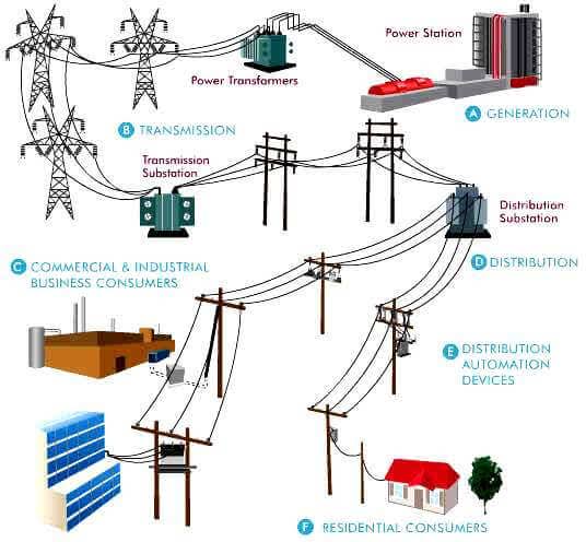

Power in virtually all countries (except isolated islands & micro grids etc,) use 3 phase generation and transmit and distribute 3 phase into suburbs. Even the US.
Tesla Cybertruck Winch - What is the priority? images (22)

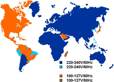

These countries use voltages as shown:
Tesla Cybertruck Winch - What is the priority? images (1)
In suburbia a 415V 3 phase underground line is laid in the street or overhead poles in older regions. Its important to understand where exactly the 240V comes from, because it actually comes from one phase of the 3phase 415V directly without any transformation whatsoever.
The 415V is the phase to phase voltage of the 3 phase supply, but 240v is the phase to neutral voltage. Since 2019 and Australian Standard AS 60038 we now have 400V and 230V respectively same as Europe etc for household supply.

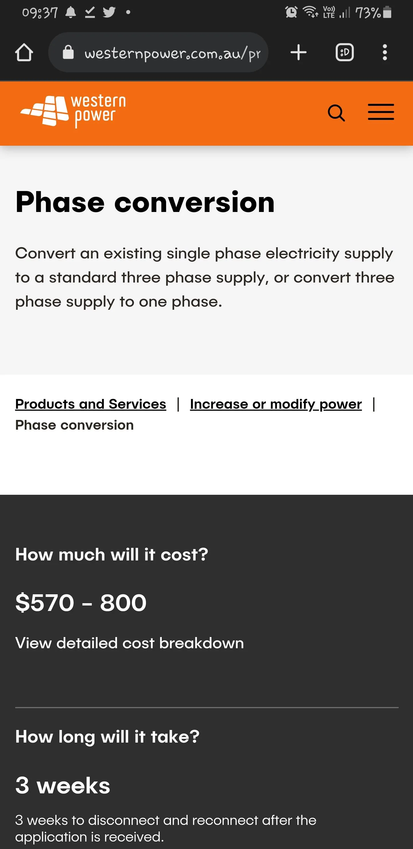

As for cost this is what our network provider offers to convert to 3 phase:
Tesla Cybertruck Winch - What is the priority? Screenshot_20220615-093751_Chrom
Most houses either have a power connection dome shared between two or more houses or an overhead 415V 3ph line. The dome is cheaper because it obviously already has the 3 phases together on the ground, whilst the overhead requires two new overheads to be connected. Note this doesn't include cable length to house connection point or a 3 phase meter if you haven't already got one. I always opt for 3 phase on install, only cost $1-2k more all up.
