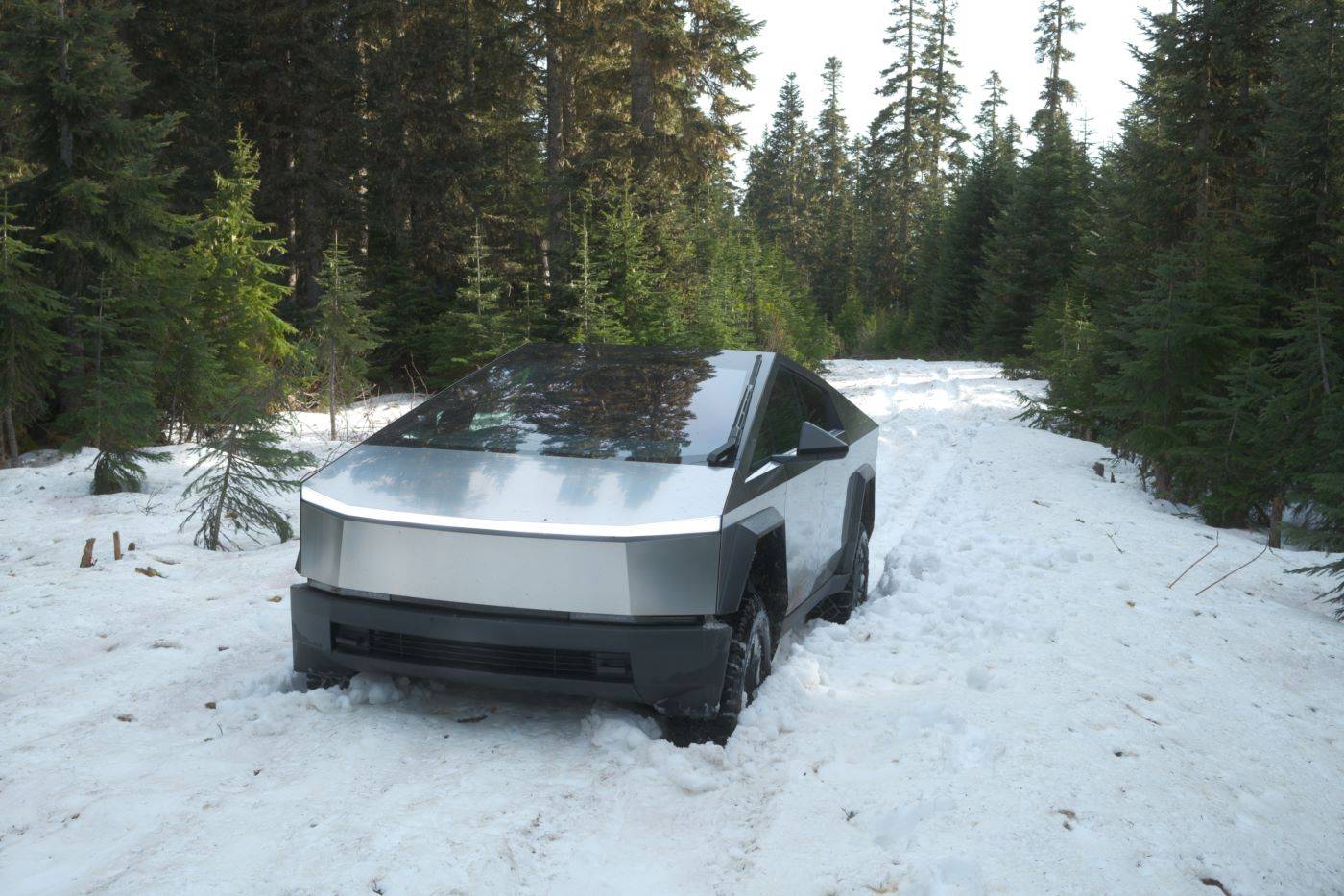

After over a year of putting the Cybertruck up to difficult challenges, I finally got the Cybertruck stuck last Thursday! I can't say I'm surprised it got stuck since I was driving through snowpack that not even very high ground clearance off-road trucks normally venture. There was 2-3 feet of melting snowpack, slushy on top, firm and slippery underneath. I'm actually surprised I haven't got it stuck sooner, considering that I have been pushing the limits of driving through increasingly more difficult snowpack over the last two springs.
It was doing admirably with both the front and rear lockers engaged and Very High ride height in Overland Mode until I found a spot where the bottom of the snowpack was not harder than the top. Basically, all four wheel fell in a hole and the vehicle was high and dry, laying on top of the snowpack on it's belly, with it's wheels spinning so freely, like a fish out of water. I wasn't even sure I was in gear until I looked in my side mirrors and could see the wheels silently turning with zero traction. I don't carry chains, but even I did, they would have done nothing. I put it into Extract Mode and could hear the suspension rising, but this just locked the front A-arms deeper into the snowpack, without actually lifting the truck up (since the tires were in holes formed by water running under the snowpack) and the truck was sitting on it's belly. All of these photos were taken in full Extract Mode and the wheels didn't even make the slightest buzzing or scratching noise as all four spun.
Fortunately, I was prepared to self-rescue with a manual ratcheting winch (AKA come-along). After inspecting the situation I determined that no reasonable amount of digging would fix the problem so I rigged up the winch to a distant tree (to get a pull as straight as possible to my existing ruts) and, after half an hour of huffing and puffing, I had winched the Cybertruck backwards 4 feet at which point the tires made contact with the snowpack and it was an easy back-down through the same tracks I had made on the way up, until I found a patch where sun exposure had thinned the snowpack down to 1 foot and I was able to turn around without worrying about getting stuck again.
The winching was more work than it needed to be because I didn't think to lower it to "High" from "Extract" in order to flatten the angle of the A-arms so they didn't anchor themselves into the firmer snowpack down below. As I winched, the a-arms had to shave the snowpack. In this particular situation I shouldn't have been in Extract Mode (for the winching).

That looks like a clean and shiny truck. You must wash it all the time.
That's pretty funny!

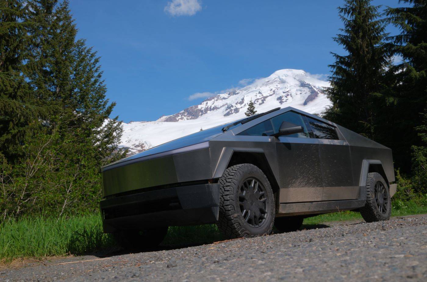

It's actually very dirty and mud spattered, it just doesn't show up very well because the metal reflects light through the dust and mud. The snow reflects a lot of light too. It hadn't been washed for two weeks (except I clean the windshield whenever it's dirty with a long-handled tool), and the bodywork had three days of off-roading on it by the time I got stuck. It does get cleaned up by the rain because I park it outside 24/7. Here's a photo taken three or four hours before I got stuck. Even here, it's a lot dirtier than it appears, the metal just wants to shine through! I love it!
Tesla Cybertruck My Cybertruck finally got stuck. Self extracted with manual ratcheting winch (AKA come-along) DSCF0891(1)adsm
Also, driving through sloppy old snowpack is one of the best ways to clean the mud on the tire sidewalls off. And I had been driving through a lot of old snowpack, even before this photo was taken.
I've been saying how easy it is to keep the Cybertruck reasonably good looking since a few months after I took delivery. I just wash it with a bucket of soap and water and a long-handled brush once a month or so. Way easier than my F-150.
