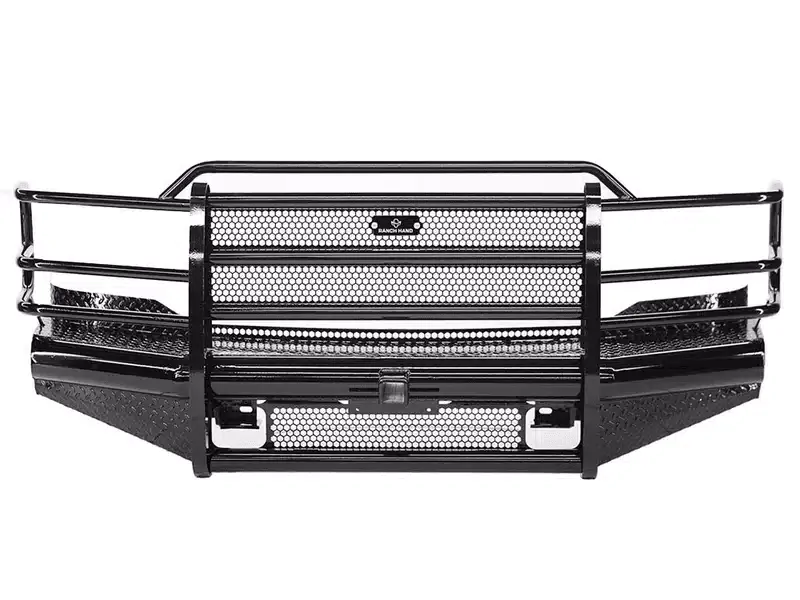

I didn't read all the comments so this may have been covered.
Most vehicles I operated in the military had either a PTO or hydraulic winch on the front bumper.
My ideal set up would be to put a Ranch Hand bumper on front with a Reese hitch receiver on it.
I had one of those installed on our new RAM 3500 (the "Diesel Pig") due to our endless supply of suicidal deer here in Alabama.
Mount the winch on a plate that will go into the receiver and pull that way. It would also go it the hitch that will be on the rear of the truck. Keep it in a protected case that could be secured in the bed when not in use. That would protect it from the elements or theft.
As far as power I would like to see Tesla put a port on both ends you could plug a set of jumper cables into that could be used to power the winch (or other high voltage draws) and to jump start stranded ICE vehicles.
IMHO you would really have to work hard to get a CT stuck but Murphy's Law knows no bounds.
