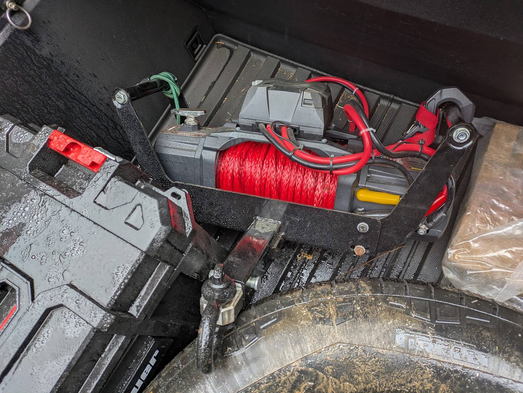

Shared this before... Regular 13k 12V winch with two Nissan Leaf lithium-ion modules as the power source. Winch is on the hitch receiver mount, but it can be rigged to the recovery hooks on the front as well using lifting straps or similar. Synthetic rope makes it relatively light to move around. Total cost of the build was about $400.

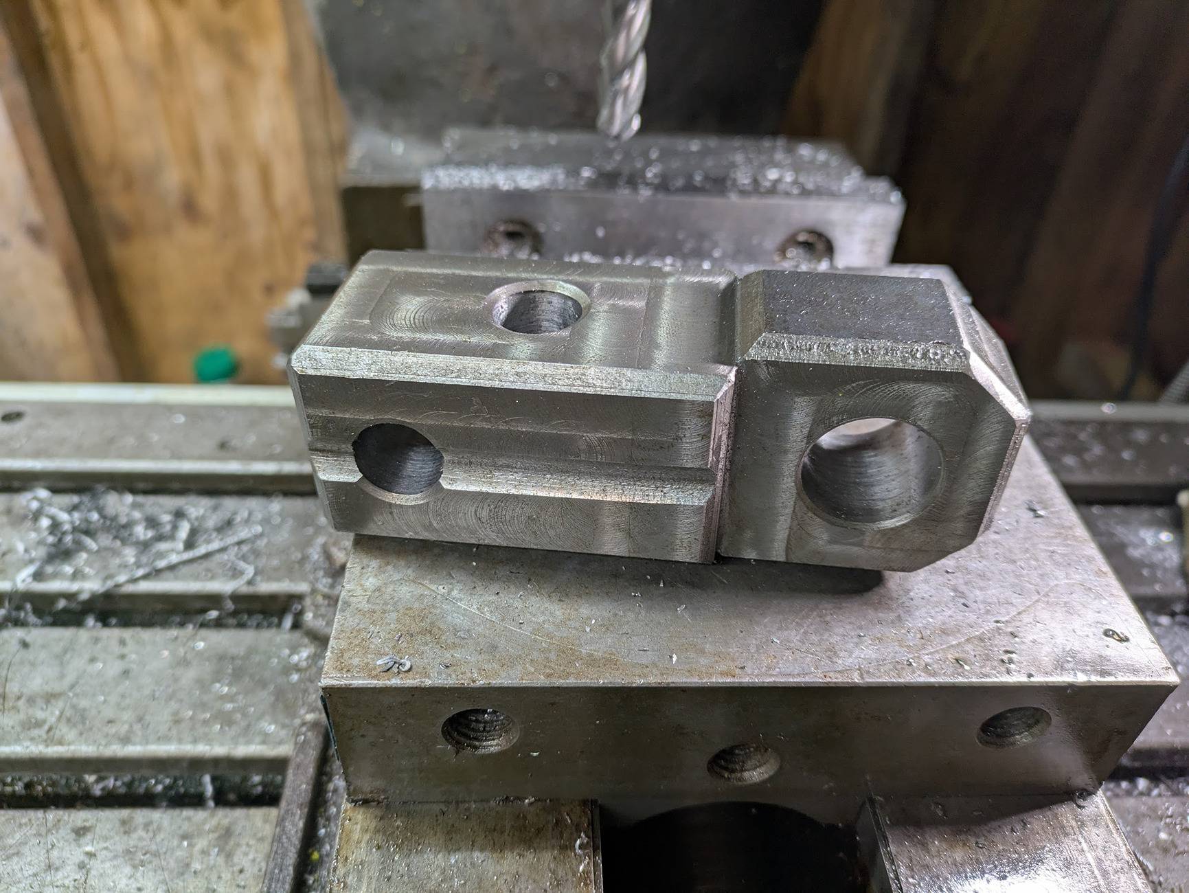

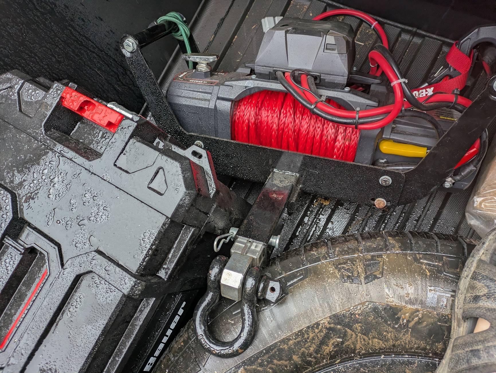

I've made this accessory for the above setup :
Tesla Cybertruck My Cybertruck finally got stuck. Self extracted with manual ratcheting winch (AKA come-along) PXL_20250621_215434806
Tesla Cybertruck My Cybertruck finally got stuck. Self extracted with manual ratcheting winch (AKA come-along) PXL_20250621_222048967.MP
Tesla Cybertruck My Cybertruck finally got stuck. Self extracted with manual ratcheting winch (AKA come-along) PXL_20250621_222127827.MP
If you don't have ability to make one from scratch, then the easy way is to buy a shackle adapter for 2" receiver, and then use the angle grinder to reduce its size until it fits into the winch cradle's 2x2 tube.
