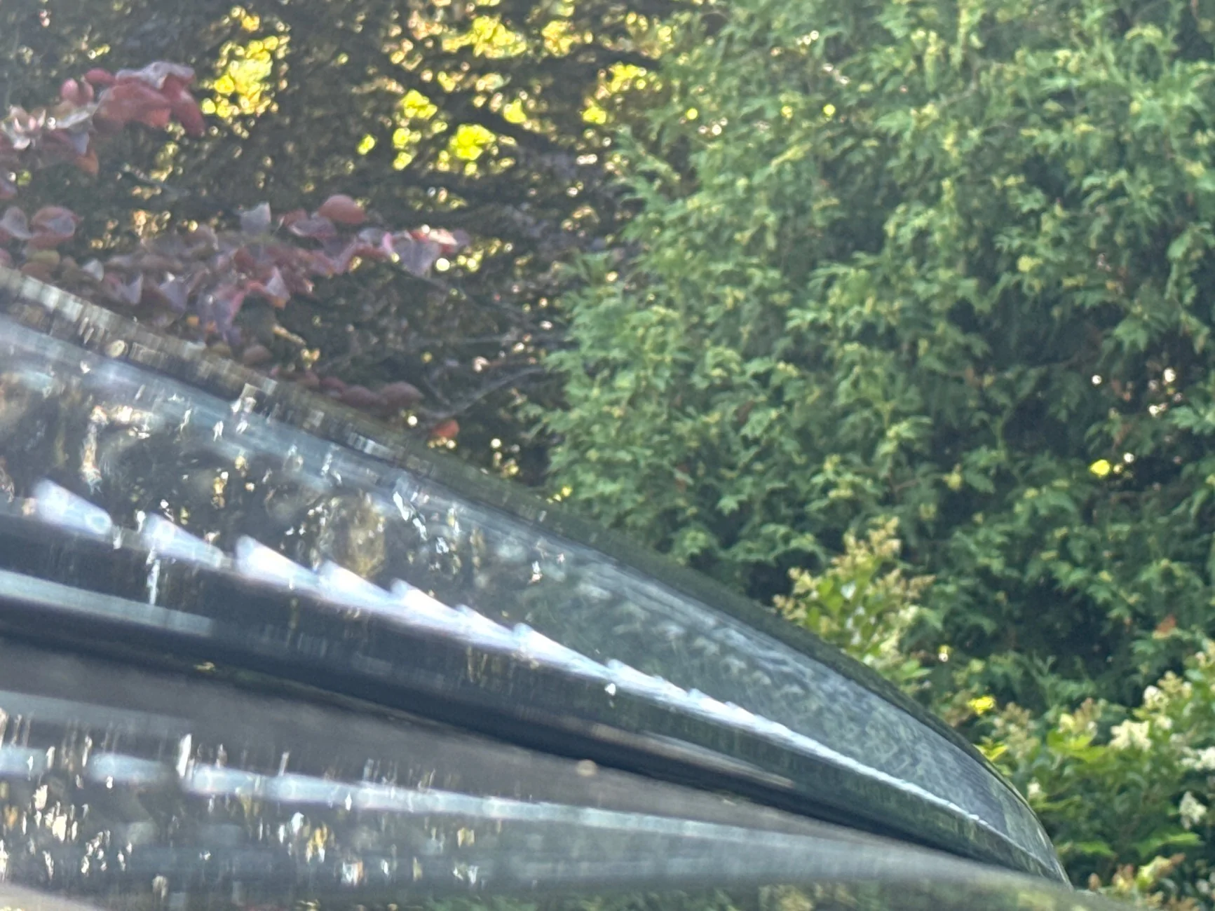

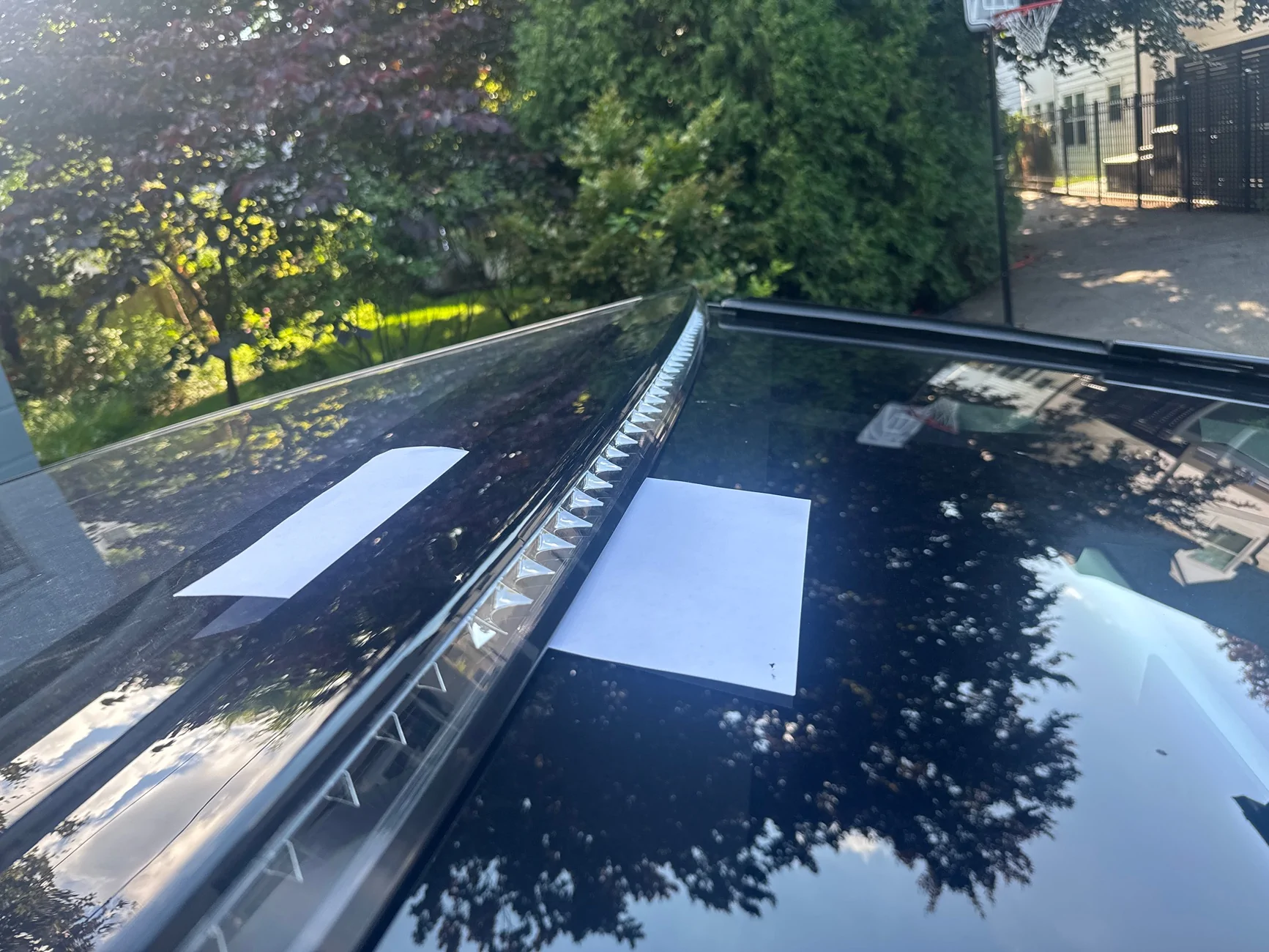

With the new install, should there be a small gap between the lightbar and the glass?
Hard to show with camera but I was able to easily slide a piece of paper under to show.
Is that paper slid under your lightbar?
If so, that‘s absolutely not correct. There is a continuous stripe of VHB across the front, and two strips with about an inch of gap along the rear.
ETA: OP, that’s where your wind noise is coming from!!
Correct, there is supposed to be one continuous strip across the front and the back one should have a small gap where vent is on the bar (in the middle)

Thanks for the feedback. I’ve contacted service and will take it back to get it checked.
