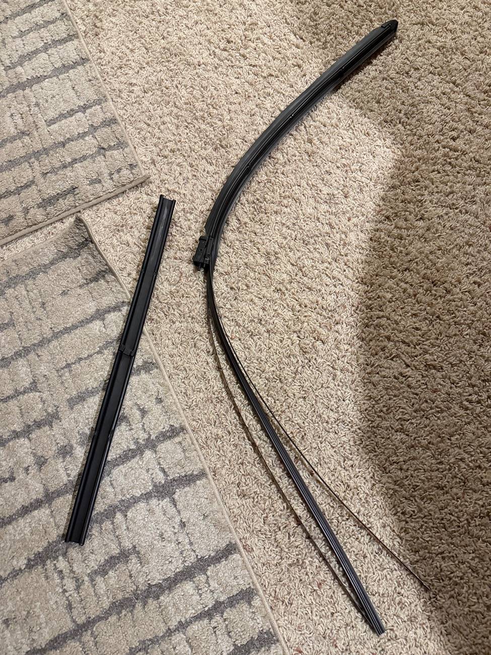

We were in Tahoe today and there was a moderate snow storm. We left the ski station having removed most of the snow on the car, after 5 minutes driving with the wiper on, it just blew up in pieces that flew off (we were driving at 20MPH) and fell on the road.
We got them back but it was impossible to reassemble it. We finished driving with the heat set to max and thankfully I put some RainX on the windscreen so the snow was melting and falling off easily. I also used what was left of the wiper metal which gave me a very small visibility (see picture)

I bet the wiper fluid froze inside the blade making it brittle.. Maybe get the highest rated fluid for cold???

When Tesla shop started carrying the wiper blade in stock, I ordered one to stow under the back seat. In case of on the road failure. You can't just stop at a random O'Reilley's to get a blade for the CT yet. Sorry that happened, worst type of weather to lose a blade.
Interesting, I didn’t know the CT held fluid in the blade.
The washer nozzles are integrated into the blade, so the blade itself is a channel for the liquid. It’s not really “stored” but there will always be some residual.
I’m guessing the blade fractured at the “max q” stress point due to the plastic becoming brittle at low temperatures.

I cleaned the snow entirely on the front but then it kept accumulating as the wipers would push the snow downward.
For the fluid you could well be right, I used 50% windex and 50% water. Probably not so smart.

I would raise this concern with your service center and request they replace it under warranty. The BAW shouldn't fail like this; I assume yours had some sort of manufacturing defect.
