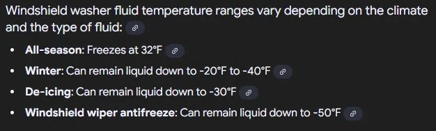

The three all season fluids I just searched on are all good to at least -20 F.
Thank you for the correction. I looked up a few just now and it varied but you are certainly right that 32F was not accurate at all. I updated my post.
