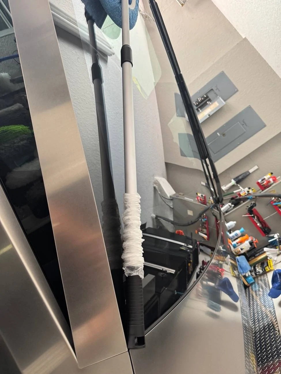

I believe it’s a continuing issue on most of them. I carry a long handled cleaner with microfiber and clean it well before a road trip. At times if it is not raining,I make a pit stop and clean.

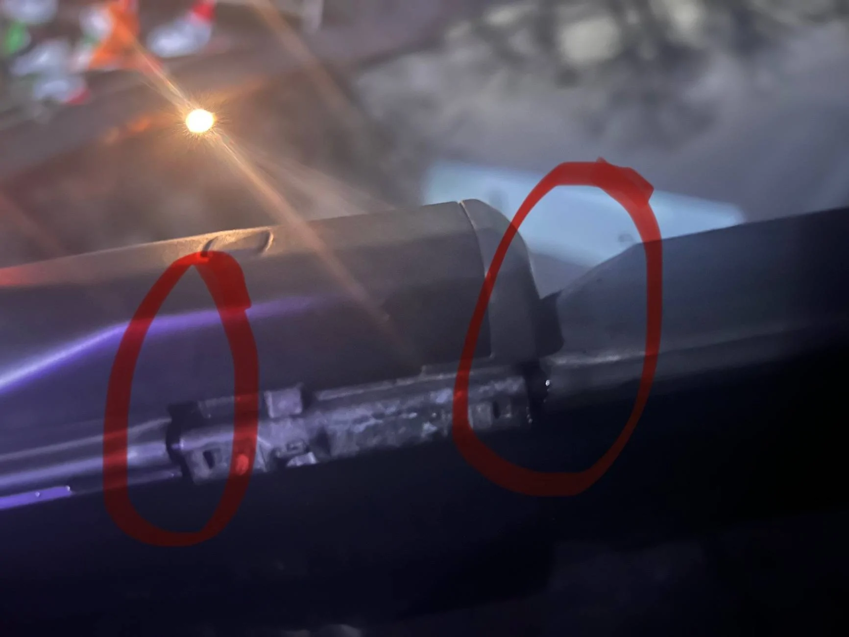

The “hoses “ were disconnected. I pushed them back together and all good.
Right, the washer hose connection to the blade is a a friction fit. I recently replaced the blade and needed to work this fitting.
A loose or kinked hose could certainly cause a loss of washer flow.

Water issue is probably due to the hoses being loose at the blade. Push them together and see if that fixes the issue.

Something to check if you've replaced your wiper blade is if the hose got kinked afterwards. I replace mine the other day. When pressing the tab and pulling the blade out, it pulls the tube along with it. The tube is held in the wiper arm with some clips. This had pulled all of the slack out of the tube and the clips held it like that. When I attached the new wiper and pushed it back in, the tube was now too long and folded back on itself. To fix it, I needed to reach under the arm and gently pull the tube back through the clips to remove the extra length at the wiper connection.
