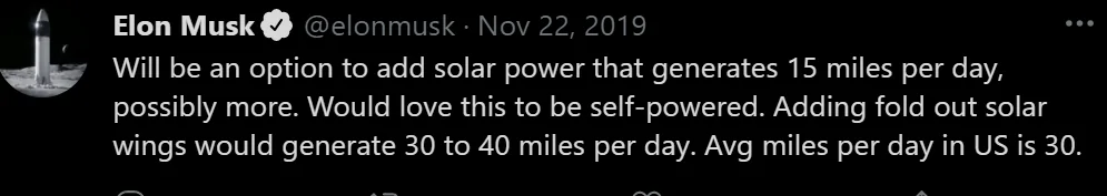

Actually I think he understands them better than you do. As I write this I have an overcast but the sky is bright. My system is producing about 4 kW. At this time of day without cloud it would be producing 22. Thus this relatively light overcast has blocked almost 5/6 of the energy available from the sun.
No, they don't have to be angles perfectly to produce energy but they do to produce full energy. Were the panels oriented such that the elevation was perfect but the azimuth off by 45 ° you would lose 30% and it really falls off fast after that. At 53 ° pointing error you lose another 10%. If one is so marginal even under optimum conditions you can ill afford to lose another 40% and this is why prudent men, such as Musk and FullyGrounded think this is foolish from an engineering point of view. But from a marketing point of view the story is quite different. Years ago the megabrewers discovered that the public was willing to pay a premium price for a beer that was cheaper to make because it required less of the things that make beer beer. If people are willing to pay more for less or something for nothing I want to invest in companies that are willing to sell that. Thus I think Tesla's decision to lock in the rights to sell these virtually useless (from the solar perspective only) tonneau and perhaps even sell them a brilliant business decision.
Why would Elon promissed 15 miles gain if he knows it is not enough even to supply phantom draining?

He clearly said:
Tim.Luchenko

My speculation is:
he knows about phantom drain, and when he said "solar power that generates 15 miles per day" it is additional to phantom drain. Ofcource, if you can use this power as you want, running A/C, or grilling staeks, or Light the Night Up. I think if you do not have any comsumption of power (exept CT does it by itself and you cannot do anything with it) it will gain power for 15-30 AVG miles per say in US.

He clearly said:
Elon Musk
@elonmusk
Nov 22, 2019
Will be an option to add solar power that generates 15 miles per day, possibly more. Would love this to be self-powered. Adding fold out solar wings would generate 30 to 40 miles per day. Avg miles per day in US is 30.
Exactly right.
Elon did not just say 15 mi/day. He said possibly more than 15 miles.
Elon is a real engineer, Tesla makes & sells home solar panels and his SpaceX company has plenty of experience with the highest efficiency solar panels in the world.
Elon knows what's possible.
The issue is not efficiency. It is cost. This is just like Tesla battery day presentation. There is no need to wait for solid-state battery or other chemistry breakthroughs. The efficiency of current lithium ion is good enough. The issue is cost per KwH. Most of battery day was how Tesla was going to reduce battery cost with current chemistry.
Efficiency of current solar panels (20-22%) is good enough to use on a mass scale now.
It is the cost/Kw that matters most right now.
If retail prices are $0.55/watt I am sure at Tesla volume & scale it would be lower.
Now need to wait for some future perfect solution.
