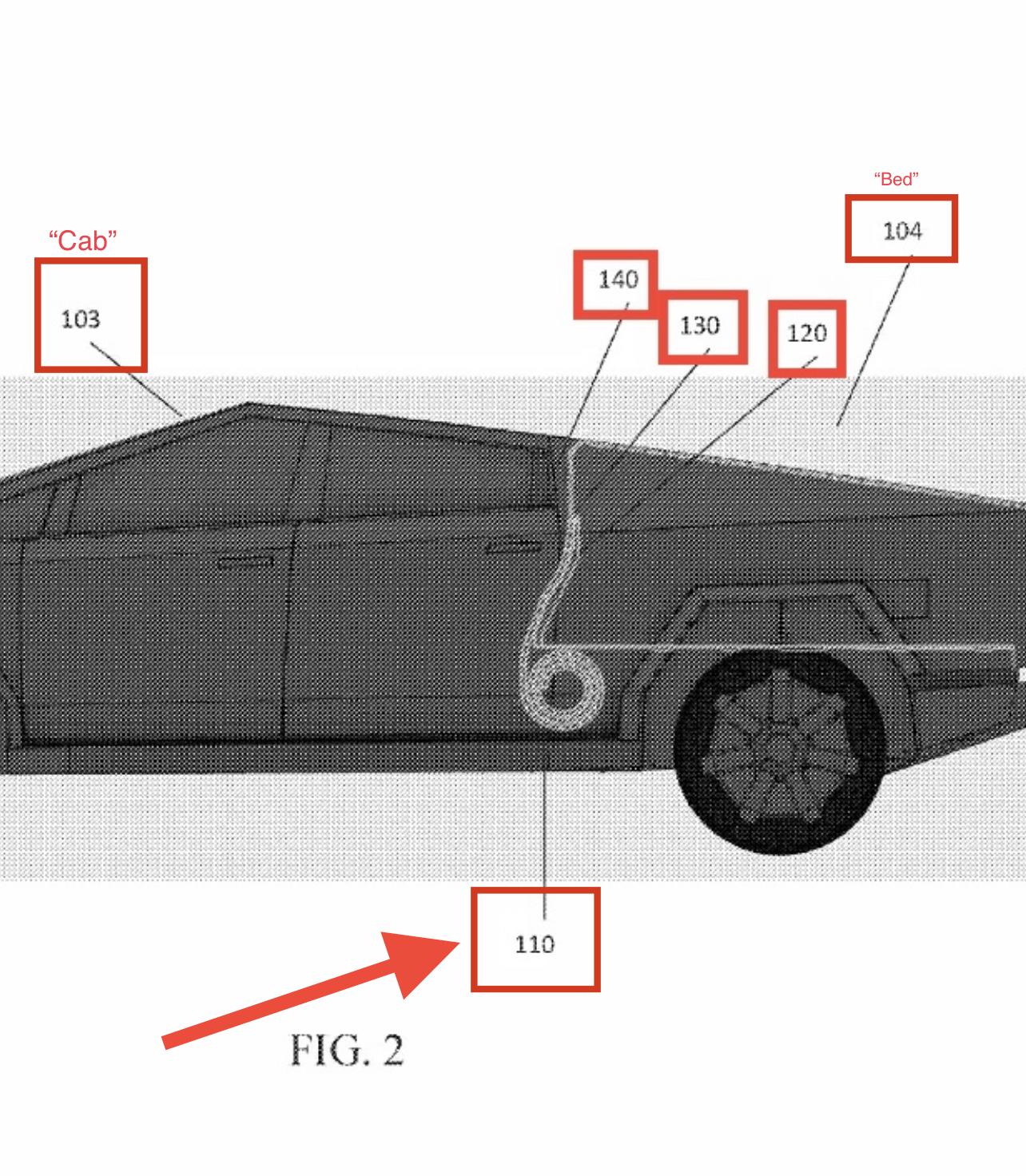

Step One: “When in a retracted or stored position, the tonneau cover 110 is rolled and stored below the junction of the cab 103 and bed 104 as will be described in more detail below.”
This is basically an introduction to the design within the patent, to be elaborated on later in the patent. But the signal is already coming clear when the text states the tonneau is stored below the junction of the cab and the bed.
One might wonder where, exactly, is “below” the “junction” of the “cab” and the “bed.” At least in this introductory paragraph, it’s not yet clear. And neither Fig. 1A or 1B to which this references even shows the tonneau, as it’s instead or orienting graphic.
But Tesla has better patent attorneys than that. So they go on:
“Now turning to Figure 2, as shown, the tonneau cover 110 in a retracted or stored position forms a coil at a location behind the passenger compartment of the cab 103.”
So, the tonneau cover is shown “coiled” as “behind” the passenger conpartmentportion of Fig. 2 item 110 - shown here (red arrow)
Tesla Cybertruck Midgate a No-Go (Assuming Tonneau Patent)? 0809968C-2B62-47F8-B605-27BF39E16423
“Gotcha!” they think, “see it says the tonneau is coiled below the bed!”
Yes, seems about 2/3 of it sure is! But the patent goes on!
“The tonneau cover 110 slides down below the level of a rear cab window 140 at the end of the bed 104 so that a driver can see out the rear cab window 140 when the tonneau cover 110 is in the retracted or stored position.”
So the cover (110 as above) slides down “below the level of a rear cab window” (140). Strange here that it doesn’t say the the cover slides down “behind the passenger compartment of the cab,” which is where the patent has previously defined the “coil” to be located. Stranger still that it says the cover is in this position below the window when the cover is in the “retracted and stored position,” when that same positional description of “retraced and stored position” previously described the coiled portion. All strange, unless the cover when in the “retracted and stored position” is both in a coil “behind the passenger compartment of the cab” and “below the level of the rear window.”
Helpfully, in the patent twice now describing the cover as being in the “retracted and stored position” it has referred to Figure 2 above, which shows the cover being partially in said coil and partially under said window.
If intending to describe a functionality that instead fully coils the cover “behind the passenger compartment of the cab” when in the “retracted and stored position,” one would expect an additional diagram of the cover fully-fully retracted-retracted (more fully retracted?) and completely stored in a coil “behind the passenger compartment of the cab.”
But there’s no such figure. All such references (quoted above and elsewhere in the parent) to the cover’s “fully retracted and stored position” refer only to this Fig. 2, showing the cover being both coiled behind the passenger cabin and below the rear window.

My best read of this patent, therefore, is that Figure 2 accurately describes the patent’s position of the stored tonneau as including not just the rolled portion “under” the bed/passenger, but also this upper length of tonneau being stored up along and into the bulkhead “behind” the passenger, terminating just below the rear window.
But to interpret the patent on these points requires squaring the interpretation with the remaining portions of the patent’s descriptions. While other bits are available in this line of inquiry through the rest of the parent, one key portion jumps out as (1) consistent with my reading above, and (2) inconsistent with an alternative reading (if one felt they still needed it) that has the entire cover coiled when “fully retracted and stored”
“The opening [for the tonneau channel] 130 is partially formed from a rear wall 120 of the cab 103. The rear wall 120 is used to protect the tonneau cover 110 in its retracted position from being hit and damaged by an object disposed in the bed 104. For example, when the vehicle 100 is being driven, the objects stored in the bed 104 may shift within the bed 104. The rear wall 120 prevents these objects from striking and possibly damaging the retracted tonneau cover.
Referencing Figure 2 again, the “rear wall 120” is [expectedly] the bed bulkhead just below the window and above the bed floor. Shifting cargo in the bed would not “strik[e] and possibly damag[e]” a tonneau retracted completely below the level of the bed floor.
Not to be redundant but instead feeling a need to be: the bulkhead is described as protecting the tonneau from shifting cargo damage when in its retracted position. If the cover was instead underneath the bed when retracted, no damage would come to the cover from cargo shifting whatsoever, much less would that damage occur at the location of the bulkhead.

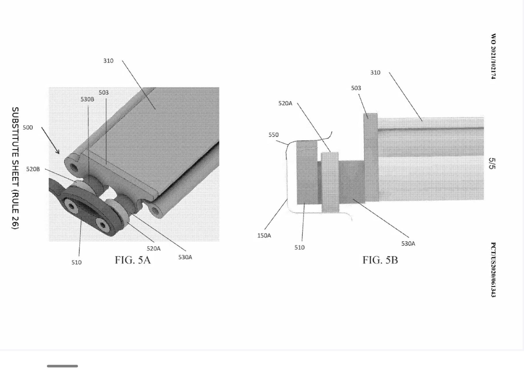

For contrast, when the patent elsewhere describes the cover in the “closed position” and references the figures, it is in fact shown as “closed” as we’d expect, not 2/3 open leaving the patent unclear as to what “closed” means - just as it doesn’t leave unclear what “fully retracted and stored position” means.
One last key interpretive point that brings together the patents definitional description of the tonneau’s configuration when “fully closed and stored”: the phrasing of “behind” the passenger compartment is completely consistent with and accurate of this configuration described in Fig. 2: both the “coil” and the remainder ~1/3 of the tonneau “below” the rear window, are all “behind” the passenger compartment.
Which, by way only of summary of the patent and not it’s complete recounting of all , is why my OP stated:
