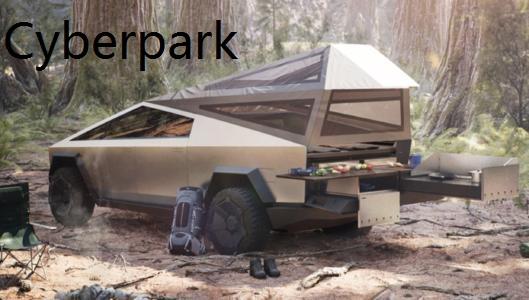

I agree with you but it appears the tent is not sealed.
Someone else mentioned this in a different thread but I could see Tesla putting vents instead of a midgate.
