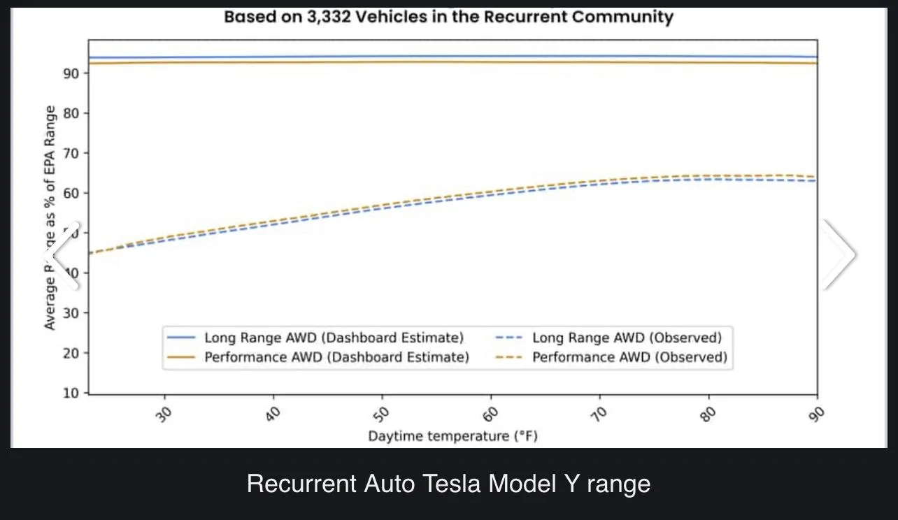

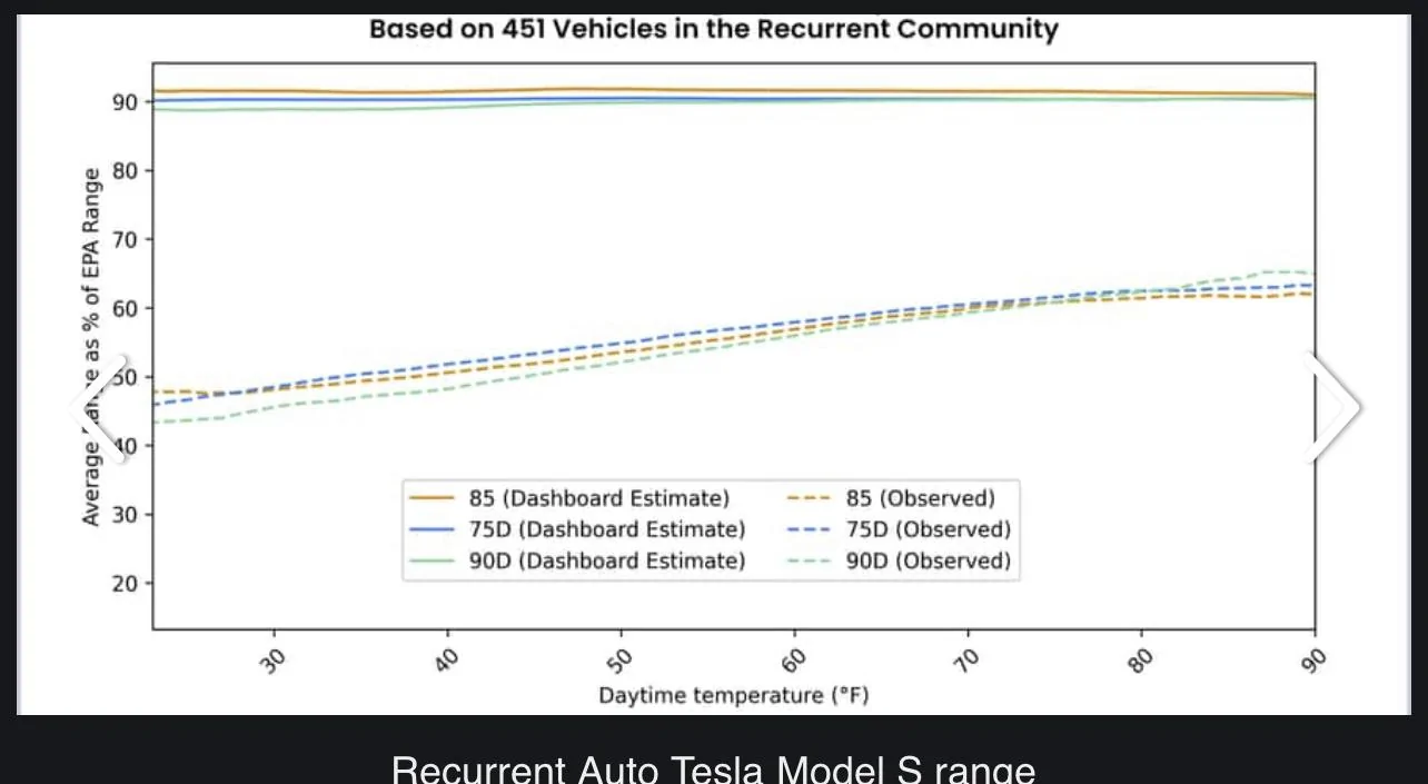

The fact that most consumers rarely get the rated range on a Tesla by a substantial margin indicates that Tesla is pushing the envelope in some way that does not look good for EVs. Elon always said a good product sells itself, so why are they selling by overstating range?
*this* meanwhile, is absolutely a Tesla-specific issue
more than any other BEV OEM, they push their headline range numbers apparently to draw people in and give them a somewhat conflated relaxation of their “range anxiety” - best as could be said of this strategy is that Tesla is doing it to accelerate BEV adoption. But as you say, I suspect it could do as much harm as good.
meanwhile, other OEMs basically take the opposite approach of getting conservative headline range numbers, under apparently the opposite strategy of feeling that range anxiety will be best addressed by at least living up to headline numbers, even if those headline numbers aren’t the most optimistic
at which point in this brand of conversation, someone flies in to provide some anecdotal exception. But exceptions in this case prove the rule.
because the data is vast and clear that Tesla’s headline range numbers materially overestimate real world conditions in a way that is distinct/worse than other OEMs
Ao this isn’t a point about how “all EPA estimates are faulty for everyone”, it’s about how they’re more faulty for some than others
This is a well known and huge problem. There is a good explanation in the linked article about why Tesla gets so much better EPA ranges and why it is all perfectly legal under the regulations (which the EPA should fix immediately). To compare most Tesla vehicles it is best to look at the WLTP number versus a competing vehicle (n/a for the Cybertruck unfortunately) which uses consistent methodologies across vehicles unlike EPA.
