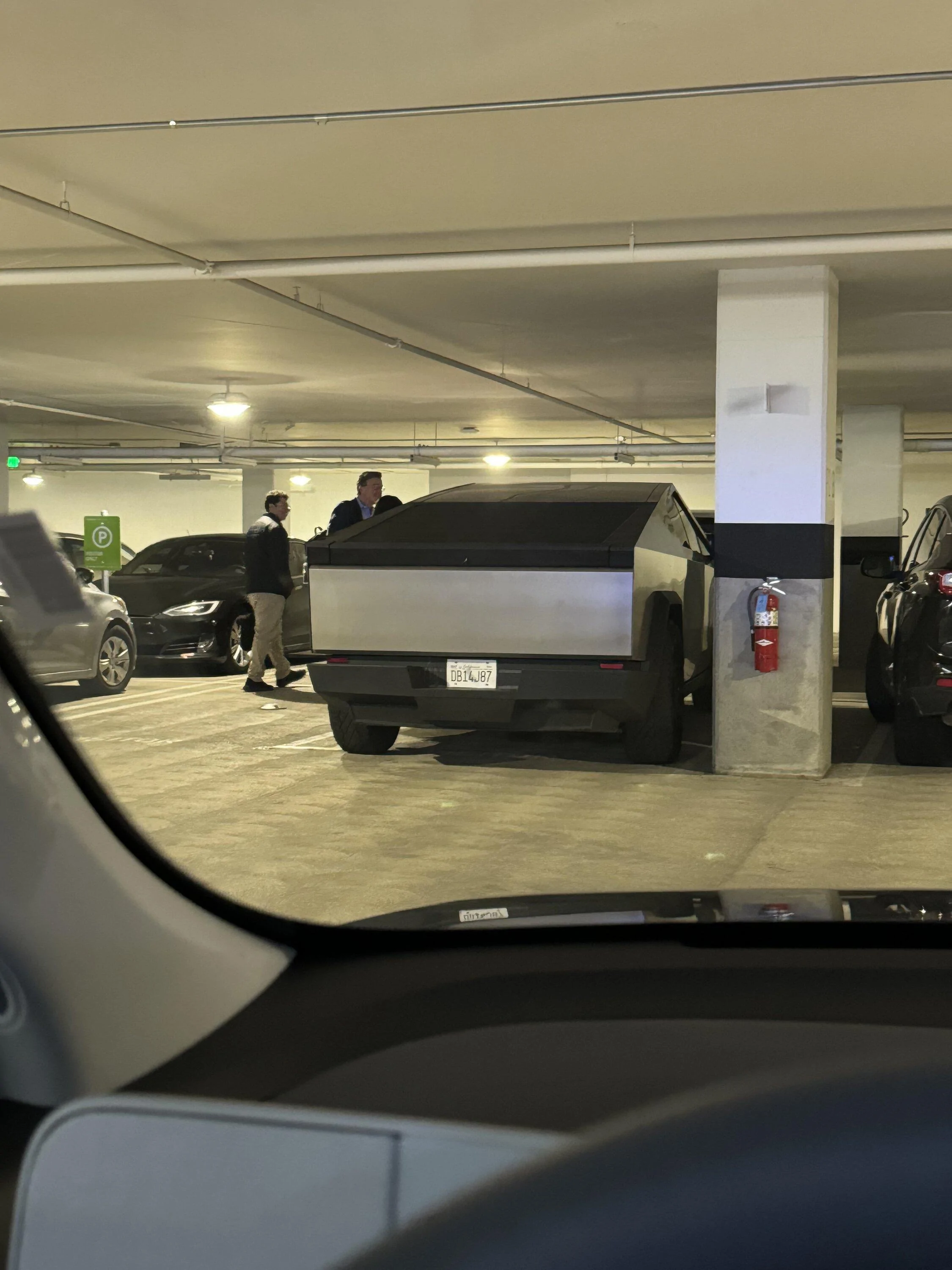

Co worker got his and it barely fits in the parking garage.
