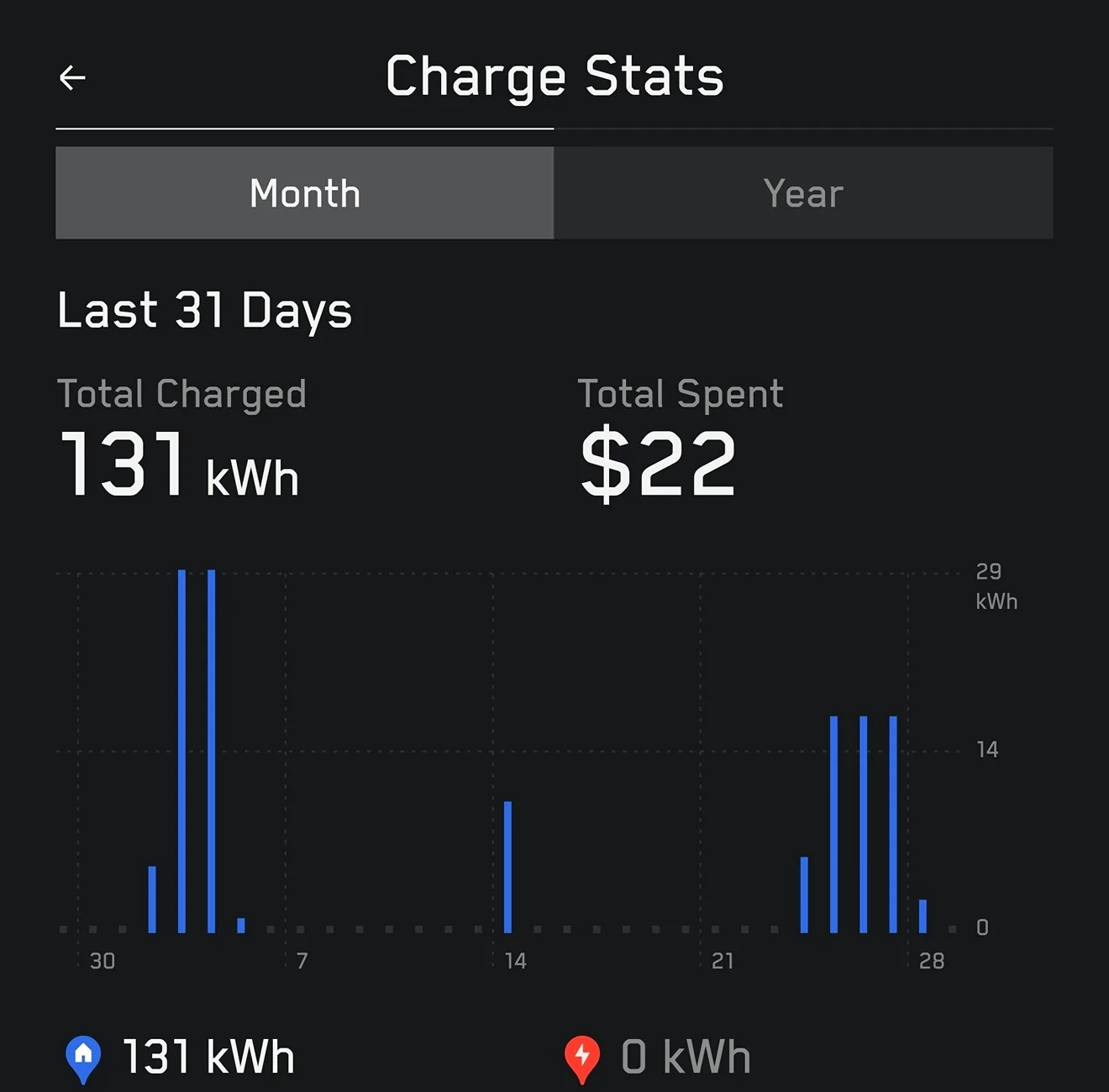

131 kwh used in two months. Truck hasn't moved!

Something is keeping your vehicle on, and that isn't normal. It should not drain as much as it did.
It looks like it is charging 24 hours a day (exact same kWh multiple days in a row) which could be the case if the mobile connector dropped to a low current limit.

2024 cybertruck
It's set to 6 amps. That's why it's the same.
6A @ 120V will take a long time (if ever) with terrible efficiency .
For kicks, I just charged my truck at 6A@240V, in 75F temps for 5 hours.
Gained 3.93kWh. (Around 3%)
Wall energy was 7.39kWh.
Loss was 3.46kWh, or around 693W. Efficiency of 54%.
6A@120 = 720 from wall
-693 = 27W net charge rate.
Here's my truck's charging behavior at 48A@240V.
Only drove 3 days.

This is ridiculous, we've been out of state for two months now. I noticed the charge dropped substantially and didn't want to come back to a dead battery so I had one of my adult children plugged it in. No climate control and no sentry mode. What the heck is going on? $22.00 of electricity just sitting?
Is it parked, by any chance, in a hot garage? It definitely has to work harder protecting the battery if it is soaking in heat.

I was loosing 10% in 24hrs. The coolant pump was running 24/7. It is very quite pump you can hear running best near the front right tire. The phone app never showed "Asleep for ...." It took 2 appointments of about a week each to get the problem fixed. Last visit, the service center replaced FUSED - CAR COMPUTER(1780685-S0-G). Now the coolant pump shuts off and the phone app shows it is asleep. I was also having a problem where most of my speakers would stop working after sitting parked for a few hours. An MV reset would get them all working again temporarily. But as an added bonus, replacing the computer has so far resolved that audio speaker problem as well.
