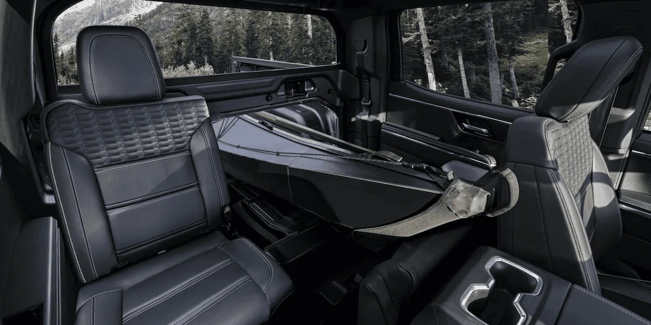

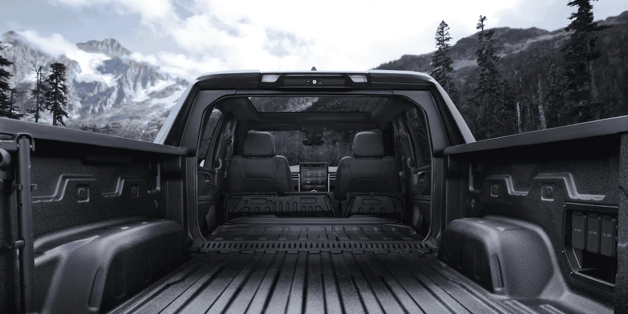

Look at this from the Denali:
Tesla Cybertruck 2 Cybertruck Exoskeleton Bodies Arrive at Giga Texas! * UPDATE * Elon Confirmed 1666326311072
You can see the folded seat, and the retracted glass to make it fit behind the front seats when it is down.
This version might work, but only with the vault cover down. (note the midgate height and folded seat)
Tesla Cybertruck 2 Cybertruck Exoskeleton Bodies Arrive at Giga Texas! * UPDATE * Elon Confirmed 1666326517410

The assumption we talked about before was that hollow structure was attached to the back of the seats and goes down with them.
The Denali is what inspired all my shared thoughts.
