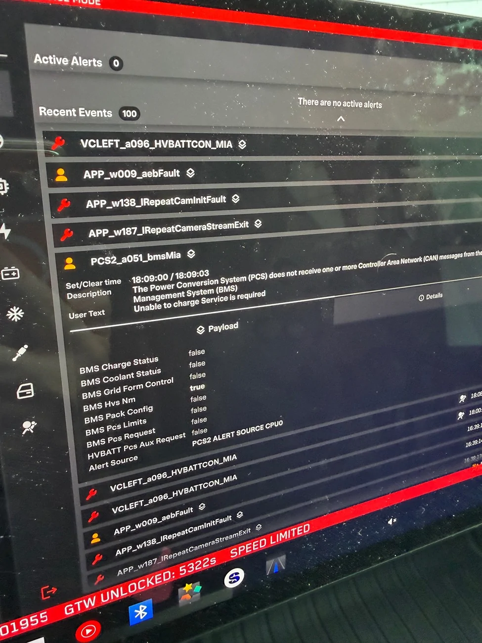

I think it got me finally. 3 times the left camera went black and FSD shutting down. This time there's a PCS code. I made the service appointment for Thursday so I will see what they say. I haven't tried to charge yet.
That code means the PCS couldn't talk to the battery management system . The left controller also had comm issues to the battery.
None of the DCAC codes, more likely a battery, DCA, or harness issue.

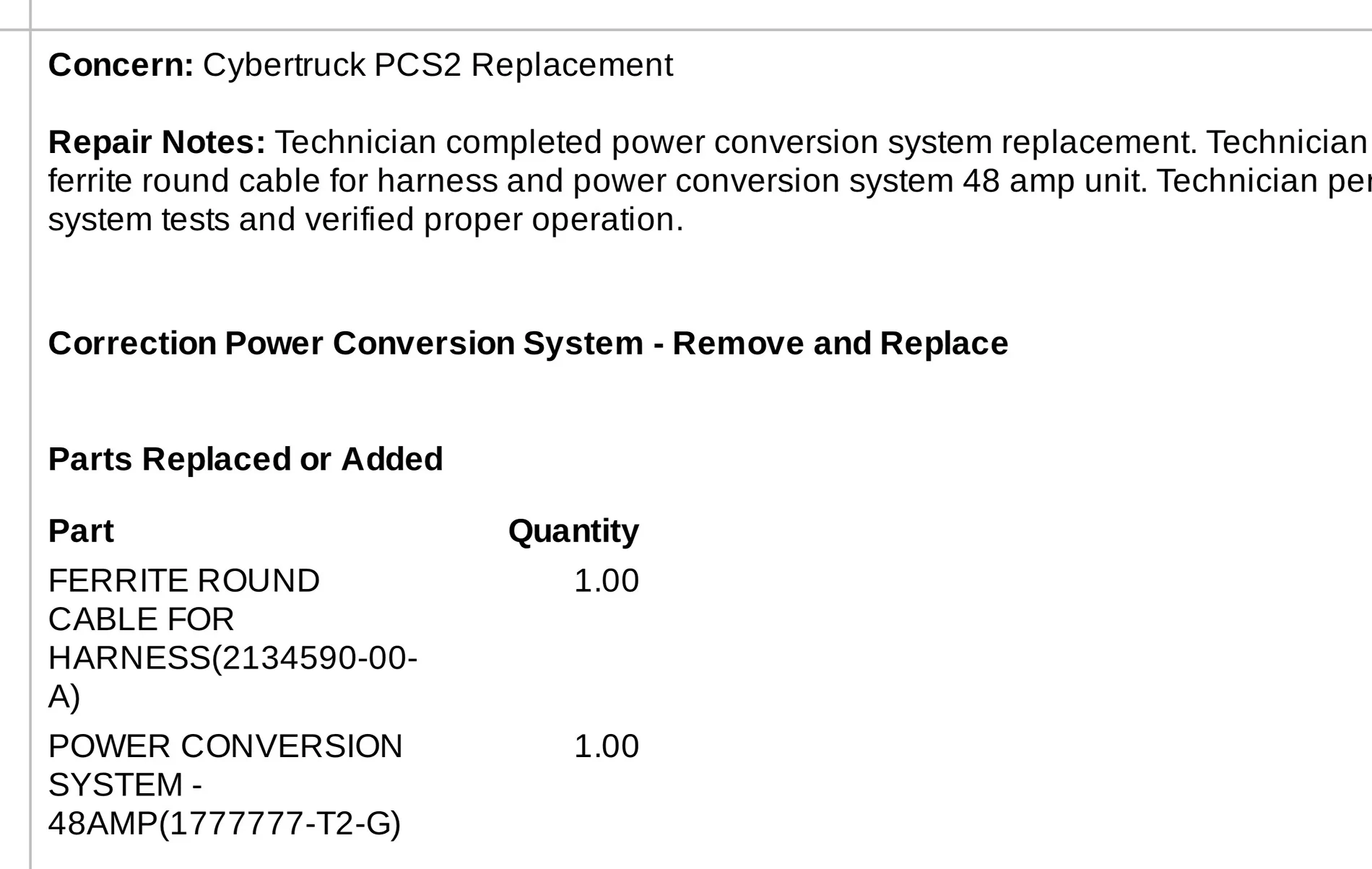

Sadly I joined the fraternity of brothers with PCS failures yesterday.
Went on a 300ish mile long trip (150 each way) and charged for 5-10 minutes at the halfway point just to be safe. I got home with 8% remaining, and plugged in to my Tesla wall charger. That's when I noticed it was only charging at 24A. Tried our other Tesla wall charger we have and it too was 24A. Filed a ticket with Service and they verified it was a failure, said no parts are currently available, and gave free supercharging. They also didn't have an ETA on the part...
Just for statistics sake, it's a very early 2024 Foundation Series (under 2,000 VIN) AWD with a little less than 20k miles.
ok yeah truck still charges waiting on tesla service to open tomorrow
