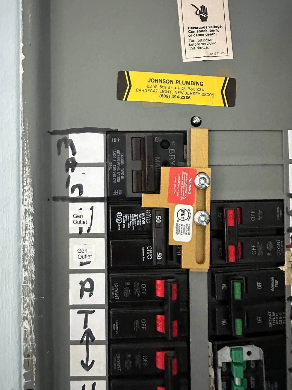

Protection should trip before anything melts. Like it was mentioned earlier in the thread, in the absence of a transfer switch to isolate from the city power one should have the interlock installed on the generator inlet breaker. Interlocks are available for a variety of panels and typically cost less than $20, and can even be 3D printed. If an electrician installed the generator inlet for the entire house, they would have added the interlock. If the person has done it themselves, then they should be able to add the interlock as it's not a rocket science.

need the folowing (I think)
interlock with exterior 30amp twist lock box

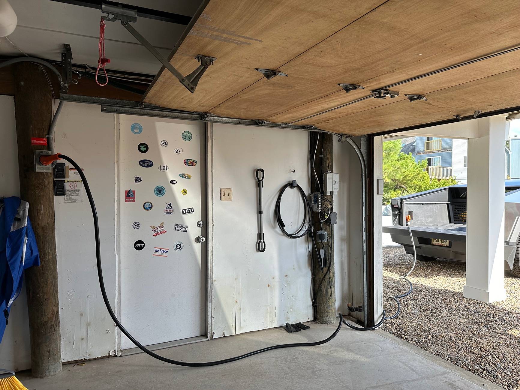

30 amp twist lock cable in the length you need to get to the exterior box

These are the 50A components I use:
https://www.amazon.com/RVMATE-Pre-Drilling-Generator-SS2-50P-Waterproof/dp/B09VBD946C/
https://www.amazon.com/Extension-SS2-50R-Twist-Locking-Female,125V-Motorhome/dp/B08GHG5P75/
And naturally a 50A breaker in the panel.
Not that exact cable, but a similar one. The plugs on them are a very tight fit because of how low the outlet is mounted in the bed. I haven't seen a cable like that with a straight plug instead of a 90, but I've seen the short adapters (though extra $$) :
https://www.amazon.com/Parkworld-Extension-14-50P-Straight-Generator/dp/B09P7XGPYV/
Edit: I guess the same company makes this cable https://www.amazon.com/Parkworld-Extension-Adapter-Straight-Generator/dp/B09Q2WHKQR/

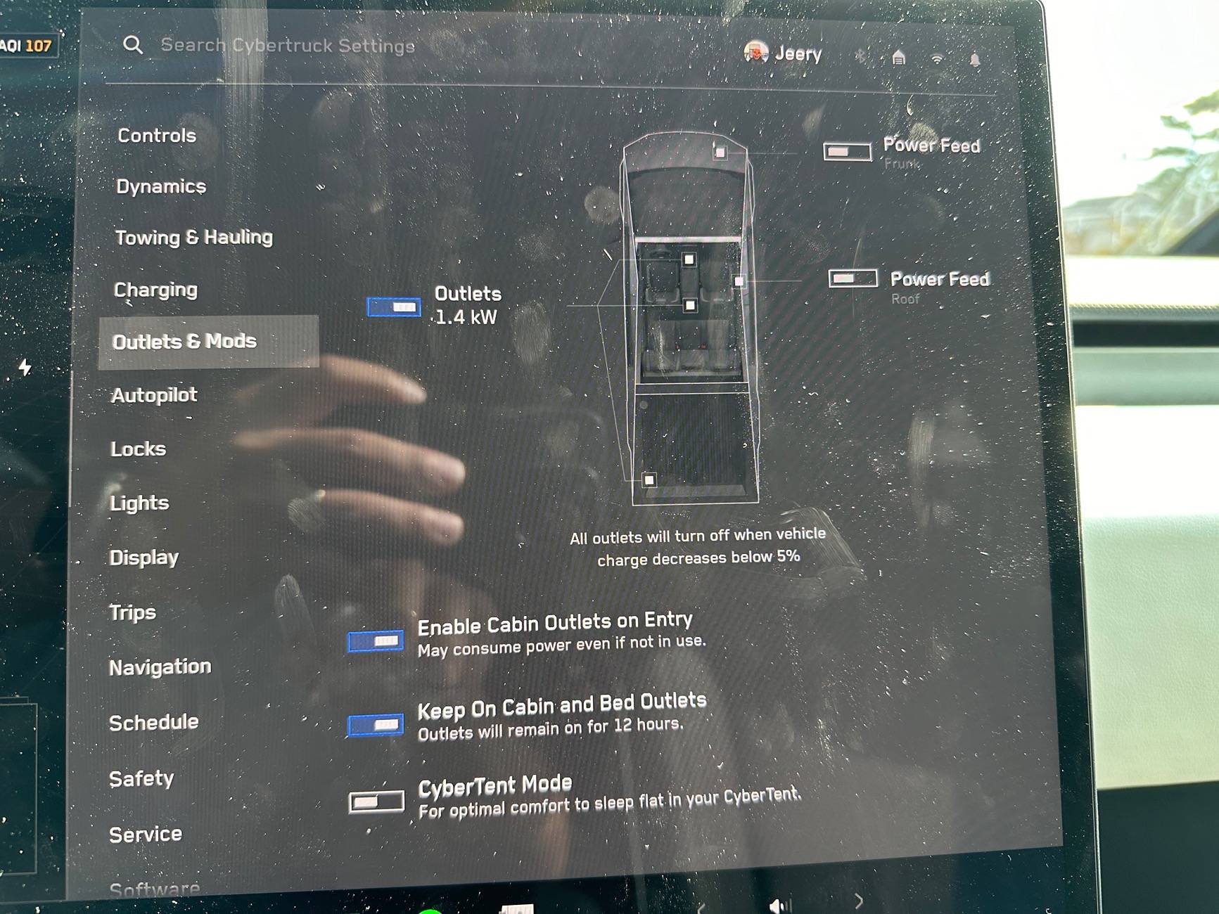

Good point, guess you could use 50amp but the CT only puts out 30 I think…7200 watts

Correction up to 40 amps so you are right might need a 50 amp inlet and breaker
