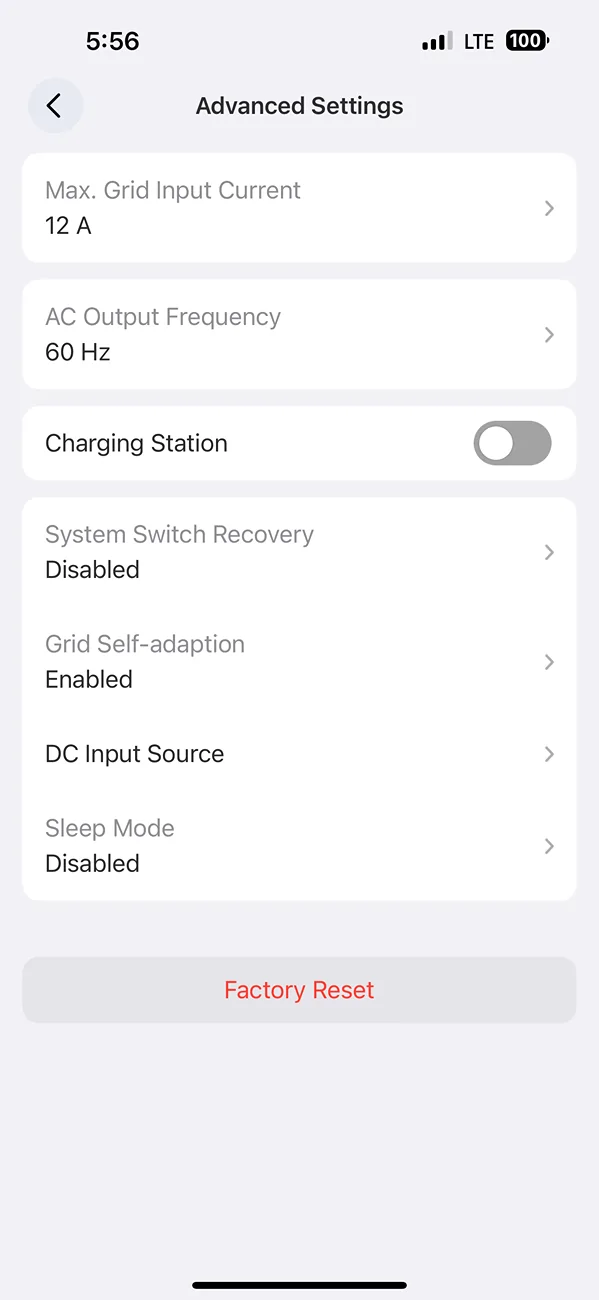

The Bluetti app does let you throttle the input amperage charge rate to as low as 1 amp.
So you can throttle the ac charging like on my ecoflows but not dc input right? If you plug anything into the solar input it will attempt to draw the maximum wattage for that mppt controller?

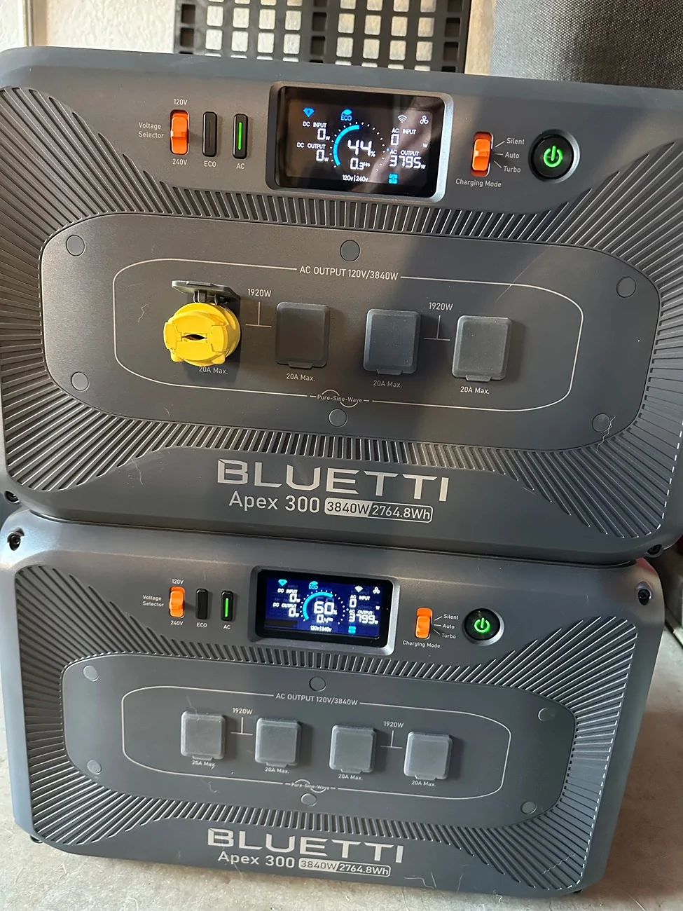

Those Bluetti Apex 300s only have about 2.7kwh per pack. So even with two packs you can only add about 15 miles of real world range (6-7 if towing). That's a hell of a lot of money for 15 miles of range. I would love to have them, but can't justify the cost.

That is very accurate in that each Apex 300 or extender B300K has 2,785 kwhours of energy. But two Apex units tied to two B300K extenders renders over 11 kwhours and it fits nicely under the tonneau. They are easily re-deployable for whole-home electricity backup or other uses. And Bluetti is always having sales that offer 50-60% off.
But very fair to note that they are expensive.
