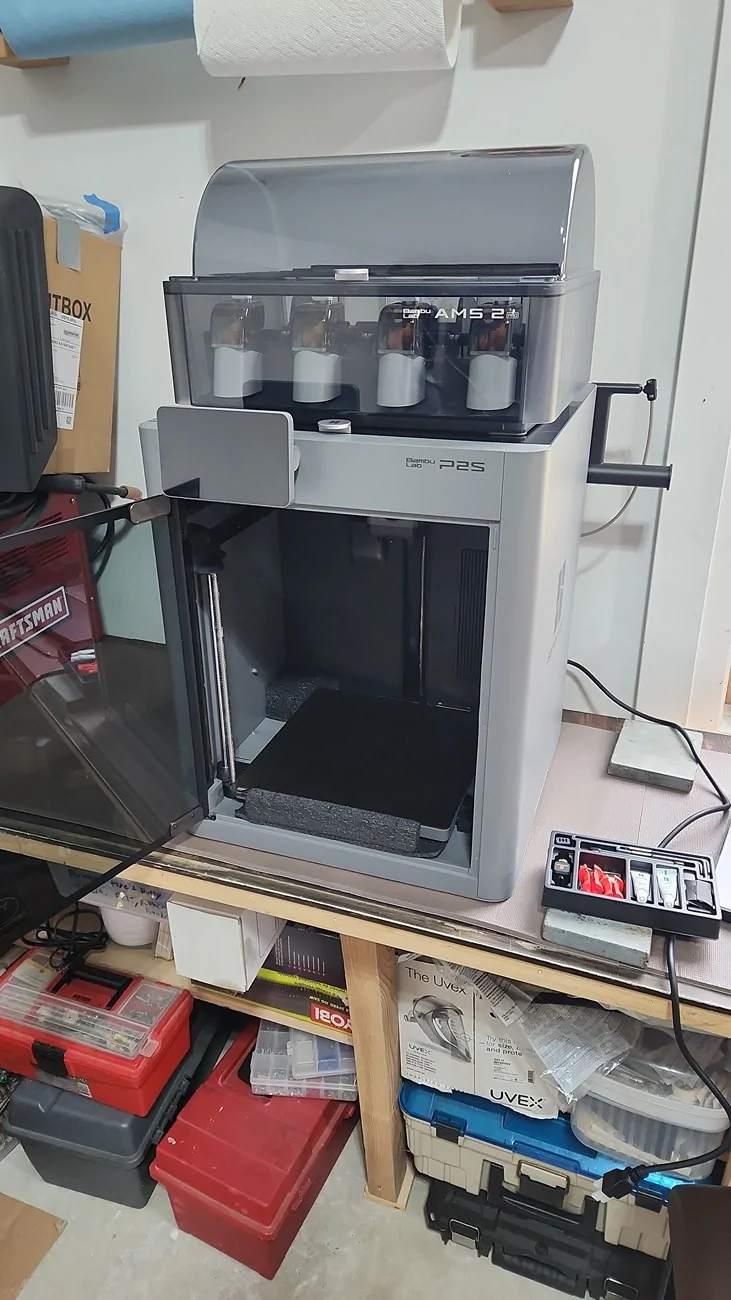

Just got my 3D printer in, did the setup and doing my first print now. I am amazed by this thing. The options are endless and it's super cool to watch once you figure out how the hell to work it.
That looks really cool. What model is that?

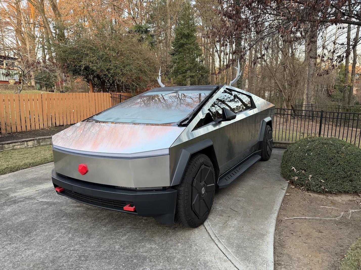

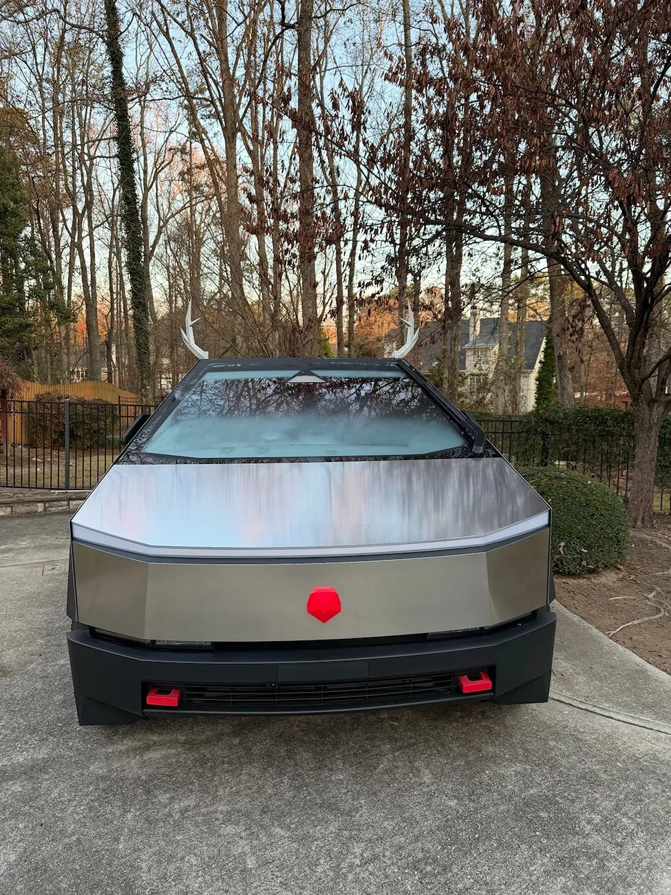

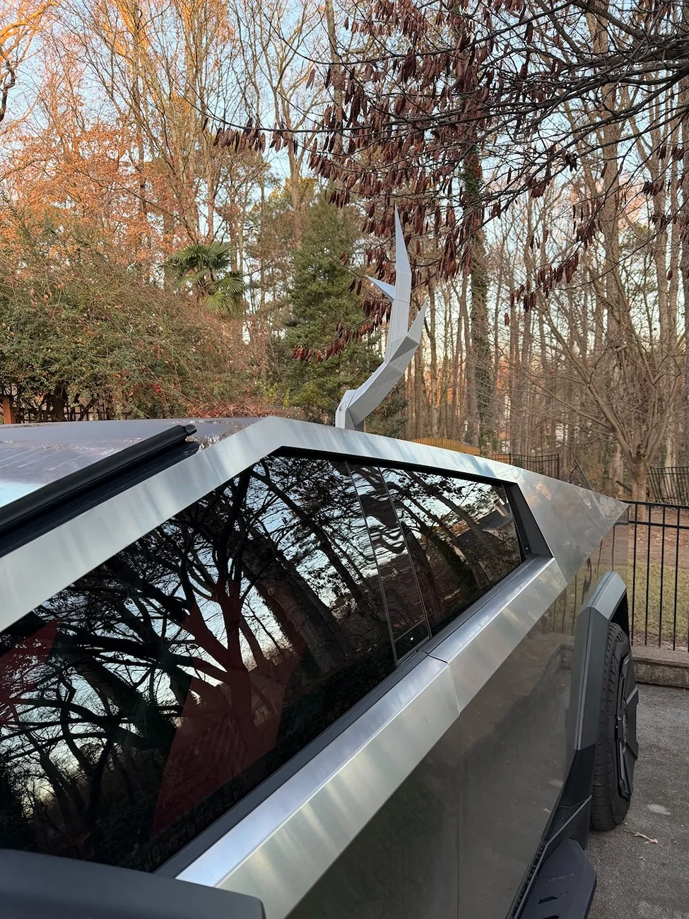

Antlers and nose installed. Absolutely love it, but I ran into one small problem - the antlers are too tall to fit into my garage! Looks like I'm parking outside for the rest of the month 🥶🎅

How does it hold up with driving at say 85 mph? Mine are printing now, and I have a 2 hour road trip coming up that I'll be doing 85 mph most of the time. Also what size it the nut for the roof rack mount?

I just put them on last night so I haven't had a chance to road test them above ~45mph yet. I used the nuts that were already on the posts, I believe they are 10mm - at least, that's the socket I used and it fit perfectly. Someone else may be able to confirm.

How did you get the nose to install, I tried under the edge of the front but it is a bit loose. Did you use double sided sticky tape?

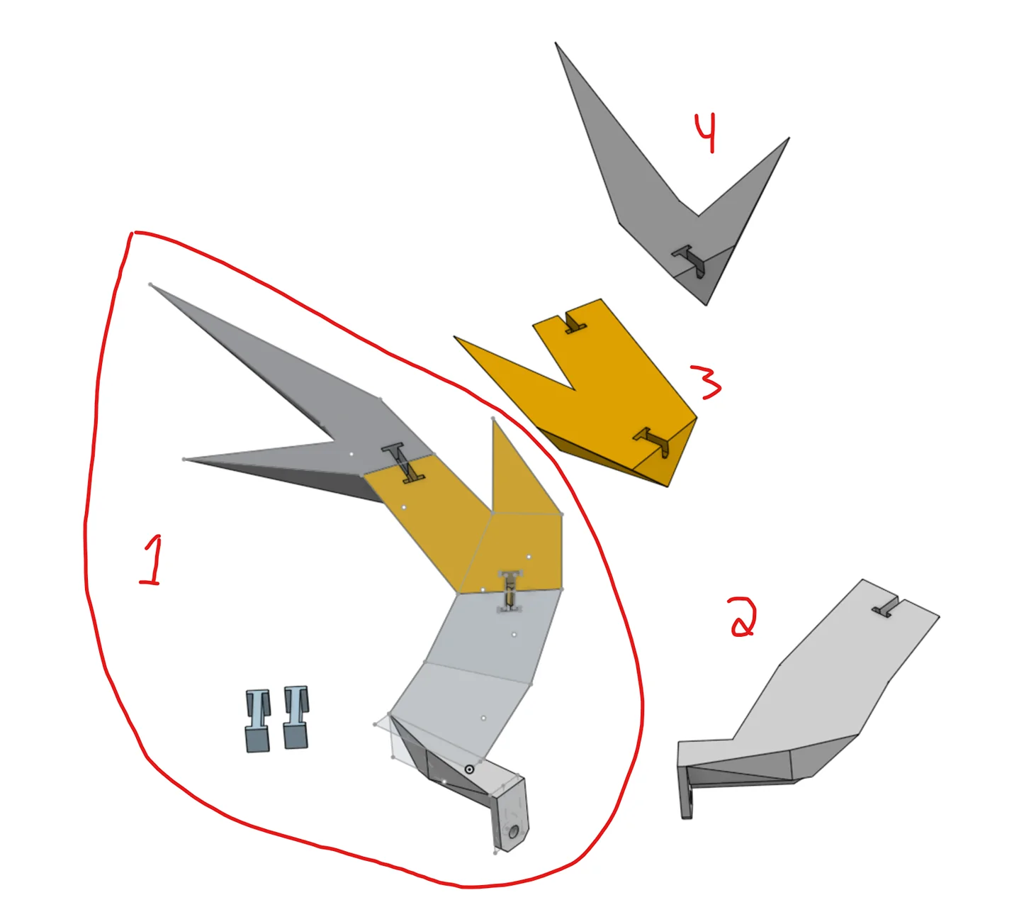

I printed both plates (twice) and bought the glue but the MakerWorld explanation for the gluing order was unclear to me. Since it is superglue, and because those dowels are super tight, I want to get it right. Do we glue the left and right sides together and then attach the bottom, middle, and top? Do the bottom, middle, and top also get glued together at the vertical boundaries or is the dowel connection enough (it sure seems like it). Finally, do you have any advice in getting the sides together that isn't just brute force? I'd use vice grips if I didn't think I'd damage the antlers. At the rate I am going I won't have these all put together until next Christmas but they are stunning (sadly. my wife wants me to put balls on the tops because of the sharpness of the antler tips).
Oh, my printer said that there was an error in the .stl for the reindeer nose and I had it fixed with an online tool: https://www.formware.co/onlinestlrepair. If ok, I will post the BambuStudio project on MakerWorld but it is your call since it is your design.

It has a ring of magnets, and a remote controlled light in the middle so I can light it up when I want.
The magnets hold extremely well, it hasn't moved at all. I'll take a picture of the back later today and post it.

Here is how I recommend you assemble it.
Step 1 is assemble 1 side first with both dowels. You only need to glue the ends of the antlers that touch, the dowels dont need glue.
Step 2-4 is add the 3 remaining parts on to the first side, 1 piece at a time. Gluing all the sides that touch (sides and ends)
Pushing in the dowels is a bit tough, I was able to do it pressing together the parts resting on a towel for cushion. I do not recommend a vice grip, it will damage the antlers.
You're welcome to post the nose on MakerWorld.
