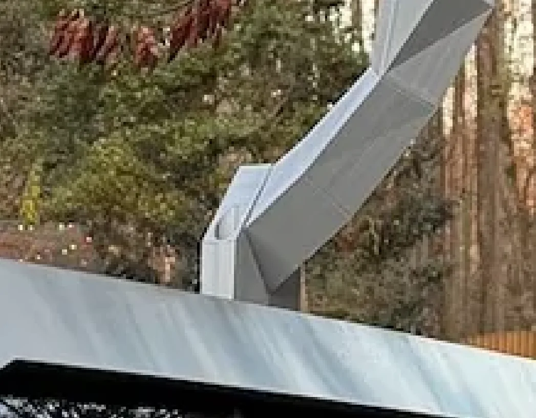

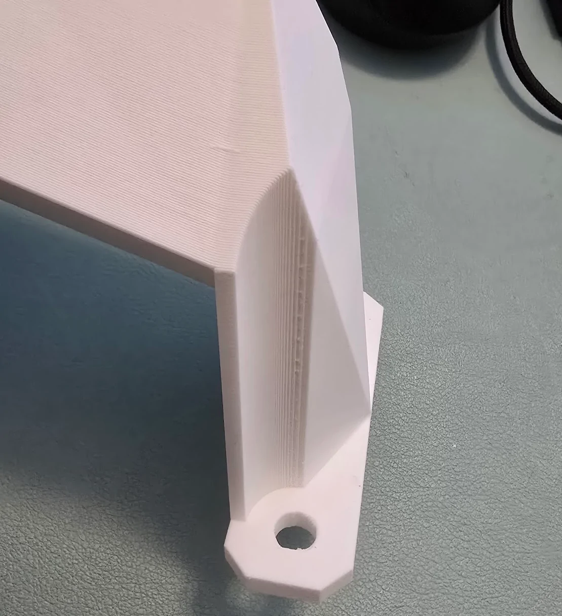

Interesting, your version is different than what I have. I wonder if some of the geometry is lost in the STL file? When I open the STL file it looks correct in my slicing app.
Yours vs mine:
Tesla Cybertruck [3D Print] Christmas - Rudolph Red Nose and Reindeer Antlers 1765747980171-61
Tesla Cybertruck [3D Print] Christmas - Rudolph Red Nose and Reindeer Antlers 1765748064806-oz

I picked mine up off of Etsy, it looks like it assembles the same using the little printed I-beam pieces, but yeah, the bases on mine are solid and tall.

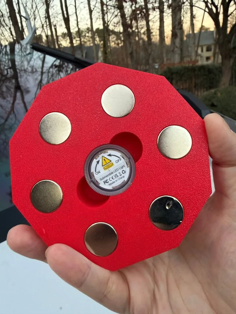

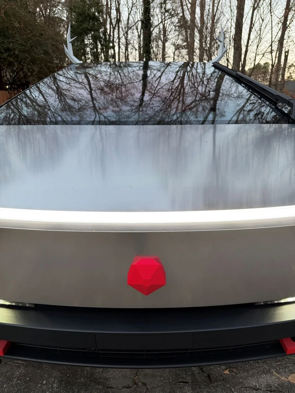

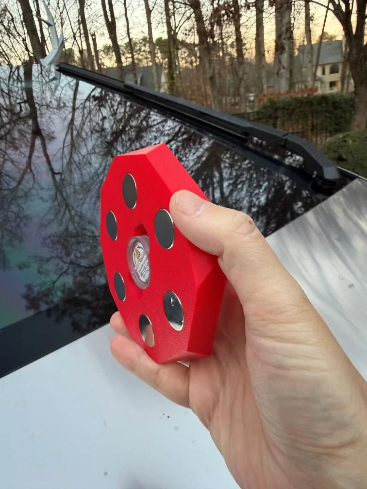

and those magnets are strong enough for the weak magnetic effect of the stainless?
Yeah, no problems so far. I've been driving around with it for the last couple of days, it hasn't moved it all.

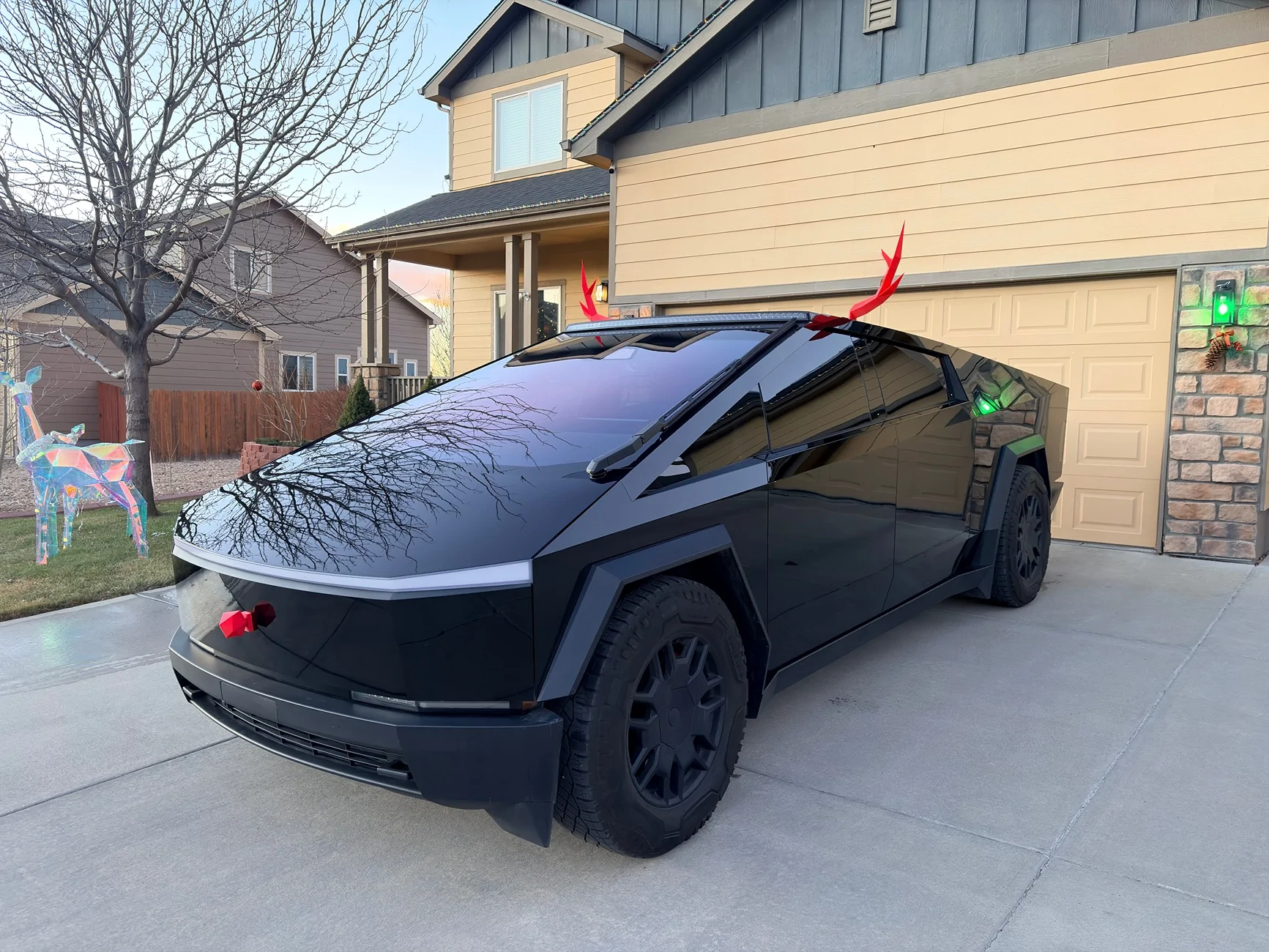

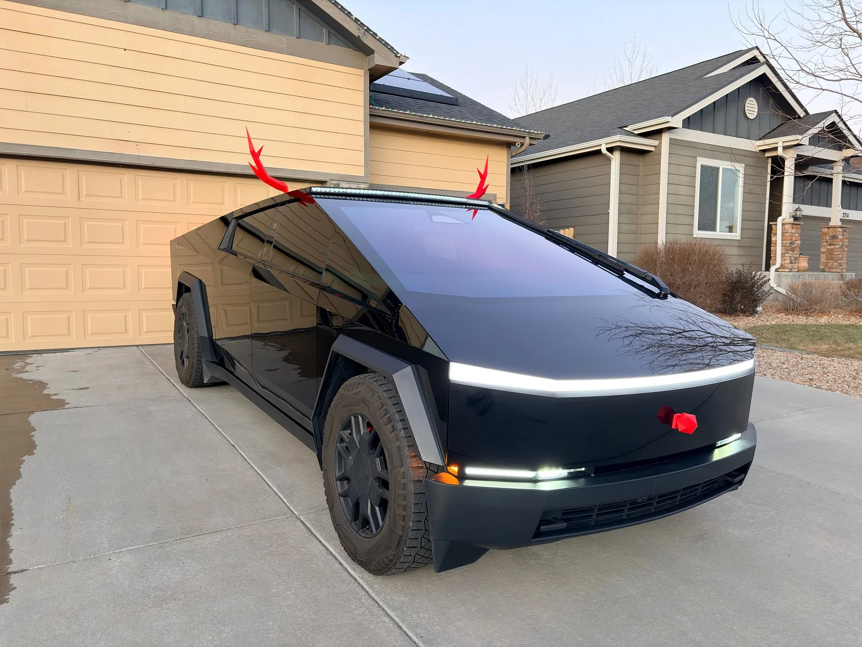

Printed. Posted on a face book page. Will give credit to the designer if you want.
Tesla Cybertruck [3D Print] Christmas - Rudolph Red Nose and Reindeer Antlers IMG_0408
Tesla Cybertruck [3D Print] Christmas - Rudolph Red Nose and Reindeer Antlers IMG_0411

Looks great! I had designed the nose to be lower and attached on top of the plastic bumper. It looks much better when attached to the front like that. I wouldn't recommend people do that to the raw SS. Every time I have used adhesives on the SS it left a residue that is extremely hard to remove.
Regarding the credit, that isn't needed, thanks for asking. I would just link them to the MarkersWorld files if anything.

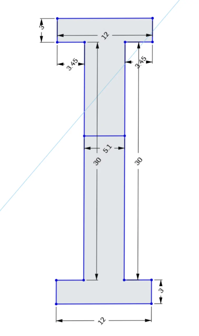

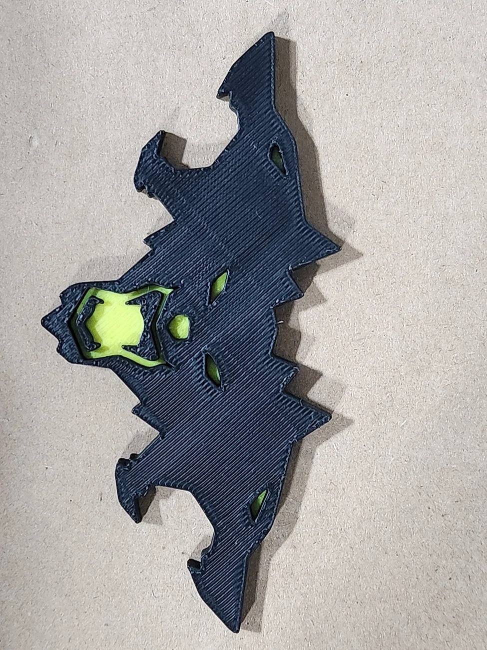

There is no way in hell i am getting these dowels to fit in! 😂 What am I doing wrong? Do u think it converting the dimensions incorrectly?
6,519
9,068
What printer? I have a Bambulab H2S and the MakerWorld link Pops provided printed just fine.
Re the dowels, is it that you cannot get them in at all or you cannot get them in all the way to the bottom? I wasn’t able to get them all the way in but it wasn’t needed.
the problem I had is not knowing how much of the loctite to use, so I ended up using 2 tubes :)

Sorry you are having trouble. They are wider than the hole, that's what gives them a tight fit. This might be a problem with the nozzle you are using and it isnt able to print at that detail level.
Here are the dimensions of the holes and the dowels in mm. You can try making a custom sized one to fit in your print. The difference in width of the dowel is only 0.1mm, thinner than a bee's dick.
Hole, 5mm wide.
Tesla Cybertruck [3D Print] Christmas - Rudolph Red Nose and Reindeer Antlers 1766384172621-yh
Dowel 5.1mm wide.
Tesla Cybertruck [3D Print] Christmas - Rudolph Red Nose and Reindeer Antlers 1766384451451-wk
