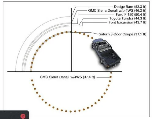

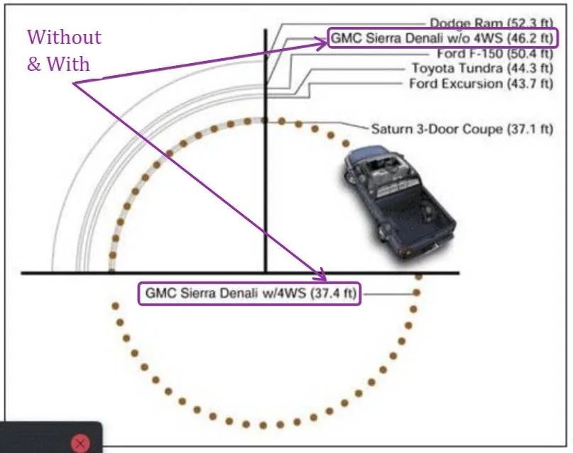

I completely understand how both steering systems work, and the advantages of steer by wire in their application. But having driven both...no, the Cybertruck does NOT outperform maneuvering in tight spaces.
- Full-size Silverado or Sierra: With Quadrasteer, these trucks can turn in a 36.5 ft radius.
- Cybertruck turning Circle (curb to curb), Approximately 43.5 ft
What I'm saying is that the Cybertruck can do better. If they were able to increase the rear steering maximum turning operation to 10 degrees (or more), that combined with the steer by wire, that it would clearly be on top.

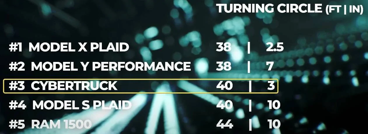

FYI, that it is closer to 40' 3" -- @T Sportline video with measurements below
Tesla Cybertruck 4 Wheel Steering advantage demonstrated (turning radius - ON vs. OFF) etdtI6o

The 43.5 ft. Cybertruck turning circle is an outdated figure from nearly a year ago (before Tesla significantly tightened the turning circle by increasing the rear steering angle). The Silverado EV still has a tighter turning circle, but it's harder to put it to use.
Steering systems without steer by wire have used traditionally used a parallelogram steering linkage arrangement. One disadvantage of this arrangement is that, due to the angles involved of the pitman arm and idler arm at sharp turning radii, the steering ratio decreases as the wheels approach the steering stops. In other words, the tighter the wheels are turned, the more you have to turn the steering wheel to turn the wheels a given amount.
Cybertruck's steer by wire actually works in reverse, making it very easy to use the last bit of steering angle without having to bring the truck to a stop as you make a full transition from left to right as you maneuver through a constricted situation that requires maximum turn angles in both directions.

I'm not talking about Silverado EV 4 wheel steering... talking about the GM Quadrasteer system (2002-2007). Completely different system.

Tesla hasn't updated the Owner's Manual from the original turning radius from back in January. And to be clear, I'm not saying the Cybertruck has a tighter turning radius than your old Quadrasteer vehicle, I'm saying the variable steering ration of Steer-By-Wire makes the Cybertruck more maneuverable at low speeds.
