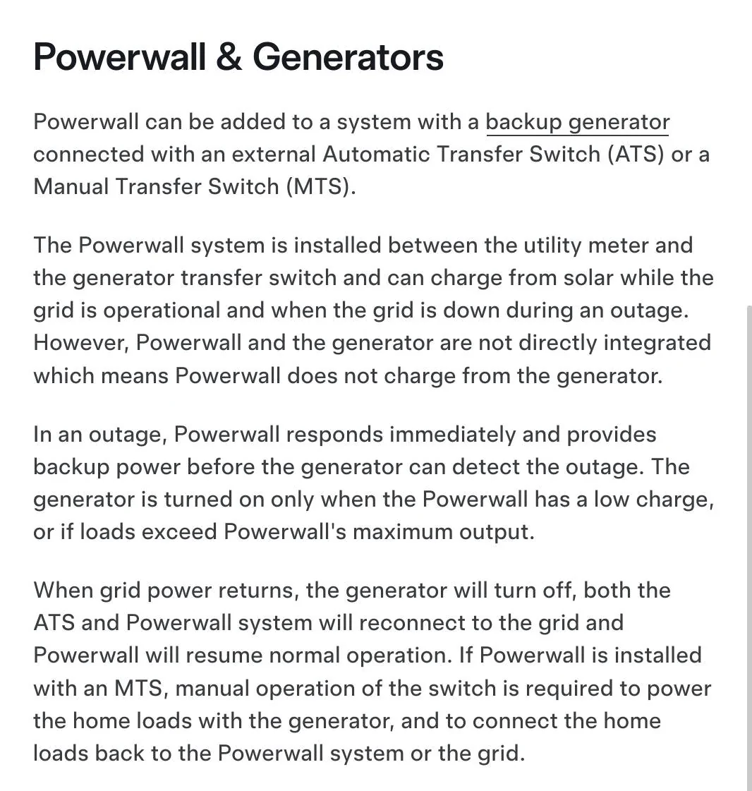

So is it possible for us powerwall and solar people to have an electrician come and install a generator inlet with a manual backup switch somewhere so we can just use the 240v truck outlet to backup our homes while we wait on this promised software miracle?
If so, where would this go? On the board that’s inside the Tesla switch which isolates the home from the grid, or on the outside of that switch so the system sees the input as “the grid”?
May 27, 2024
4,646
5,652
It is possible. Putting it between gateway/ powerwalls and the house panel is the best option.
https://www.tesla.com/support/energy/powerwall/learn/combining-systems
