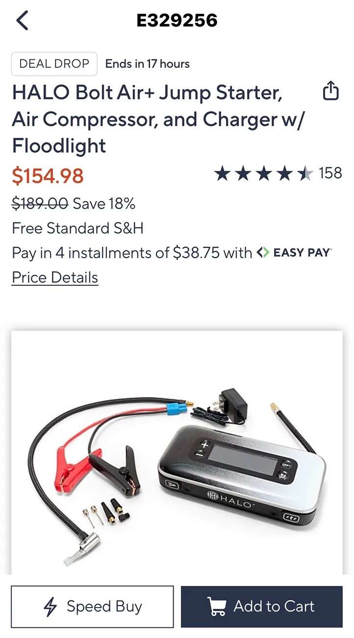

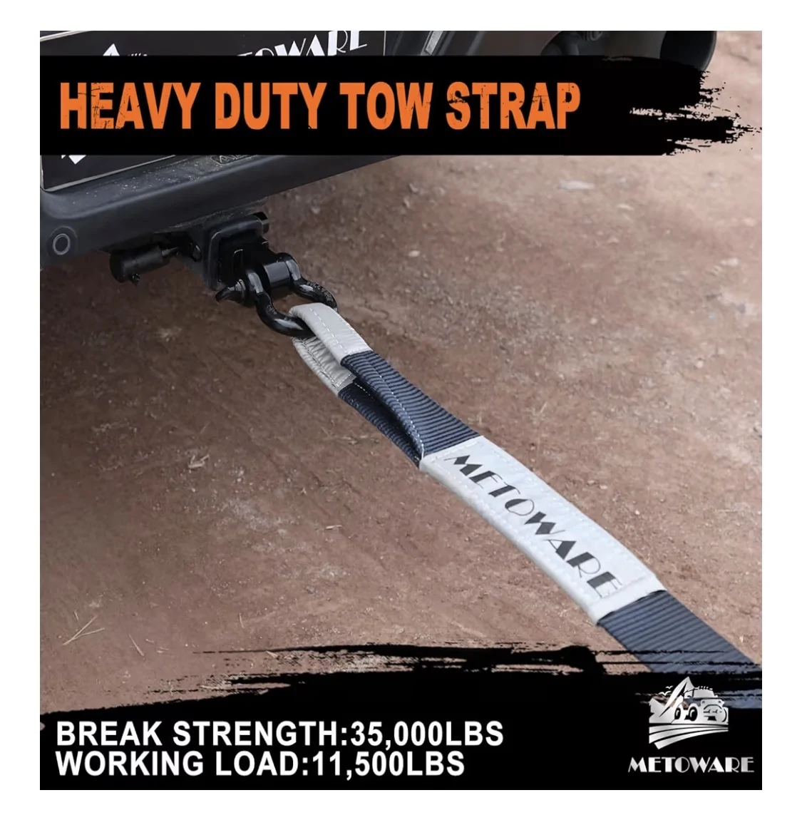

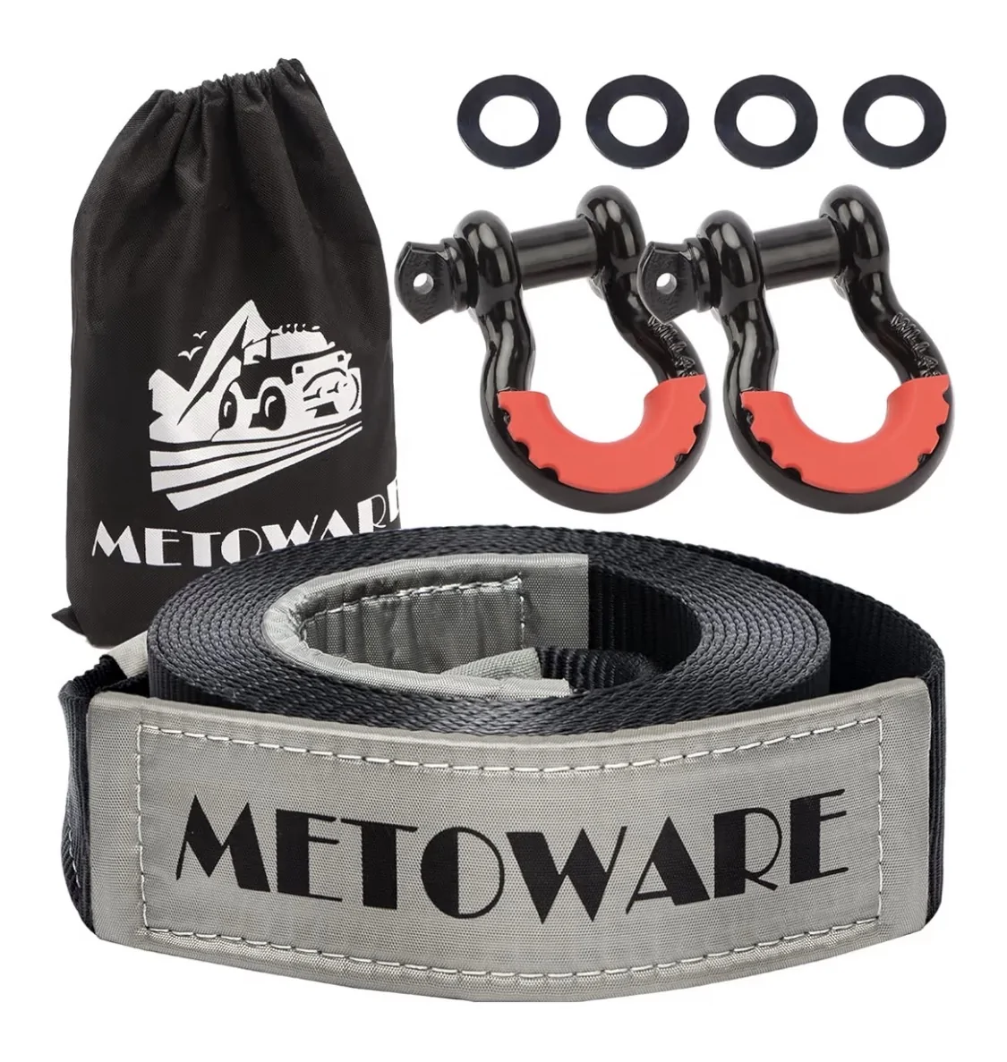

Flat bed recovery is not towing. But for the flatbed recovery truck person it’s probably ok to use the tires to pull the truck onto the bed but yes way better to use the tow hitch.
The Tesla manual doesn’t show this, it shows power posts in the frunk. But no power equals no open frunk and you will need to connect 12 volt wires located in front left fender.
There is a post in this forum with someone asking what the wire was hanging out from their fender.
**To open the Cybertruck doors with no power, use a 12V power source to connect to the jump posts under the front-left fender.
Always carry a 12v battery. Halo is good, but you can go with cheap auto store too.
