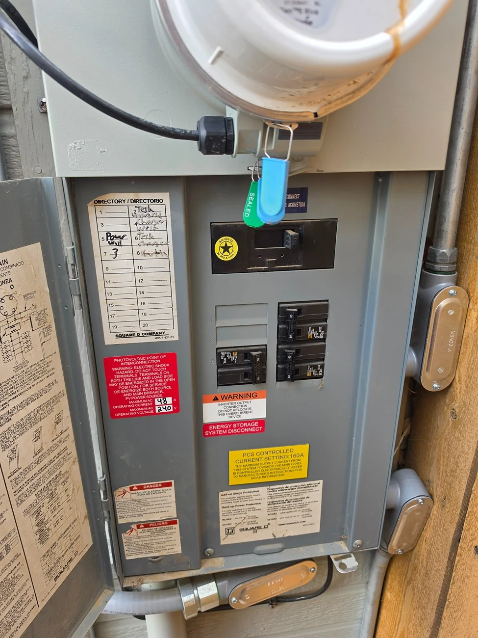

Interested as well! We have 4 EVs - two NACS, two J1772. Getting by with a single Gen 2 Tesla Wall Charger.
But I just ordered a new Universal Wall Connector, as I want an electrician to move the charger location a few feet so the cable can reach four cars, instead of just two today.
Debating on keeping the Gen 2 and adding the Gen 3 vs. just adding the Gen 3. They can't load balance each other if two vehicles are charging, and since I have 3 Powerwalls, I've been able to pull ~40kW from the grid during peak usage. Adding the additional charger would push me over my home's 200A capacity, unless the Powerwalls are smart enough to throttle.

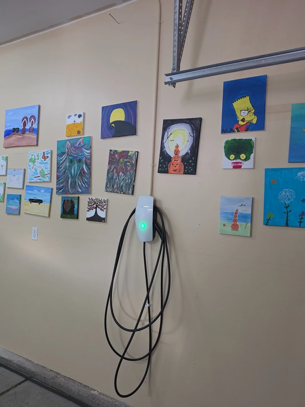

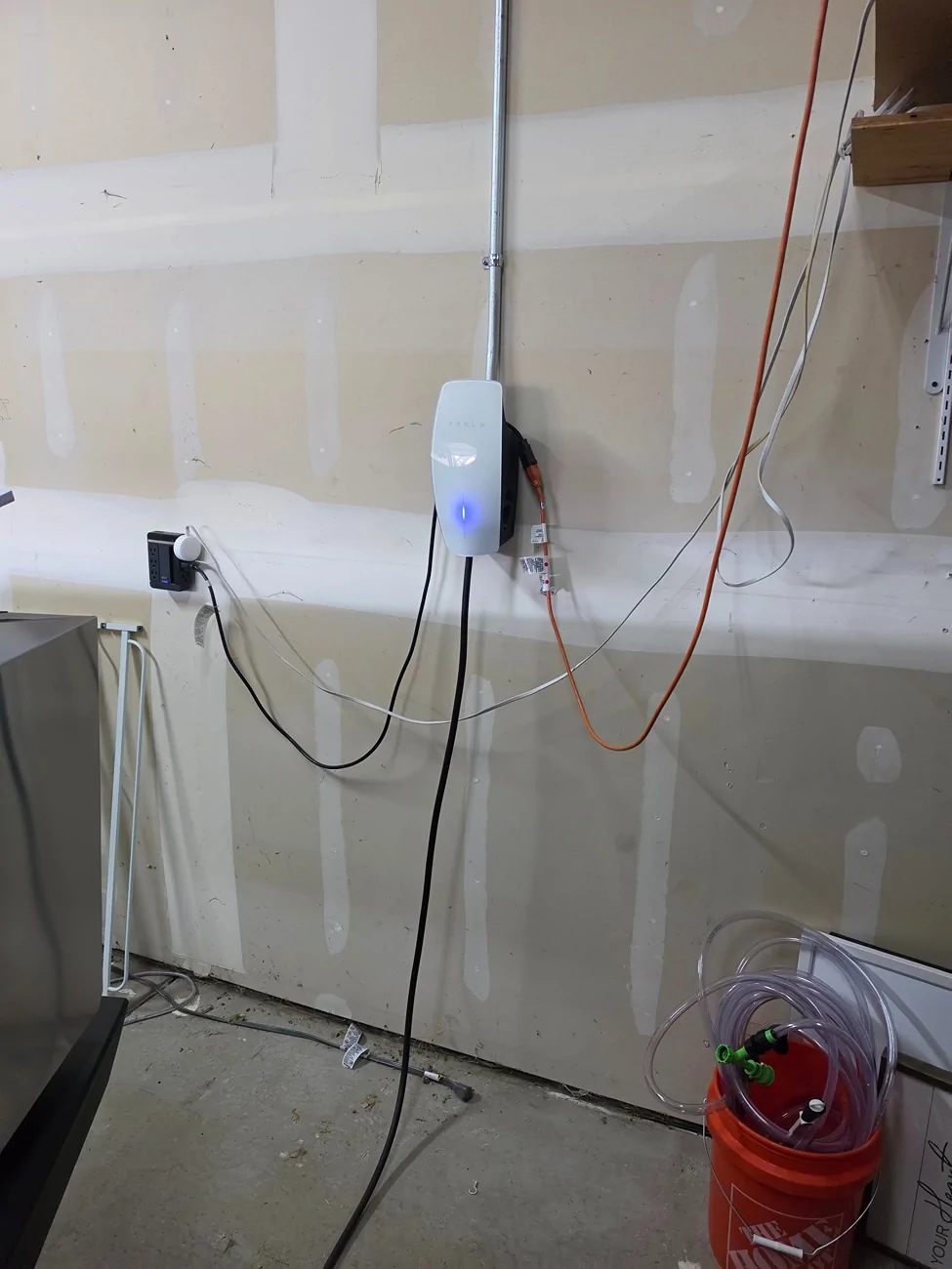

I just had another Tesla Gen 3 Wall Connector put in next to the current one that my wife uses with her MY. The energy company in my area is offering a $1200 rebate that goes towards the installation and charger so it works out pretty well, especially if you don’t have to run the cabling a long distance from the breaker. Since I plan to park the CT on the opposite side of the garage I bought a 20’ extension cable and ran it above the garage door near the ceiling and then I bring it down on the driver side of where the CT will park. Found a nice EV Cable retractor that keeps the slack cord out of the way. My thought process on this, was if I had the CT charging and the wife needed to leave she wouldn’t be backing over the cable, etc. just makes more sense.
I didn’t plan on doing any PowerShare so just got the cheaper charger. The gen3 do show up in the Tesla app which is nice to review history and charge features.

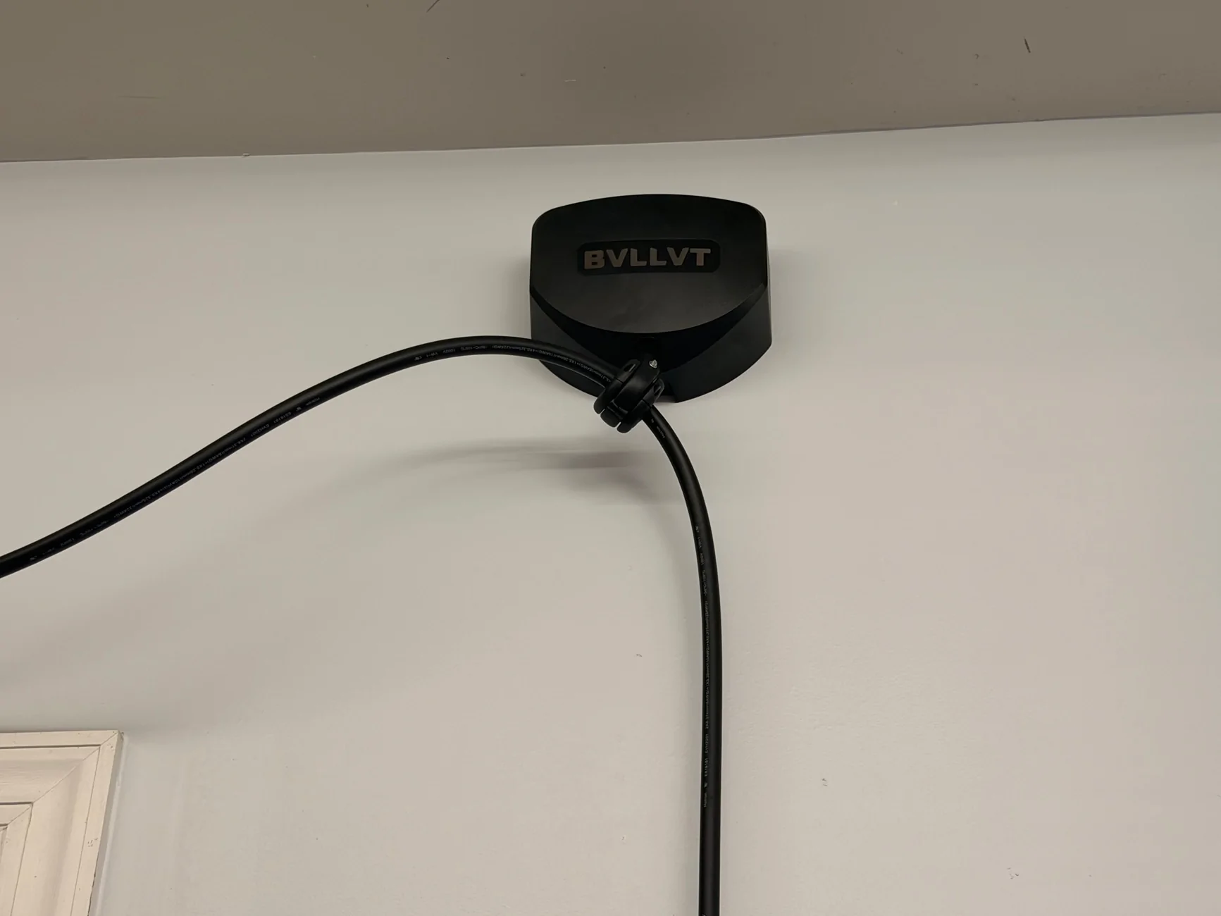

3 EVs here.
2025 Cybertruck- 60 amp Tesla Universal Wall Charger
2023 Model Y- 50 amp Nema 14-50 receptacle with Tesla Mobile Charger.
2026 EV9- Regular receptacle and 2' from the Tesla Universal Wall Charger.

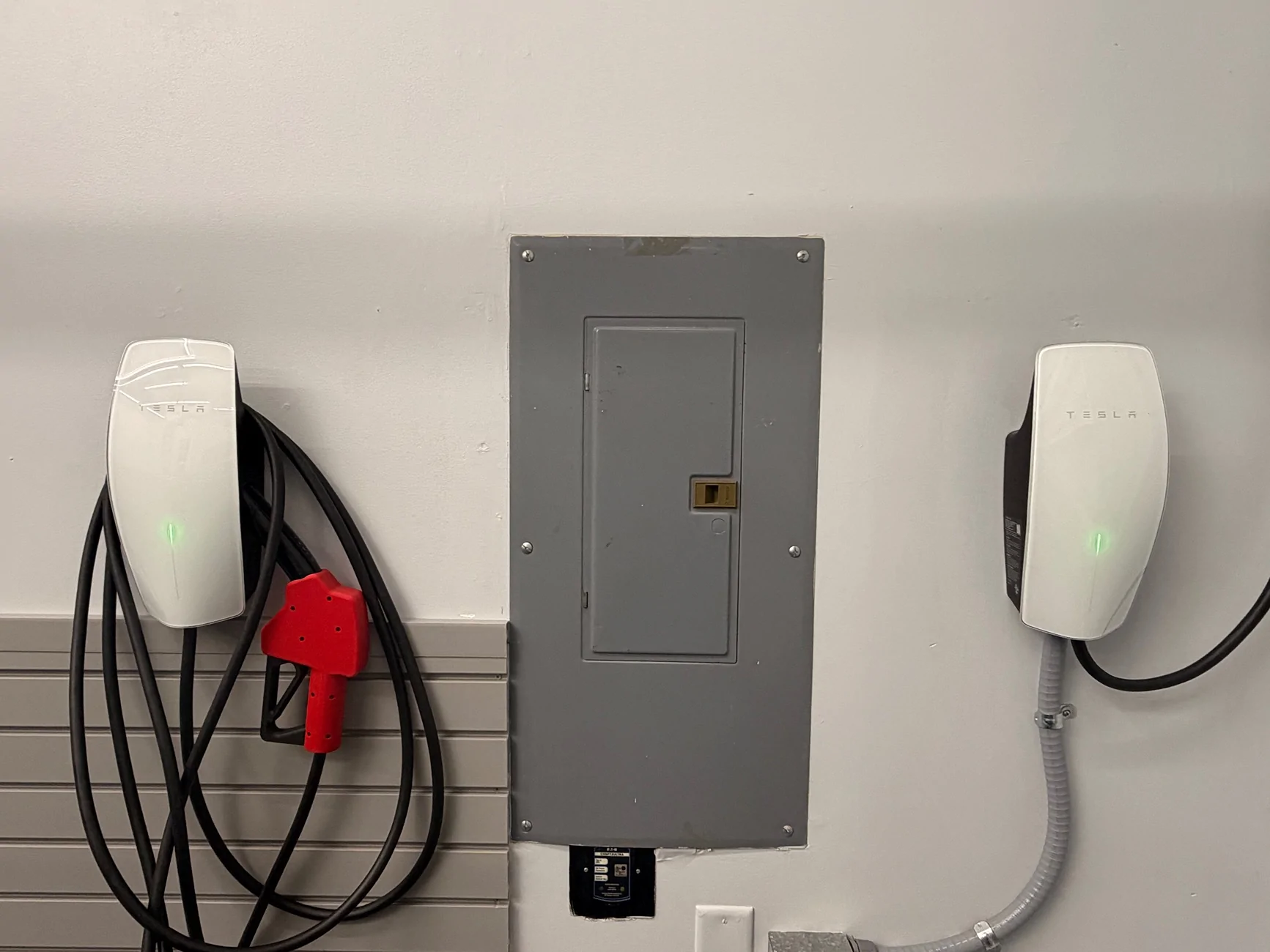

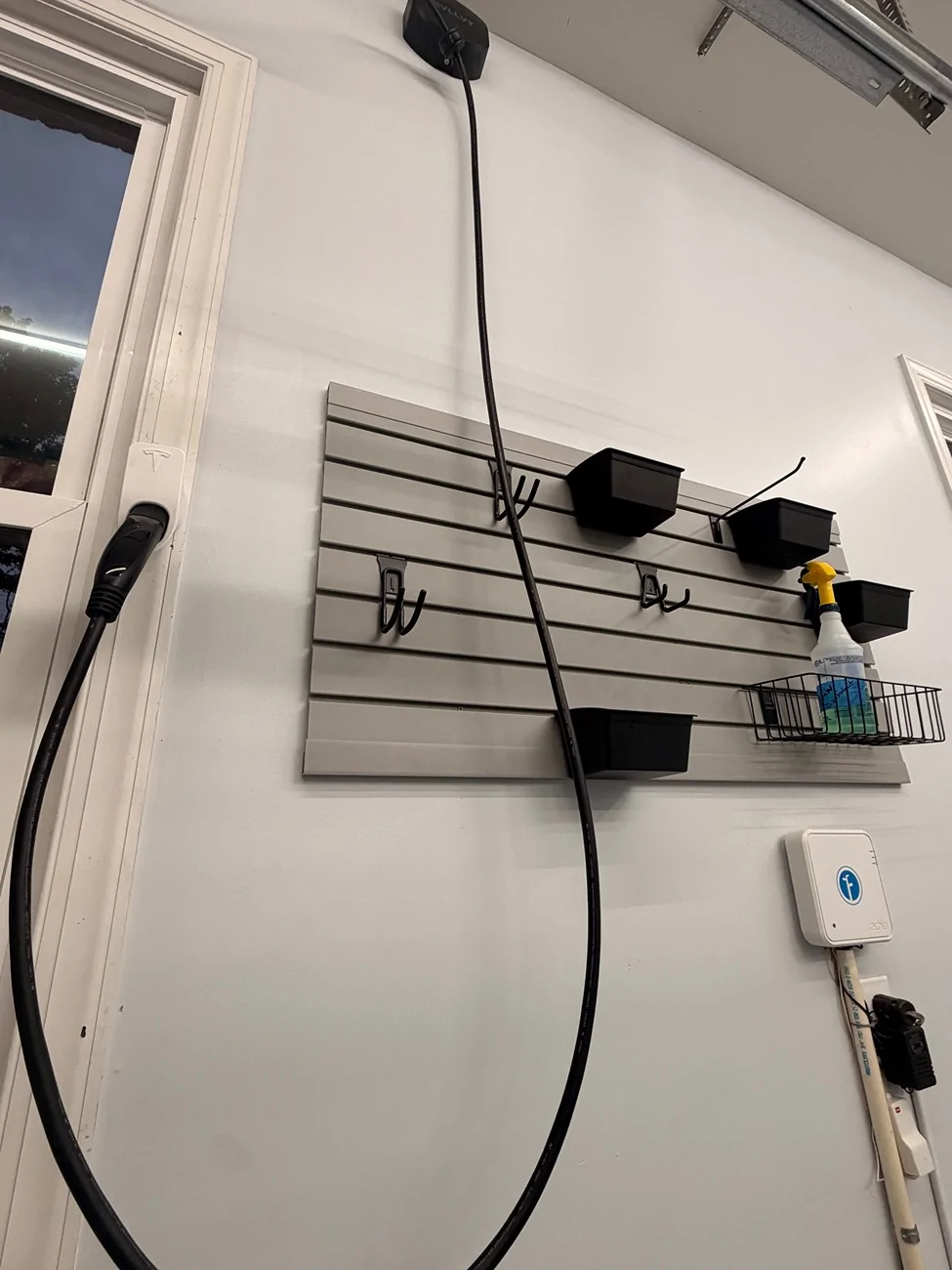

I am using a universal wall connector and a Gen 3 wall connector. I have mine on separate circuits connected to the main panel by the meter.
My only regret is not having the wiring run through the walls and instead having conduit lines. I plan to finish my garage someday and want a cleaner look.
For scheduling, my utility (xcel) works with a company called Weavegrid. They set charging schedules based on grid loads, peak pricing, and my needs. Basically I tell them I want my EVs charged by 6am and they work out all the rest. If I need to charge randomly, I just send a quick text and they override their automatic scheduling. Plus I get money off back on my utilities each year.
The biggest benefit, for me anyway, is that I can have both EVs charging at max and everything in my house going at the same time. I was amazed to see my load be above 38kW one time with both chargers going and the heat in my house on. I use a heat pump with a 10kW heat strip for subzero temps. I was little worried by how much power I was drawing, but everything worked great.
