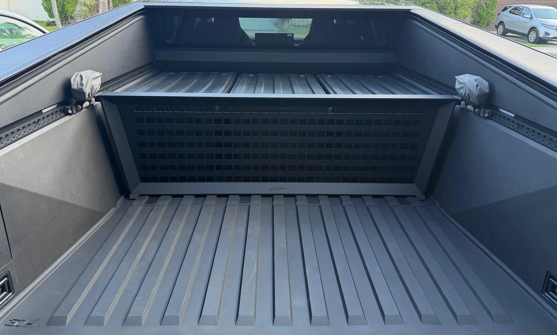

Just installed.
  • Tesla OEM L-Tracks (Replacement set, first set arrived damaged)
  • Tesla OEM Cargo Bins
  • Tesla OEM Bed Divider
  • Juggernaut Design Ultimate Retractable Ratchet Straps w/ optional weather covers
  • 3W Bed Mat

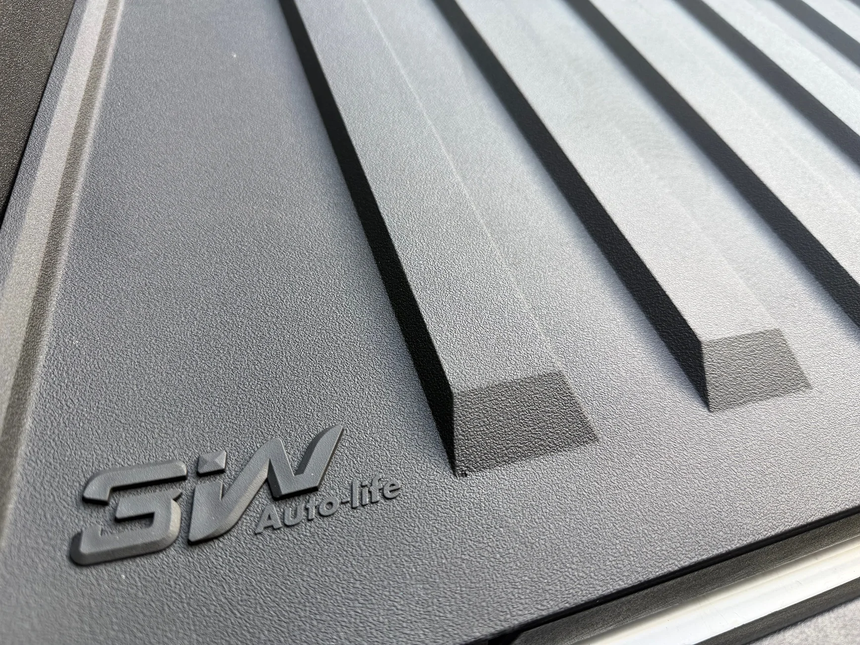

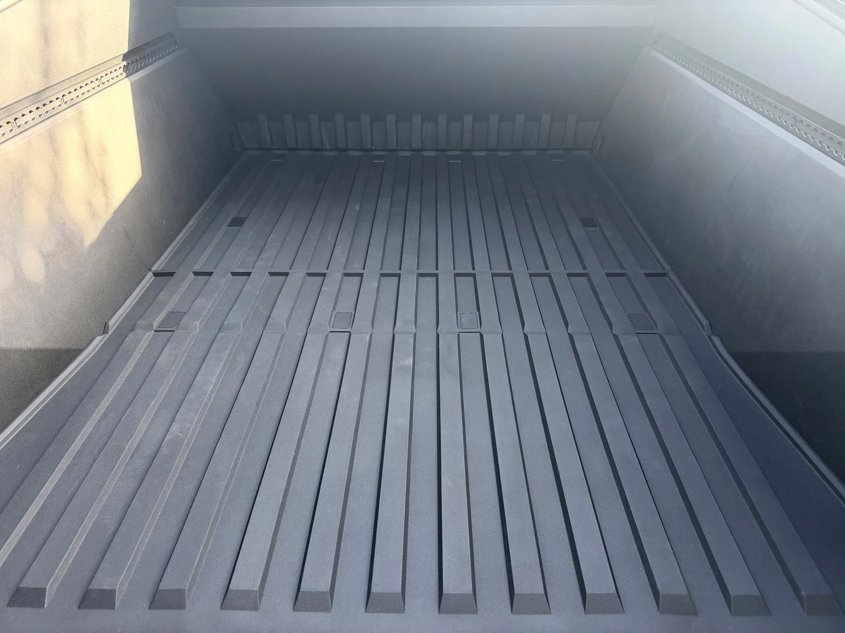

Picked up the Bed Mat on Amazon over Prime Day. It was $85 and now $99.99. It doesn't specify if it fits the newer 59K model or even 2026 for that matter but I took the chance. Fits perfect and even slides underneath the back wall. Good quality mat, definitely recommend.

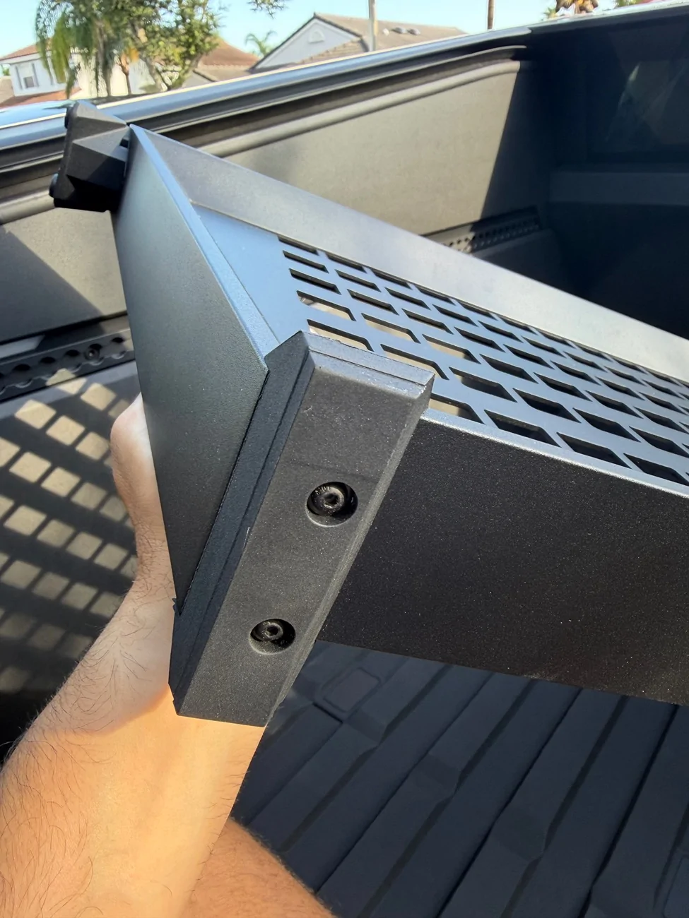

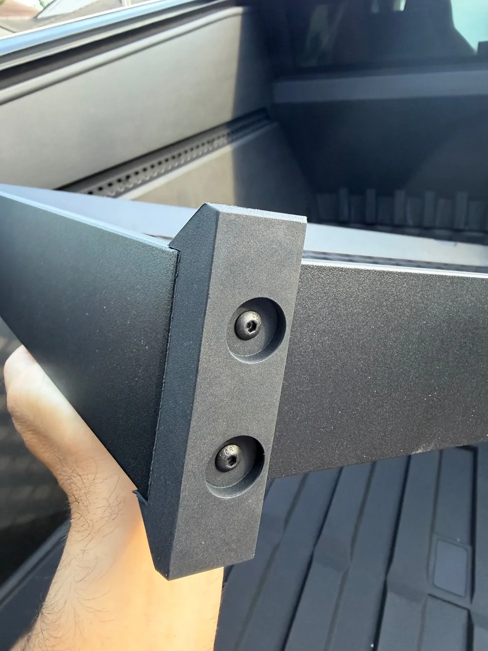

*NOTE
If you are installing the factory Tesla Bed Divider, it will not latch into the grooves of the L-Track when using a bed mat. The mat adds some additional height / thickness therefore misaligning latching points between the bed divider and L-Track system. Thankfully, Tesla thought about this.
On the bottom of the bed divider there are two small screws. They can be removed using a 3.5mm Allen Key. Once removed, you can remove the first layer rubber pad / spacer and re-install the screws. This gives it the drop needed to compensate for the height of the bed mat. Now, everything fits perfect.
