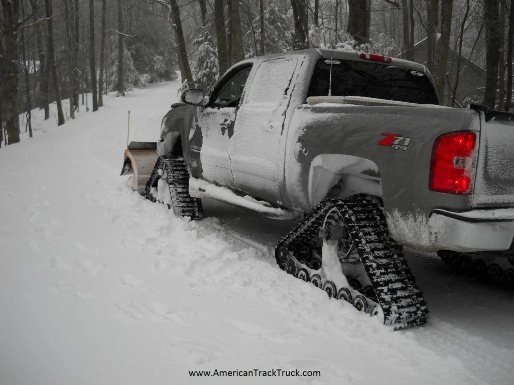

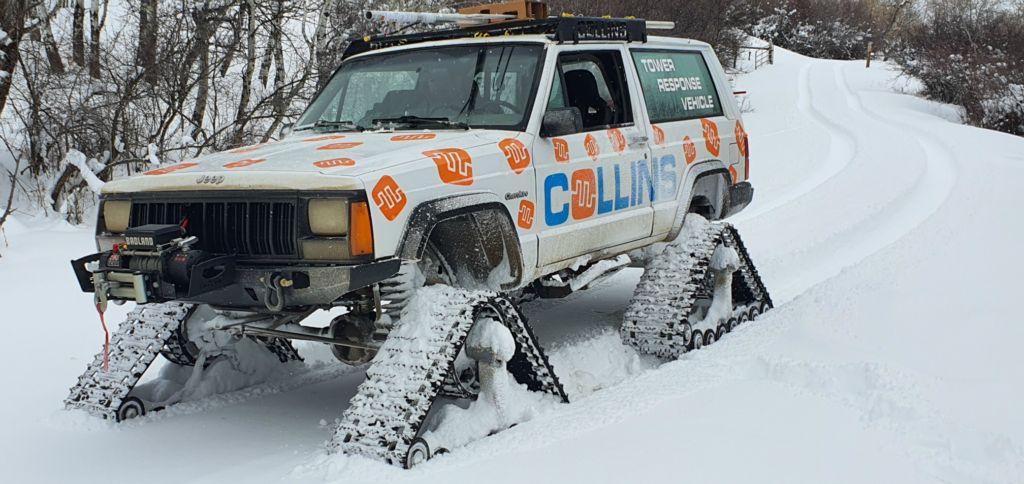

In that case, I'd probably go with converting to the tank-tread snow cat type of device:
Tesla Cybertruck Aftermarket 325 wide tires + 18" Method wheels installed on Cybertruck trackedplowtruck
Tesla Cybertruck Aftermarket 325 wide tires + 18" Method wheels installed on Cybertruck Collins-Communications-Dominator-Tracks-Jeep-Cherokee-Remote-Tower-Service

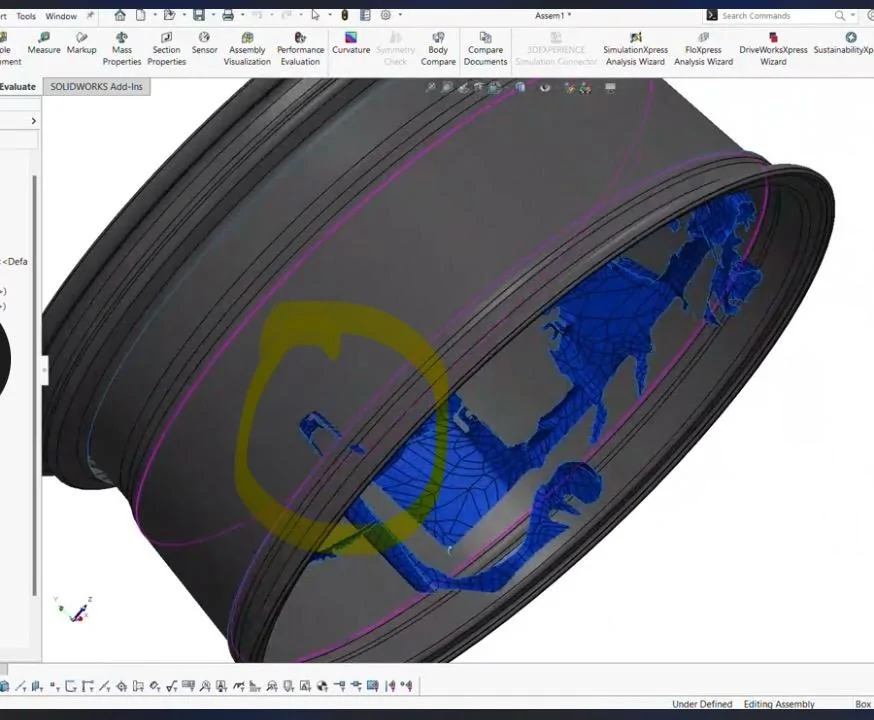

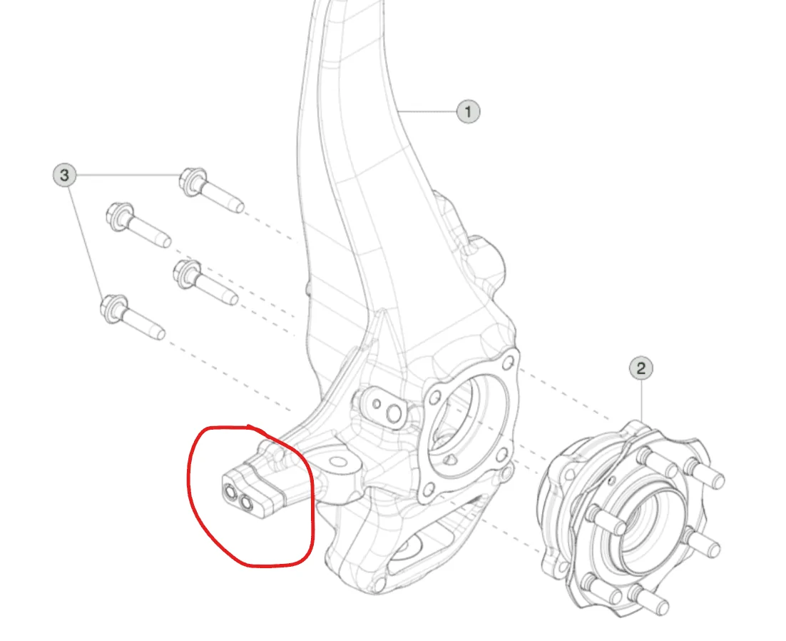

Gang, 18” wheel doesn’t bolt on without modification. That was the question we answered.
You’ve got to “remove and ditch” this component from the upright in order to make 18” fit….i suspect this owner did that. Btw, we wanted to confirm the purpose of this component and understand the consequence of removing it with our Tesla engineering contacts before broadcasting claiming it was okay to do. We were / are being responsible first, rather than presumptive. But yes, remove it and 18” doable.
The component is related to brake harmonics.

Here is that nub sticking through the barrel of an 18” (if left installed)
Tesla Cybertruck Aftermarket 325 wide tires + 18" Method wheels installed on Cybertruck IMG_4209
Thanks for that, was wondering why there was this extra part, with threads and all that for "nothing"
Likely a revision will come latter that eliminates it, we've seen it before on other Tesla suspension parts

Apologize for my ignorance on this - but want to be clear on that diagram.
Where are the brake calipers in relation to that "nub". Is the nub BEHIND or IN FRONT of the break calipers? Or is it elsewhere?
I saw the Cybertruck in person once, and remember there being ample spacing (about 1.5-2"??) between the brake calipers and the oem 20" rims, which would mean an 18" would fit. I don't recall seeing a "nub" protruding anywhere past the calipers, but I also did not look hard enough.
If this "nub" is elsewhere, like closer to the plane of the upper control arm, simply increasing the offset of the wheel (like what the OP's image did) would avoid the nub, no?
Is your solidworks diagram using the OEM offset?
Thanks for sharing this regardless. Next time I check out the Cybertruck will take some photos and look for the nub.
