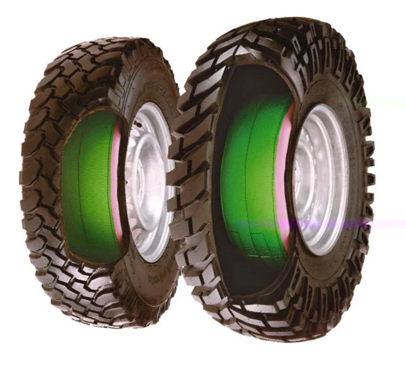

Offroad flats were all sidewall lacerations. No replacement warranty. Aussie beadlocks solved the runflat-get home problem nicely.
Tesla Cybertruck Air Suspension as Tire Jack on your Air Suspension's Cybertruck 22BF294F-79CF-4F91-809F-75913403581D
Tesla Cybertruck Air Suspension as Tire Jack on your Air Suspension's Cybertruck 7C7BB2D0-52ED-4340-B556-DE3D99D9BA4D
163
10,710
26,922
I’d never seen this before on a truck/ OHV tire.
But there is something very similar for mountain bikes. They generally just use a foam core to prevent “snake bite” pictures.
114
14,288
23,740
Wow, that is pretty cool. It's like how they use different coil diameter to create an increasing amount of resistance to compression before bottoming out.

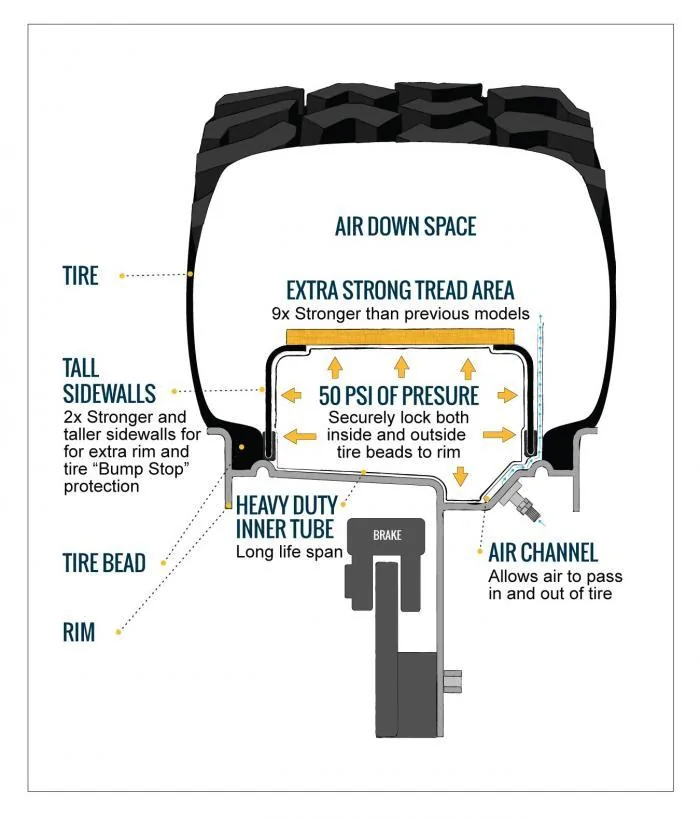

Hi Rex, I found this enclosed reference. The image is the same so I assume this is one of the products you were talking about. COYOTE BOLTLESS BEADLOCK SYSTEM - Coyote Enterprises (coyoteents.com)
Bought mine in 2003 for my Rubicon as Aussie beadlocks from ORW in San Diego. These are now US DOT approved and improved Coyote branded exactly same Aussie beadlock. I run on standard 16” x 9” rim which enables to crawl as low as 8psi. Never blown a bead off a rim. Never notice out-of-balance with the extra tire inside that adds weight. They balance up just like any other wheel and tire.
Note: you will be drilling a 2nd valve stem into your rims for the Aussie bladder. Didn’t like that but have never had a leak or problem. Its been bomb-proof.
