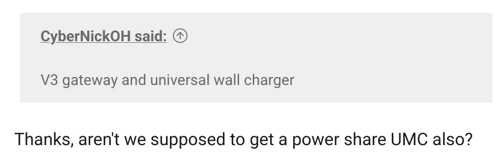

That’s a Mobile connector, not a Wall connector.
Yah, the post I replied to said "UMC" which I took to mean Universal Mobile Connector versus a typoed version of Universal Wall Connector given they were replying to a post calling out the Wall Connector
