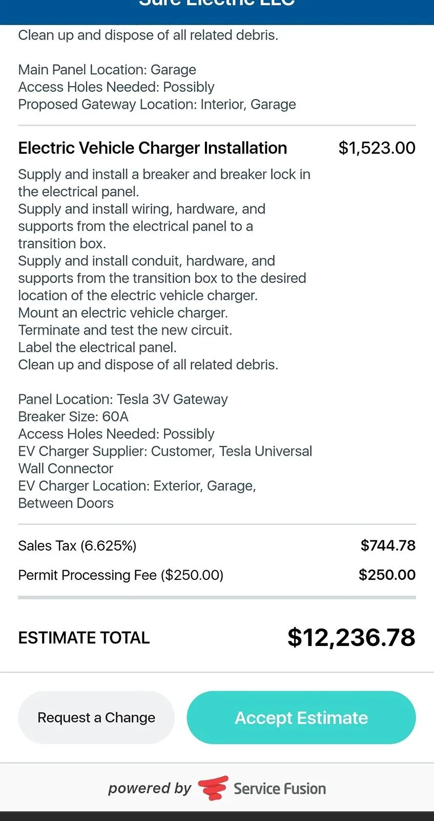

my local electrician in NJ quoted me over 12k for installation so I'll pass
This doesn't add up. The total of above figures is around $2525. Is this the full document, or some got cut off?

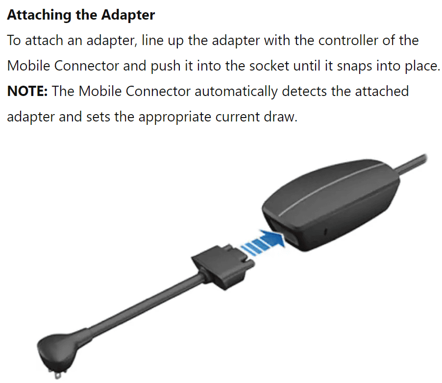

Update on this - I stumbled across the PowerShare Mobile Connector manual via Google, which seems to be the only place it lives since you cant buy the PSMC in the Tesla Shop yet...either way, the Adapters section states the connector detects the attached adapter and sets the appropriate current draw:
Tesla Cybertruck All Foundation Series owners will receive $2,500 voucher for Tesla Shop (to purchase Powershare Home Backup Equipment or other products) 1717779226918-w

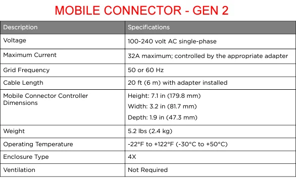

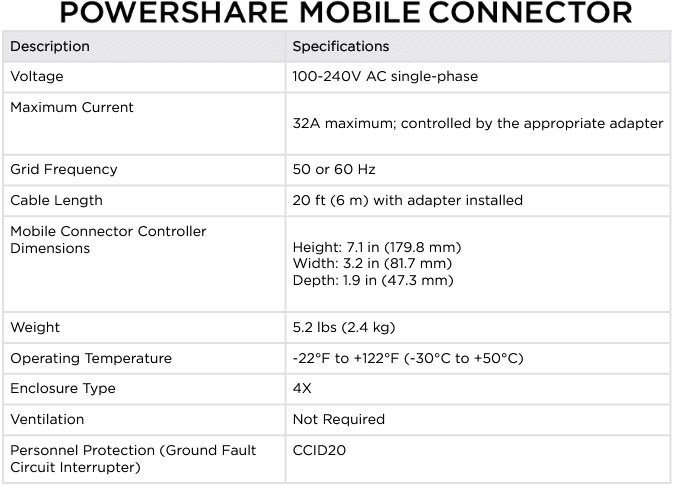

The Gen 2 manual also says the same thing, so I am still puzzled as to why the dogbone I purchased and explained in my previous post works with Gen 2 MC but doesnt with the PSMC.
The only difference between specs in the two manuals is an added spec line for GFCI CCID20 protection:
