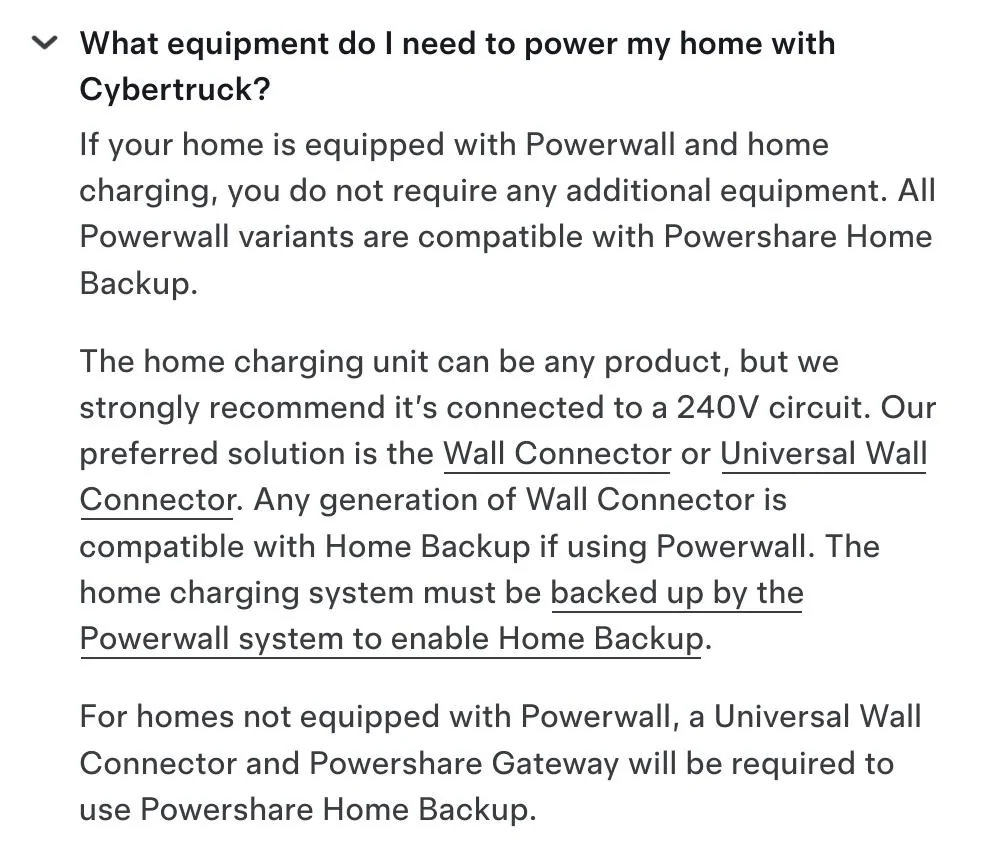

We received our $2500 voucher 06/19/24. Our installer (Car Charger Specialists) says that they "will take your voucher, but the install will cost a couple hundred on top of that". He said that he has the UWC and they need "to install a meter and a new gateway".
I'm not sure about that. I'll enquire w/Tesla, but if anybody else has info, please share.
We have 2 Powerwalls + solar, non-Tesla EVSE.
May 27, 2024
4,658
5,660
You don't need anything more than what you have already to use Powershare.
https://www.tesla.com/support/powershare#equipment

If you have Powerwalls, the UWC is recommended but not required.

Do you happen know why this is the case ? Just curious.
Cybertruck needs a Gateway to tell it that it's ok to export power. There are no extra wires to the truck, so any EVSE can work (as long as it doesn't fault on reverse current flow) and the EVSE reports max allowable current, so Cybertruck limits itself to that level.
