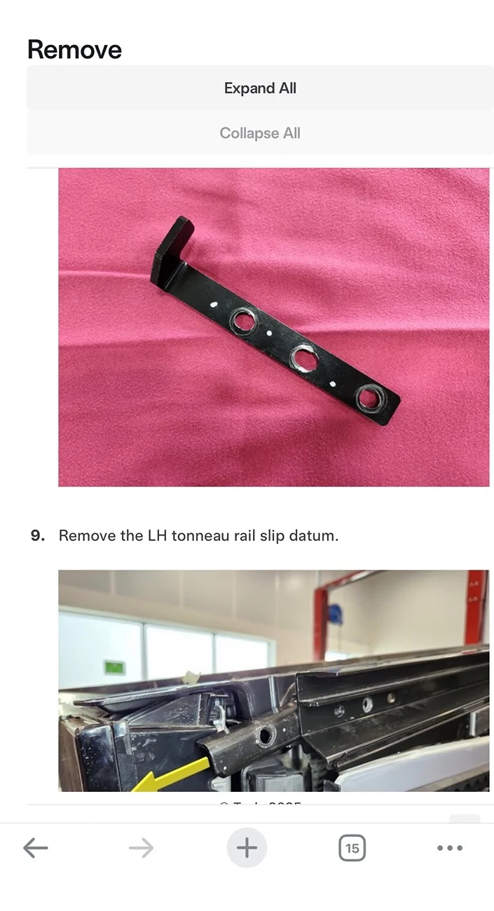

The stops are just right at the end of the rail meet the tail gate. I believe they have two screws if I remember correctly. Let me see if I can find them in the service manual.

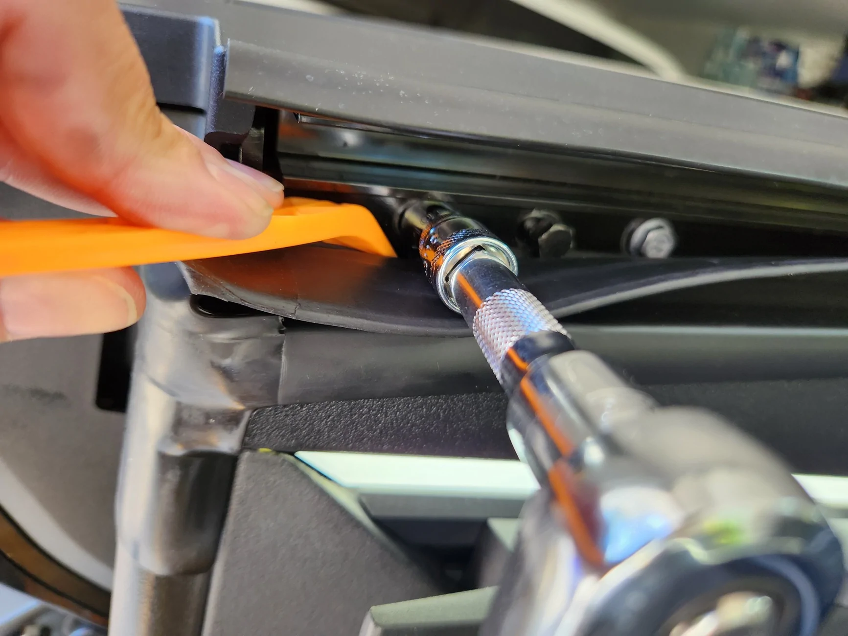

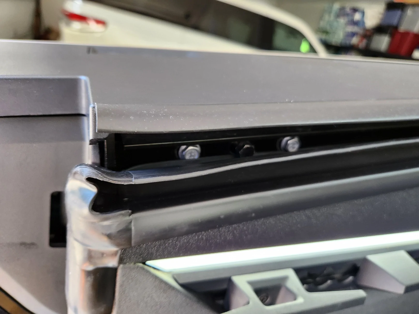

Awesome! Thank you. I just did it in 10 min and it worked. Word of advice for others who need to do this, you dont have to take anything off the truck if u dont want to. I was able to just loosen the 3 bolts with a trim tool (we all have hundreds of them by now) to hold the rubber out of the way and squeeze a ratchet in there. Loosen all 3, slide the stop as far forward as you want and tighten back up. I didnt need to calibrate even.
