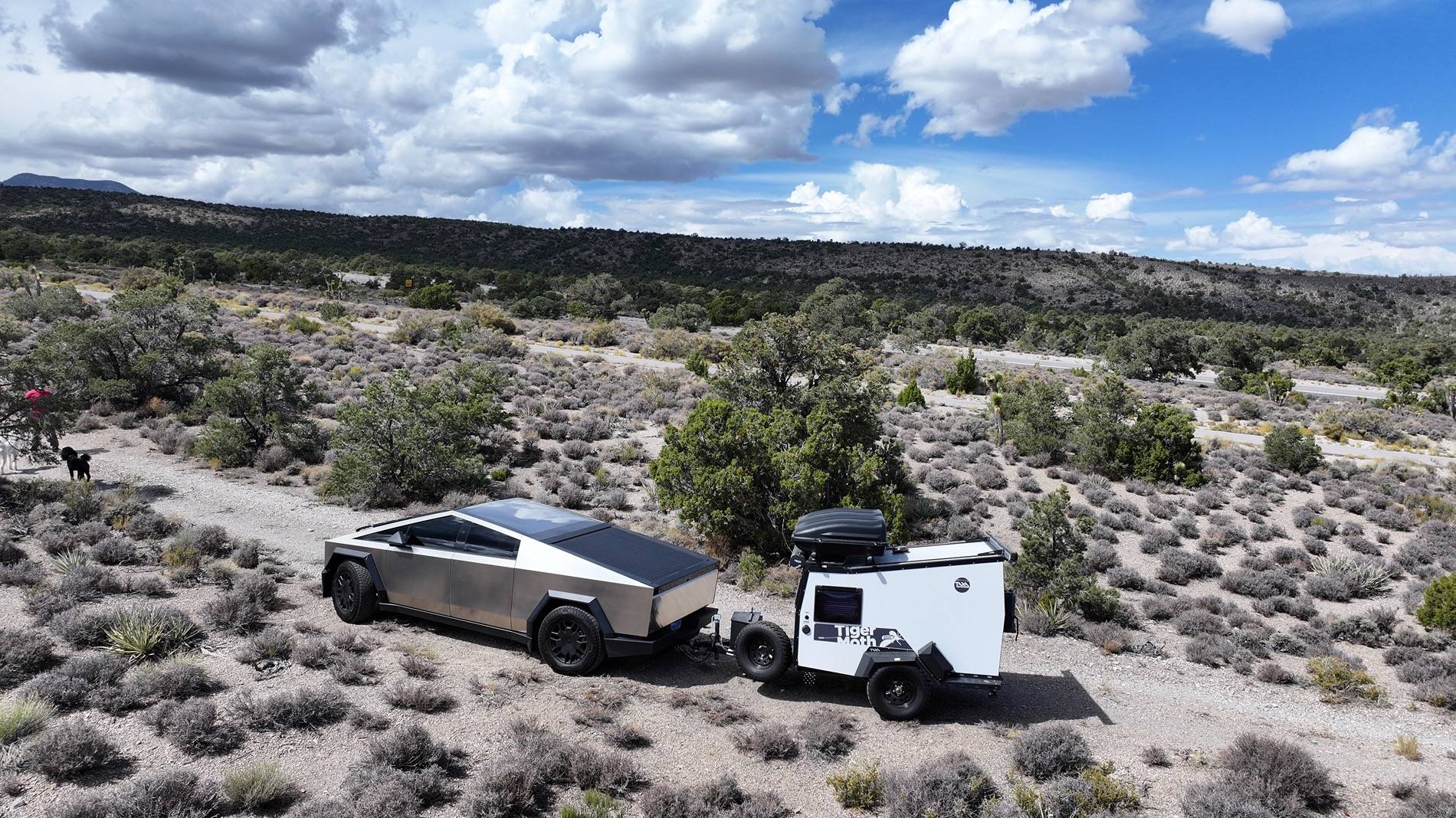

Tesla Cybertruck Anybody have experience with or thoughts about this spare hitch solution? dji_fly_20240920_122426_0154_1726886409231_photo

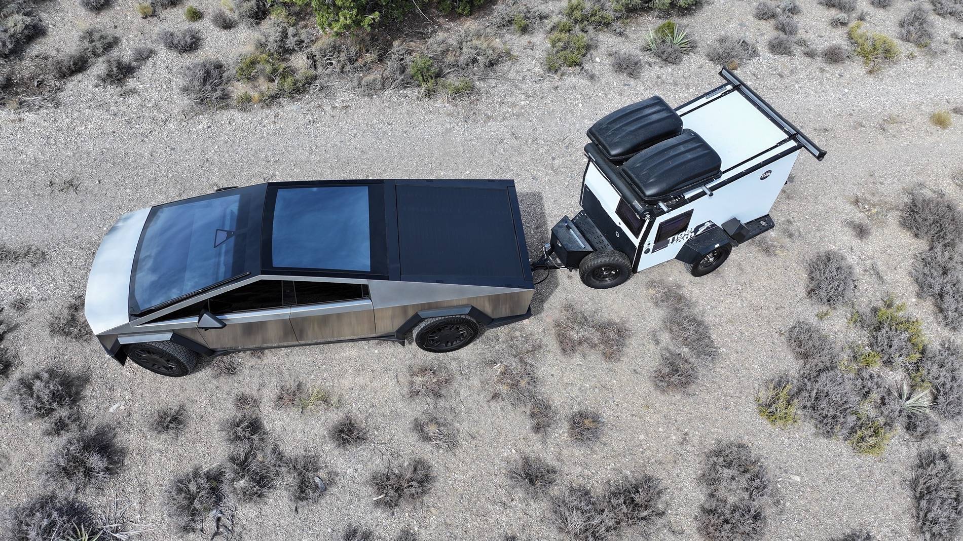

Tesla Cybertruck Anybody have experience with or thoughts about this spare hitch solution? dji_fly_20240920_122454_0156_1726886408632_photo
I guess maybe an option is to lose the spare for the trailer and throw the CB spare on that mount instead.
