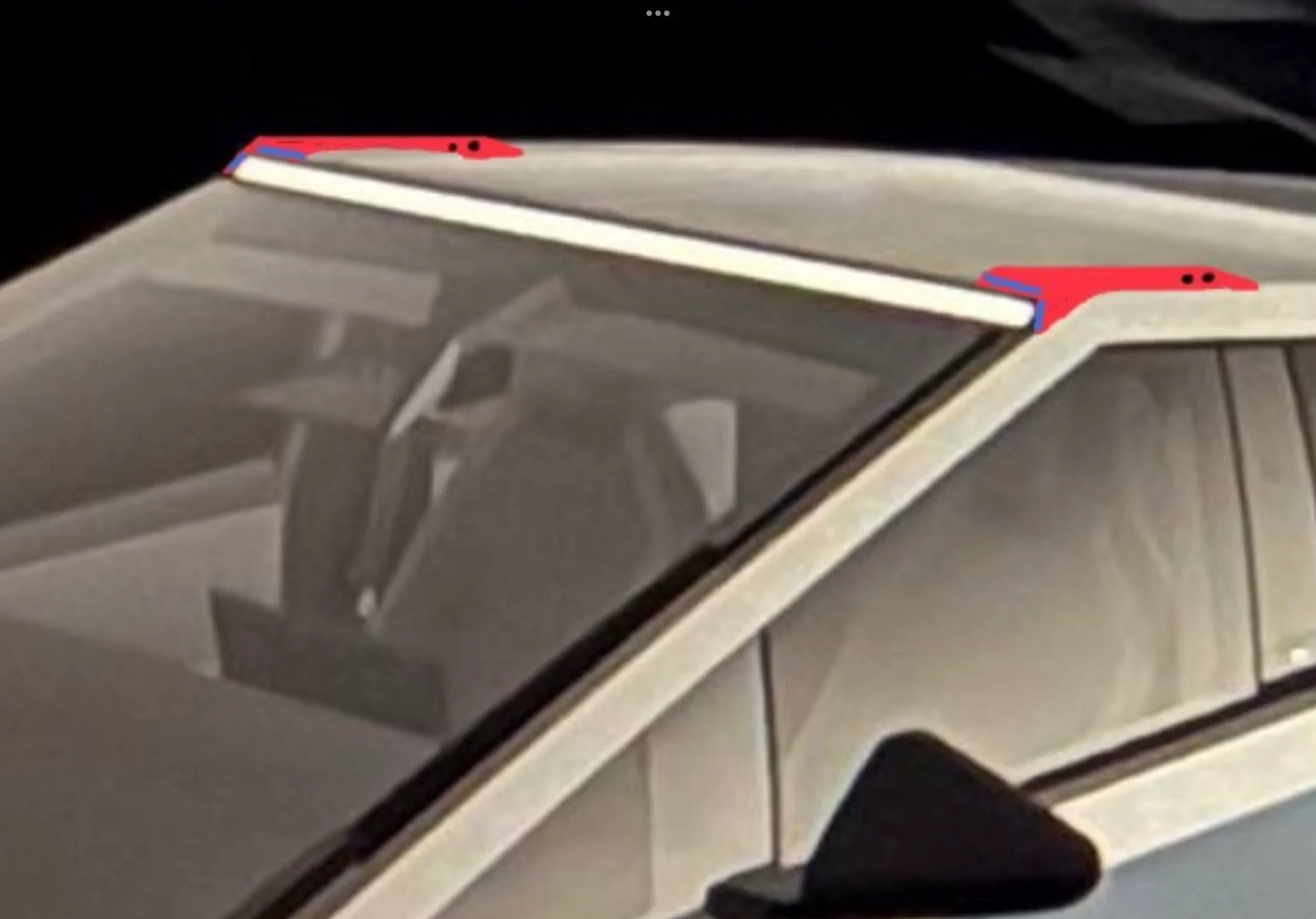

Im considering a mounting method that still uses adhesives but perhaps a less permanent adhesive strip on the windshield, like high capacity command strips and incorporates relatively flat metal brackets on either side that goe along the roof to the front roof mounts to do most of the work of holding it in place.
The idea is that if i ever need to remove it (windshield replacement) it could be put back on relatively easily.
any thoughts/critiques?
While I think this is a fine idea, I don’t think it’s necessary. When I traded in my last car, I used a gigli saw to remove the aftermarket lightbar I had on there with VHB. It was incredibly easy.
https://www.walmart.com/ip/1149974146?sid=68ac32cf-0954-4809-8eb6-0b20846cedc5
Just have to be careful around the wire area not to mow through them unless you want to go through a saga like I did with the oem bar.
If you stick it on the way I did (VHB and suction cups) and the windshield cracks ,you can just remove it like that, remove the old VHB, put new stuff on and reinstall on your new windshield.

You make a fair point- but how well can you really clean the mating surfaces? The glass yes, but the plastic housing of the bar? Idk… These definitely were not designed to be removed/reinstalled- i get the impression that for CB owners, tesla would basically rip it off, throw it out, and slap another one on with a windshield replacement.
for anyone else, i think its unlikely you'd get a replacement unless they start selling them (though i suppose an unscrupulous SC may be more likely to order and install a replacement if you did an oem install…)

The beauty of VHB is that if you go slowly and evenly, you can remove it pretty cleanly.
any leftover residue can be removed with goof off type stuff and then you can clean that all off with isopropyl or acetone.
I have consistently been able to get surfaces that previously had VHB on them squeaky clean before.
I’m not saying it’s super easy but it’s definitely doable

Good to know for sure. I guess the other part of it is that if for some reason it flies off, again, wont be replaced. And Tesla DEFINITELy wont be on the hook if it damages another vehicle if that does happen. I wish it wasnt such a hassle or risk to install cuz i do think it looks really good.
