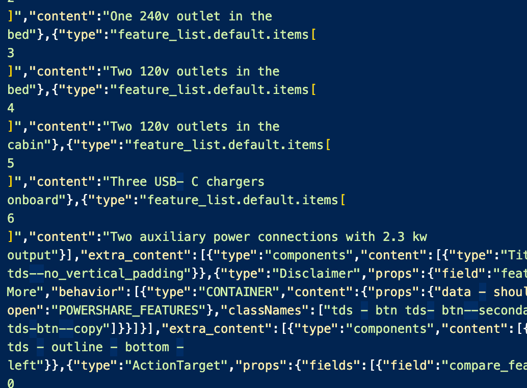

400W is not a lot.
I'd assume that the previous indication from the HTML decode, that these were 2.3kW were incorrect. 400W is usable for lights, front fridge and other smaller users, but these aren't significant enough for a decent winch, now to run hydraulic for lifting a front snowplow etc.
Shame.

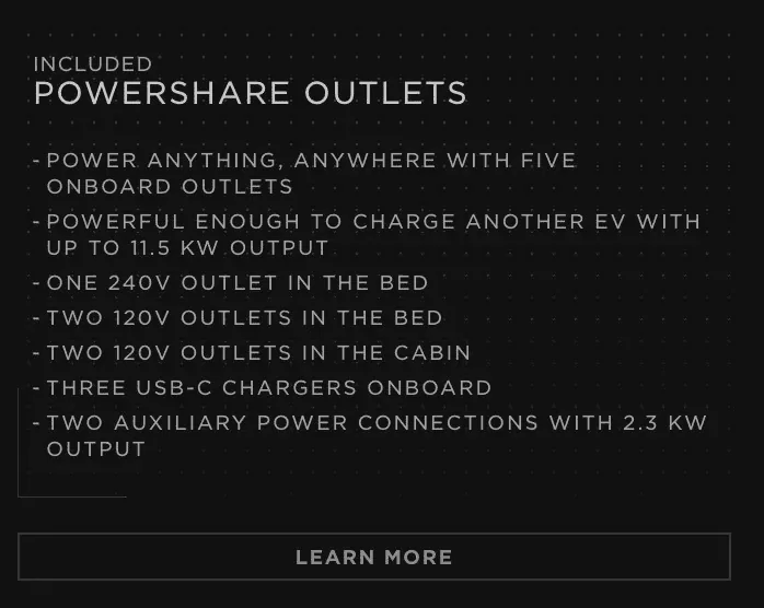

This finding ended up being on the included features list
Tesla Cybertruck Frunk Auxiliary Power Tap / Power Feed Specs (48V and 400W) 1703740690114
Here
Tesla Cybertruck Frunk Auxiliary Power Tap / Power Feed Specs (48V and 400W) 1703740767458
So I wonder if maybe only tesla accessories can access full power? Or maybe roof has higher Amp rating? I didn't watch the whole video but how did they check the wattage?

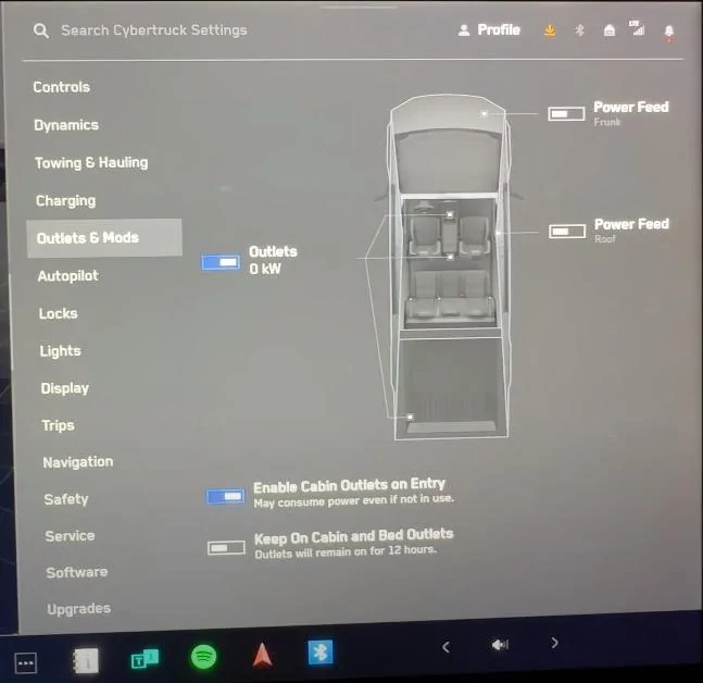

I'm guessing these are just the 2 switched accessory taps. I very much expect an unswitched DC tap of significant rated capacity and most likely 48v.
Yes, from the above video and the previous one to that they correspond to the ones in the "Outlets & Mods" UI called "Power Feed".
