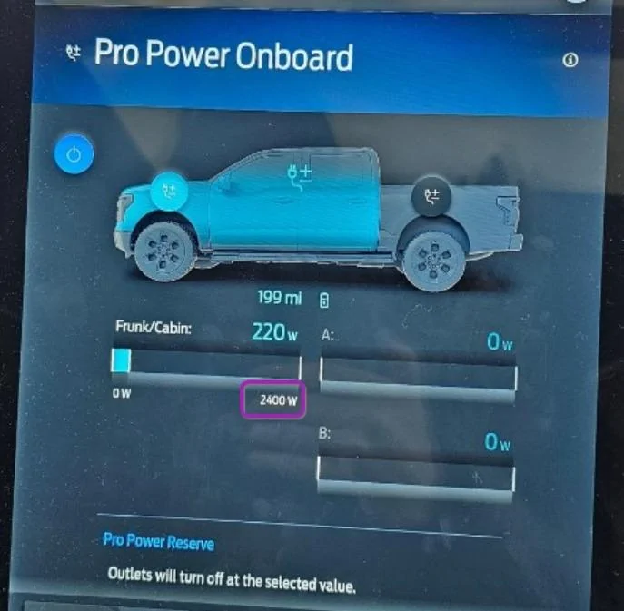

Just saw this novel Ford display on FB that lets you monitor Wattage usage in the Frunk and Cabin up to 2.4kW/2400W

only enough to power essentials in a house during power outages.
I was just pointing out the Ford frunk and cabin and its UI.
The rear bed has a lot more power for your house. See b)
  • a) "Configured with the top-tier Pro Power Onboard system, the F-150 Lightning can deliver up to 9.6 kilowatts. One circuit serves the sockets in the cabin and the frunk, good for 2.4 kW. "
  • b) "Meanwhile, twin inverters in the rear bed deliver 3.6 kW each, and can be ganged up to a single 240V outlet to act as a single 7.2 kW supply if so desired."

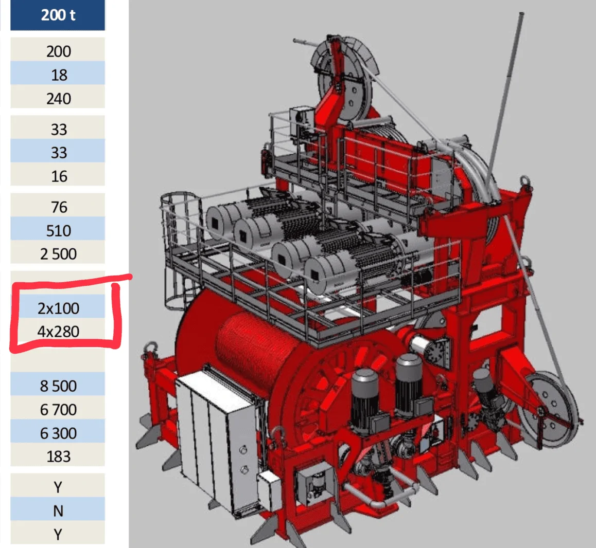

Oh yeah? Well, the 48V ain’t gonna be enough power for this bad boy! 4ea 280kW motors on top of 2ea 100kW motors, for 1,320kW of power required. Oh sure, you’ll need an aftermarket bumper to mount it on…
The 16,500lb Warn winch pulls 507 amps…
https://www.warn.com/165tis-heavyweight-winch-97740
Ah yes, the classic model: "YOUR-MOM-HOISTER-5000".
Great product.

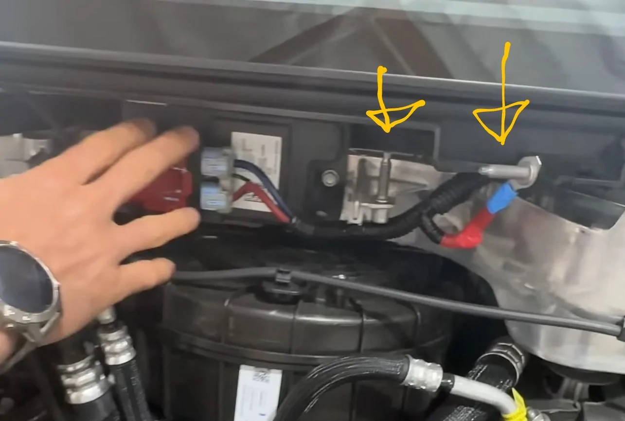

I will mention that I did watch the whole video and saw they have tap to 48v battery. I'm assuming that will be plenty capacity for winch, though a constant load like a snowplow is likely to be a problem depending on what the spare capacity of the dc dc converter they are using is.
Are you saying you saw in the following video (from the 1st post) that you saw they have to tap the 48v battery? They said that in the video? Can you point to the the MM:SS location of that? I did not hear that.
There is the 400w switched tap. There is also shown two bolts next to the 48v battery which directly tap said battery. I mean, nobody said anything about that being where winch accessory gets its power, but that is 100% where wrench accessory gets its power.
