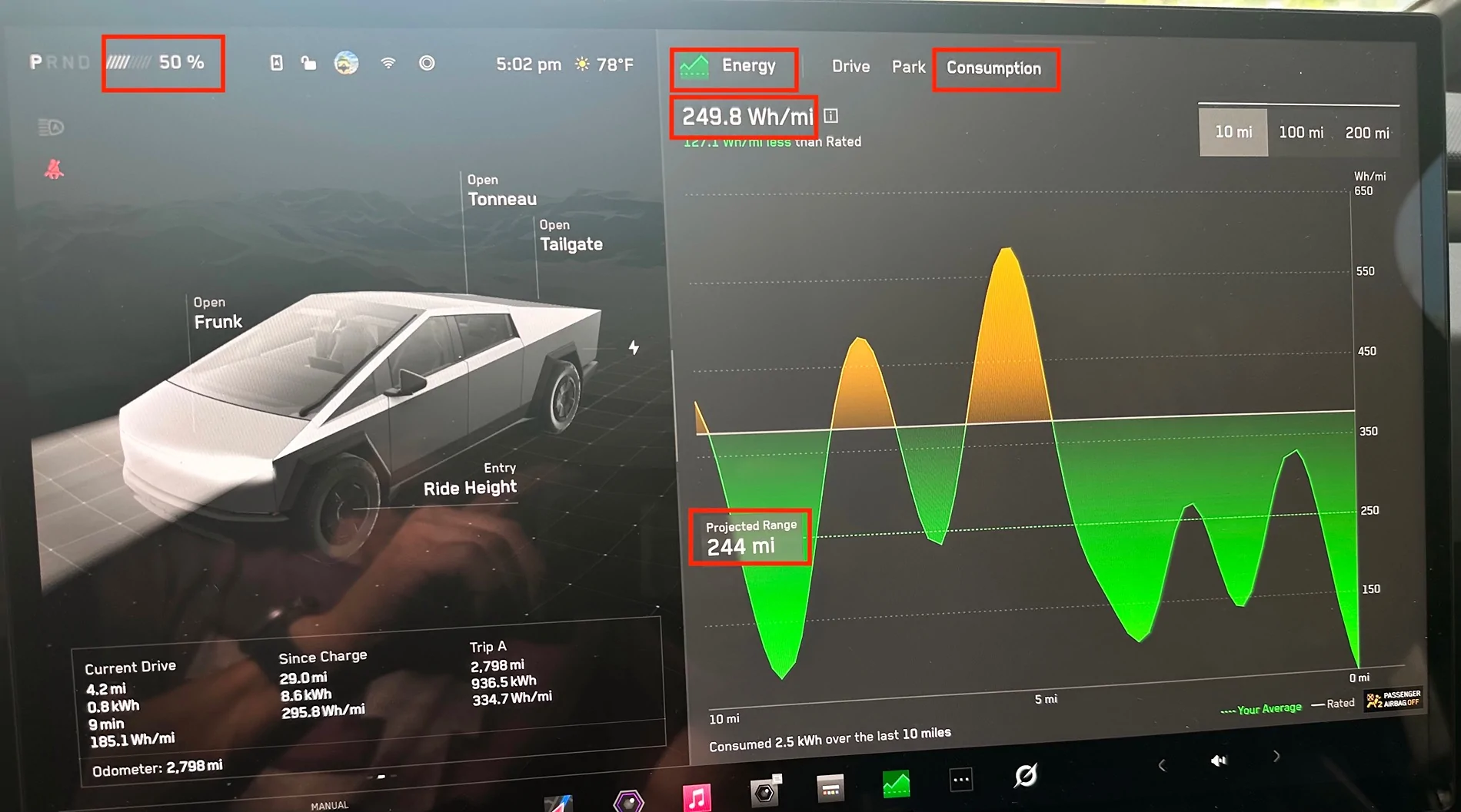

40mi at highway speed. My CT would be about ~400Wh/mi, so 2.5mi/kWh. That would be 16kWh used. You used 20kWh. So, 4kWh used in the shop. Don't know what happened there, doors open, heat or AC blasting? It's possible.
If you want to know what the BMS thinks your battery size is, do the math from the Energy Consumption screen. It doesn't matter which mileage you use, 10/100/200. Take the efficiency number multiply by the projected range and divide by your SOC. That will give you what the BMS thinks is your battery size: In my example below, take your 249.8Wh/mi times 244mi, gives you Wh. Divide by the SOC, 50%, gives you the battery size in Wh. In this case, 121,900Wh. Of course, there's margin of error, as you can imagine the 50% is rounded.

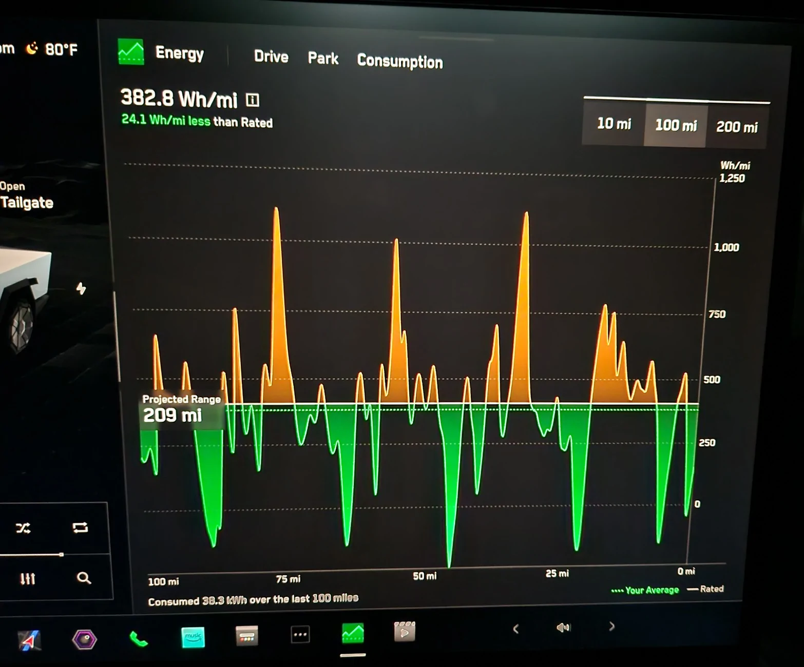

Ok so here's the data, I set it to show the last 100 miles since the last trip it had saved was only from the SC to home and not both ways. Can someone translate into English for me? I'm not great with interpreting it. It says my projected range is 209 miles.

209 is range based on current charge level. You are averaging better than EPA estimates. At 382.8 Wh/mile a full pack would be 321 miles.
The drive and park tabs have more info too.

So doing the math as you showed, if I did it right I got 1230.8,
I took 382.8 x 209 % 65, the truck is currently charged at 65%. Did I do that right? And is that a good number?

You shifted a decimal place
382.8*209/0.65 = 123,085 Wh = 123.08 kWh (expected pack size)

Yes, 65% is .65.. I was close lol. Ok so everything is running like normal and as expected. Thanks for the input, I appreciate it.
