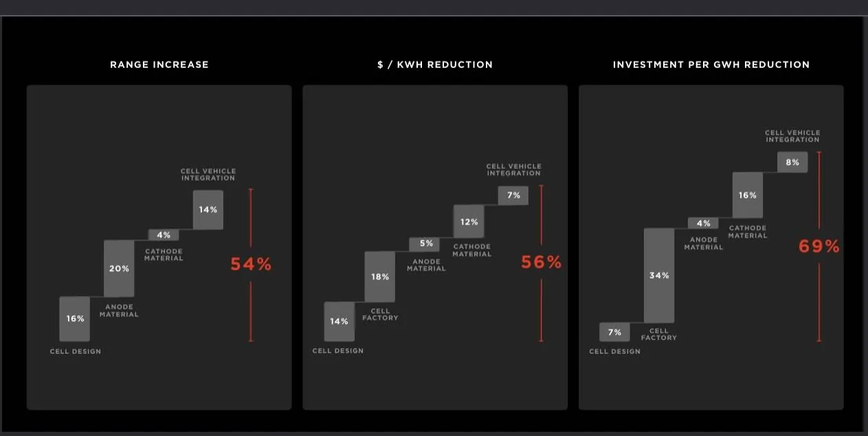

Removing the solvent does improve degradation, but doesn't impact inital energy. It's the future high silicon anode which was called out as boosting capacity and to a lower extent, high nickel cathode. https://digitalassets.tesla.com/tesla-contents/image/upload/IR/2020-battery-day-presentation-deck
Tesla Cybertruck Non-foundation vs foundation range, new battery? SmartSelect_20250103_154600_Firefox
It is illustrated here as a 4% range increase at best, and 12% cost reduction in terms of materails. The big change is eliminating the wet process / drying steps needed in a new assembly line as indicated by the 16% investment reduction since you don't need as much equipment. Cybercell V2 already has the dry anode material, but we're just lacking the dry electrode material.
DBE's big boost is for scaling production at lower costs.

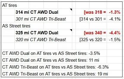

That's as useful as the battery day presentation where Tesla said the 4680 would get 5x energy 6x power and 16% range increase.
Tesla said earlier this year that dry cathode "is more for in house efficiencies". It's not going to produce much for consumers in range or charging speed, especially at first. If anything it will be less range and lower speeds for SC, which could be what we are seeing with Non-FS.
Possibly how we ended up with the red below in recent changes?
4.4% is nothing to sneeze at if you are road tripping and trying to skip supercharges.
