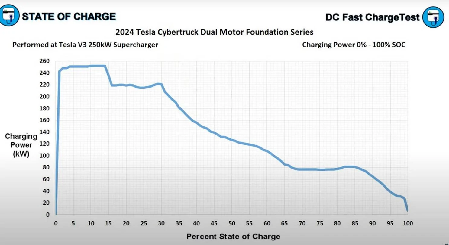

Gigahorse
Dec 19, 2023
2,873
3,269
AWD
the 800w being
You mean 800V, right? the 800V vs 400V has no effect on level 2 charging.
If charging at home (0-100% in 12.5hr) is not fast enough, then you probably need to go to a supercharger.
Yea, then you go to a supercharger and the charging curve looks like this.
AKA the back 70% is the same as a Model 3 or Y from 5 years ago.
