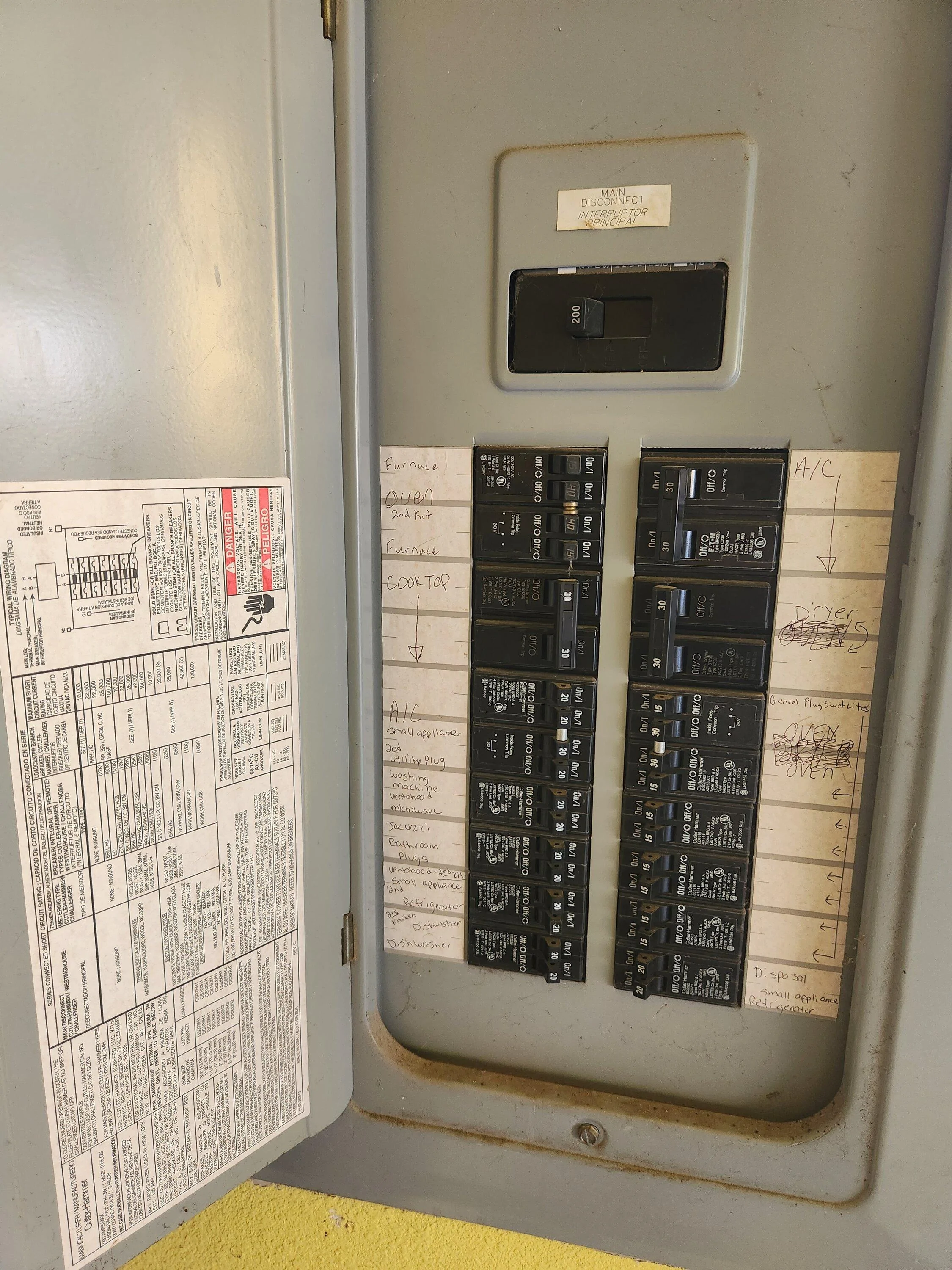

Alpine, u have a 200A main breaker, so your panel is capable but u r out of space.

Possibly but no... possibly in that you have 200 amps incoming so that is prolly eough power for the charger.. no because you would need room to add a 60 amp breaker <2 30 amp breakers ganged> ad you don't appear to have room for 2 new breaker.

U could have a 100A sub-panel installed and move one of your appliances double breaker & wires into it and power it from the newly opened space.
