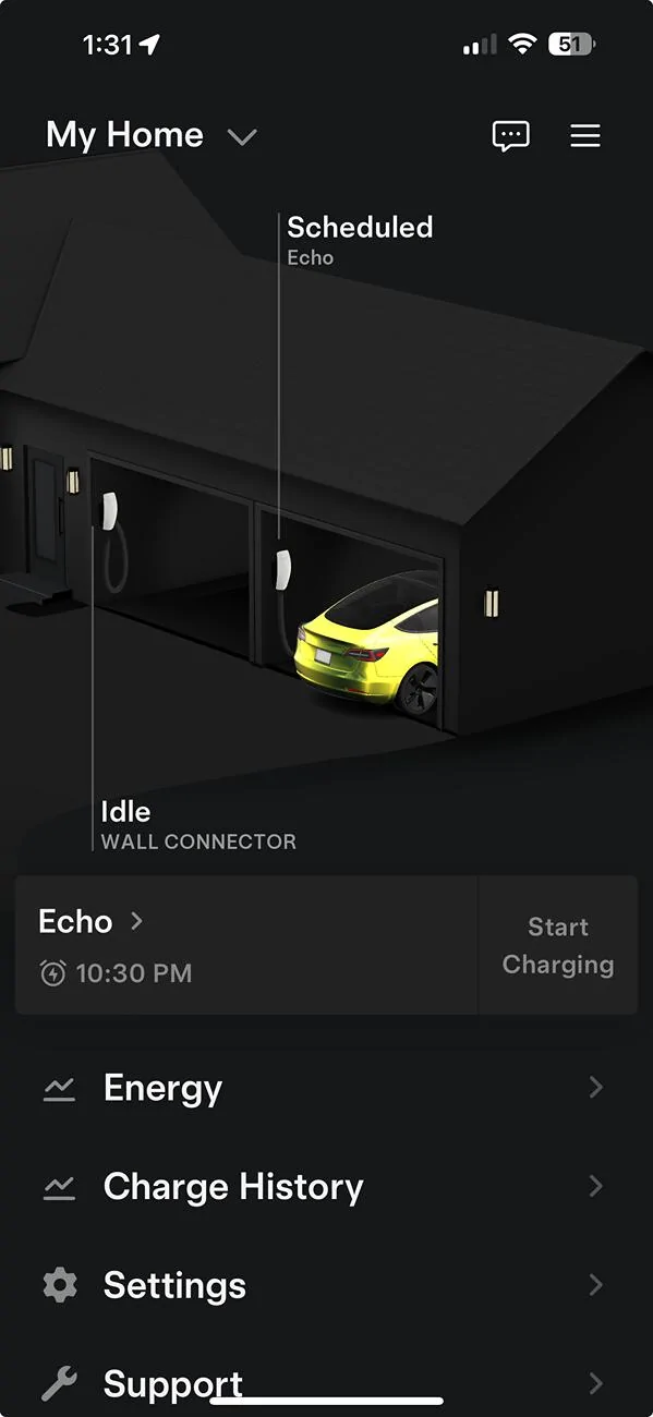

Further the explaination:
WiFi from the wall connector, aka “charger” is used for app connection shown below:
Tesla Cybertruck Wifi wall charger for the home. 1736447494233-u0
And continuous firmware updating
