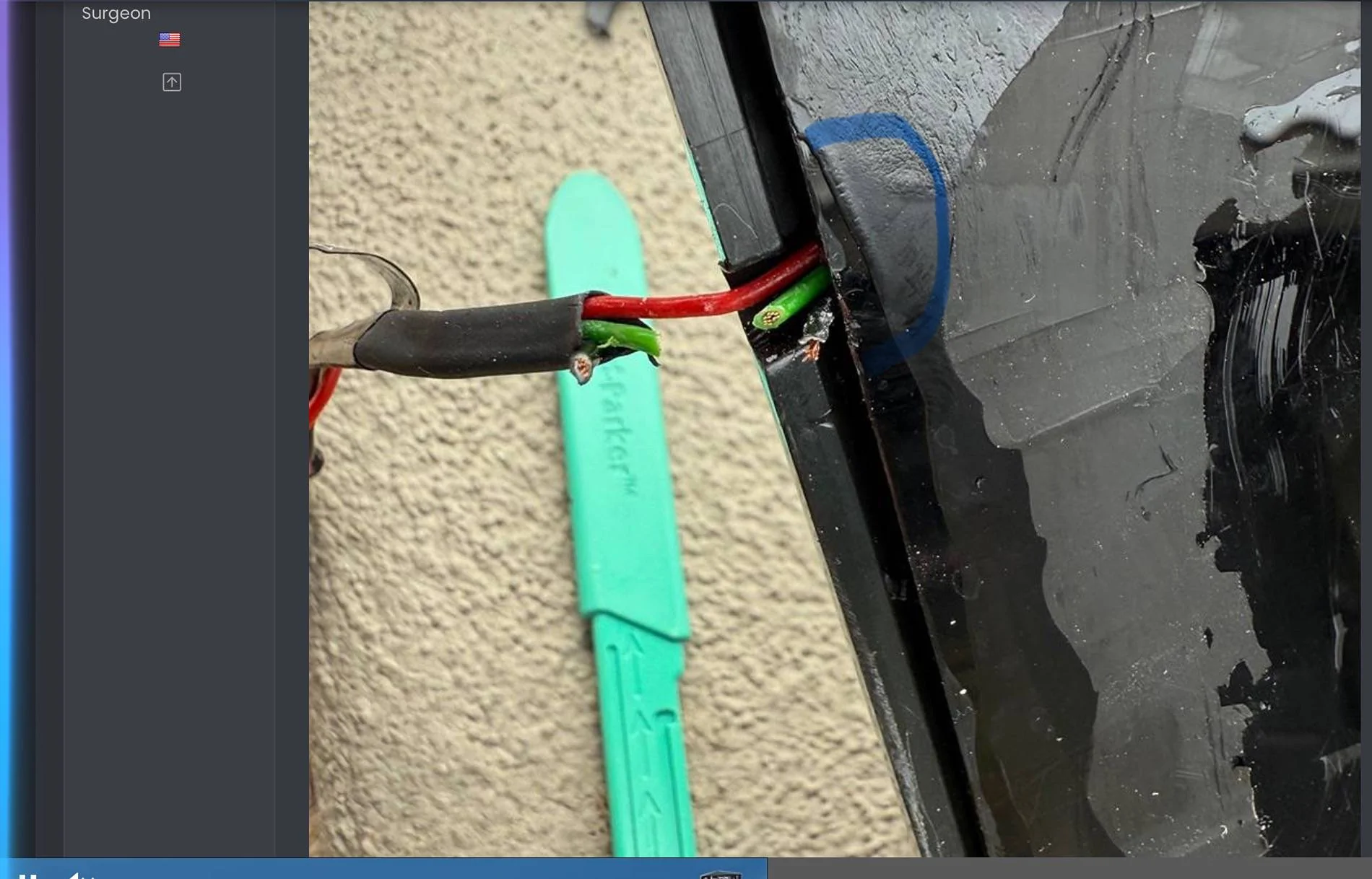

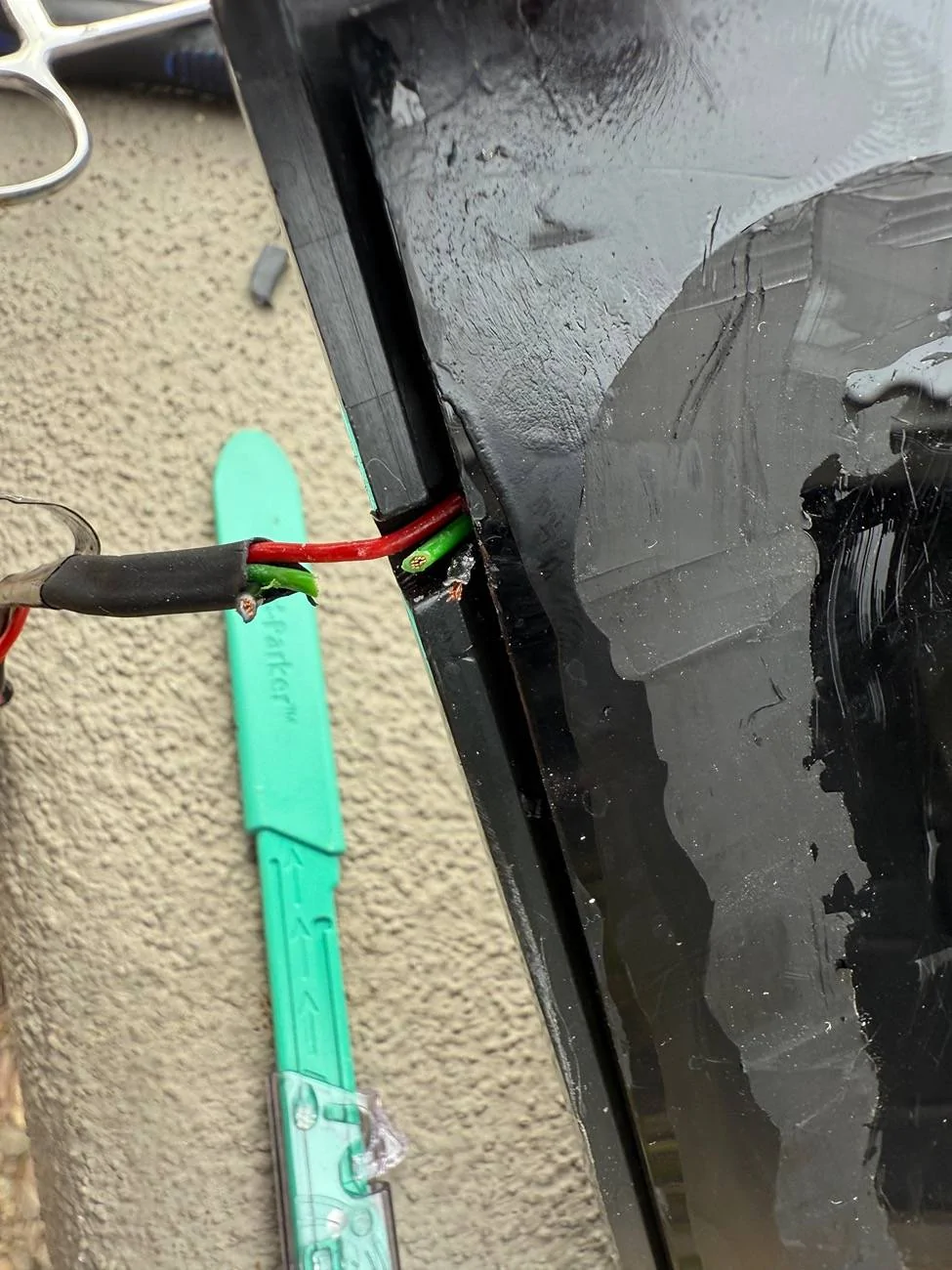

Ok. So Pete and the other scrapers were right. It worked but I did a very boneheaded thing.
Right towards the end I lost control of the blade and hit the wire transecting the black and green. I carefully dissected it for exposure which is how I know it’s black and green. It’s rather close to the bar unfortunately.
I don’t have have that kind of stripping and soldering skill. Anyone have any advice or did I just throw away this bar?

What’re do I find someone amazing at small
Soldering? Is there such a thing as a tv repair shop or that kind of thing any more?

This really is the project that keeps on giving! I think you could use a solder-seal butt connector...if you watch the second (19s) video on this page, you'll get an idea of what's needed, but I think you just about have enough wire for it.
Why not cut around the green/black wires to expose them more to strip them ? You can carefully cut a semi-circle around those wires and after you restore them with press connectors fill in the space with silicone.

Since you work around surgical equipment, sometimes the hospital equipment maintenance departments have really good soldering equipment. A buddy of mine used to do that work at Banner, but he's since retired. Check with them and see if you can get a favor.
