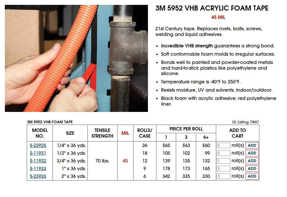

I'm not sure you want to go through the pain of stripping it off the lightbar now that it's on there, with the adhesion promotor, that would be a brutal job. I tend to only buy VHB from trusted retailers (uLine, mostly, or Lowes/HD if its anormal size) as there's so many fakes on Amazon, eBay etc, in fact the majority are likely fake. Below are the prices from uLine, the real stuff isn't cheap. People ask all the time why our Rimtrims are so expensive compared to stuff on Aliexpress, Amazon etc, and this is why, the real 3M products are 4-5x what the clones cost.
Anyway, back to the point, if I were you, I wouldn't undo what you've already done, unless it seems like it'll come off easily and cleanly (if it does, it's for sure a bad product). Otherwise, plug on, and just check it every now and then. This stuff doesn't spontaneously fail, it'll occur over time, so just give the lightbar a prod every now and then.

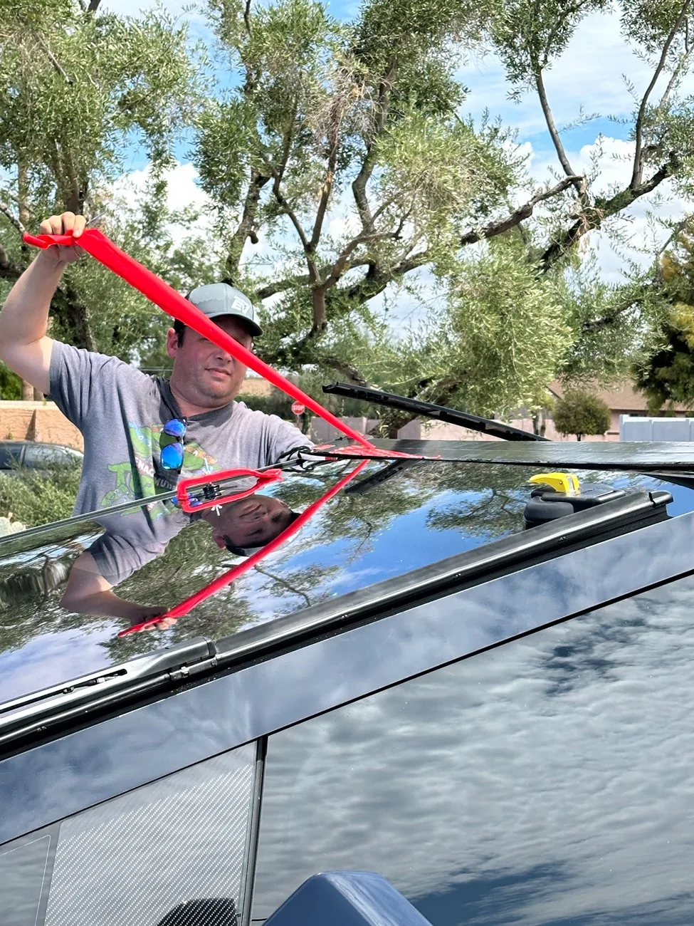

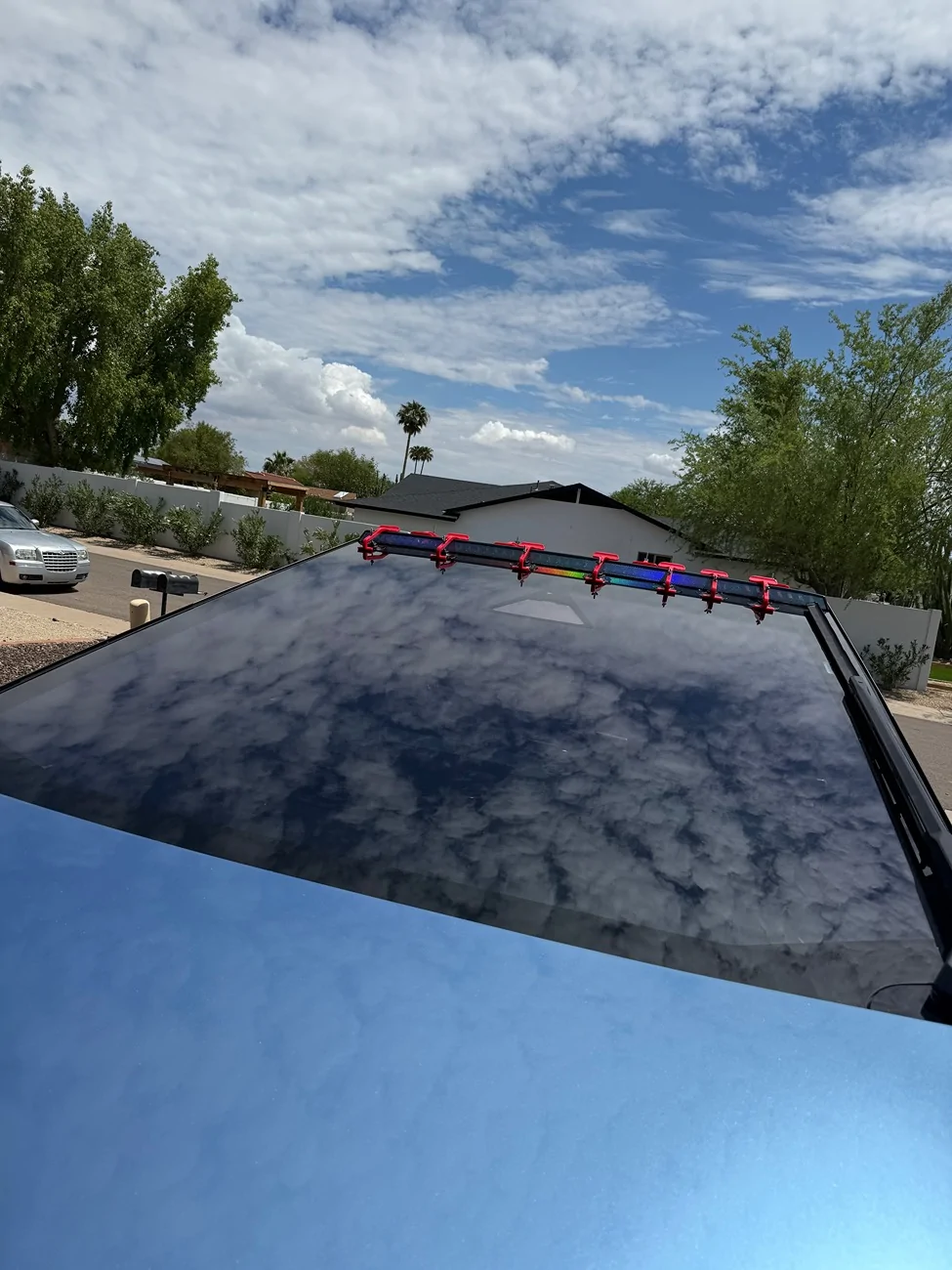

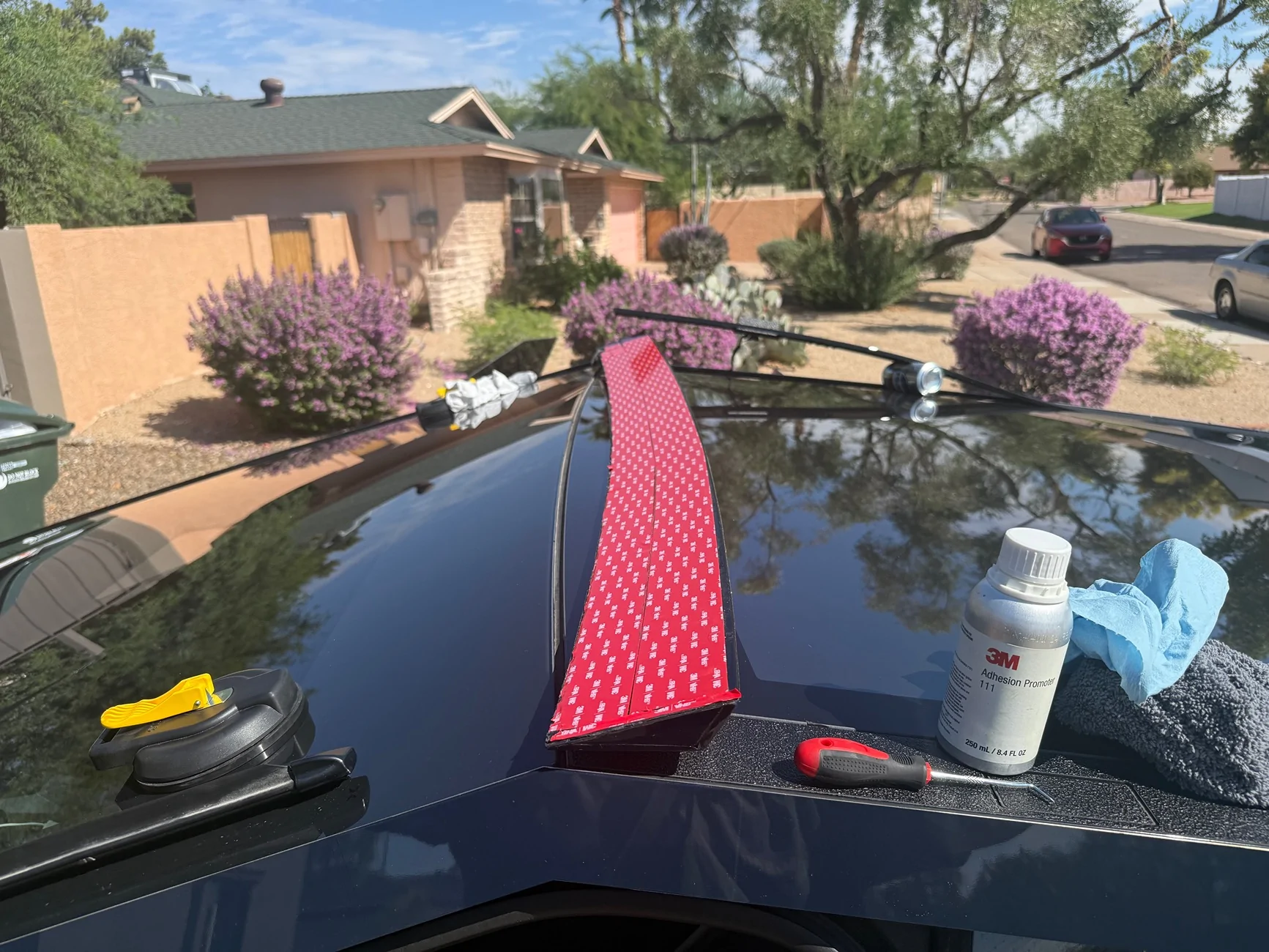

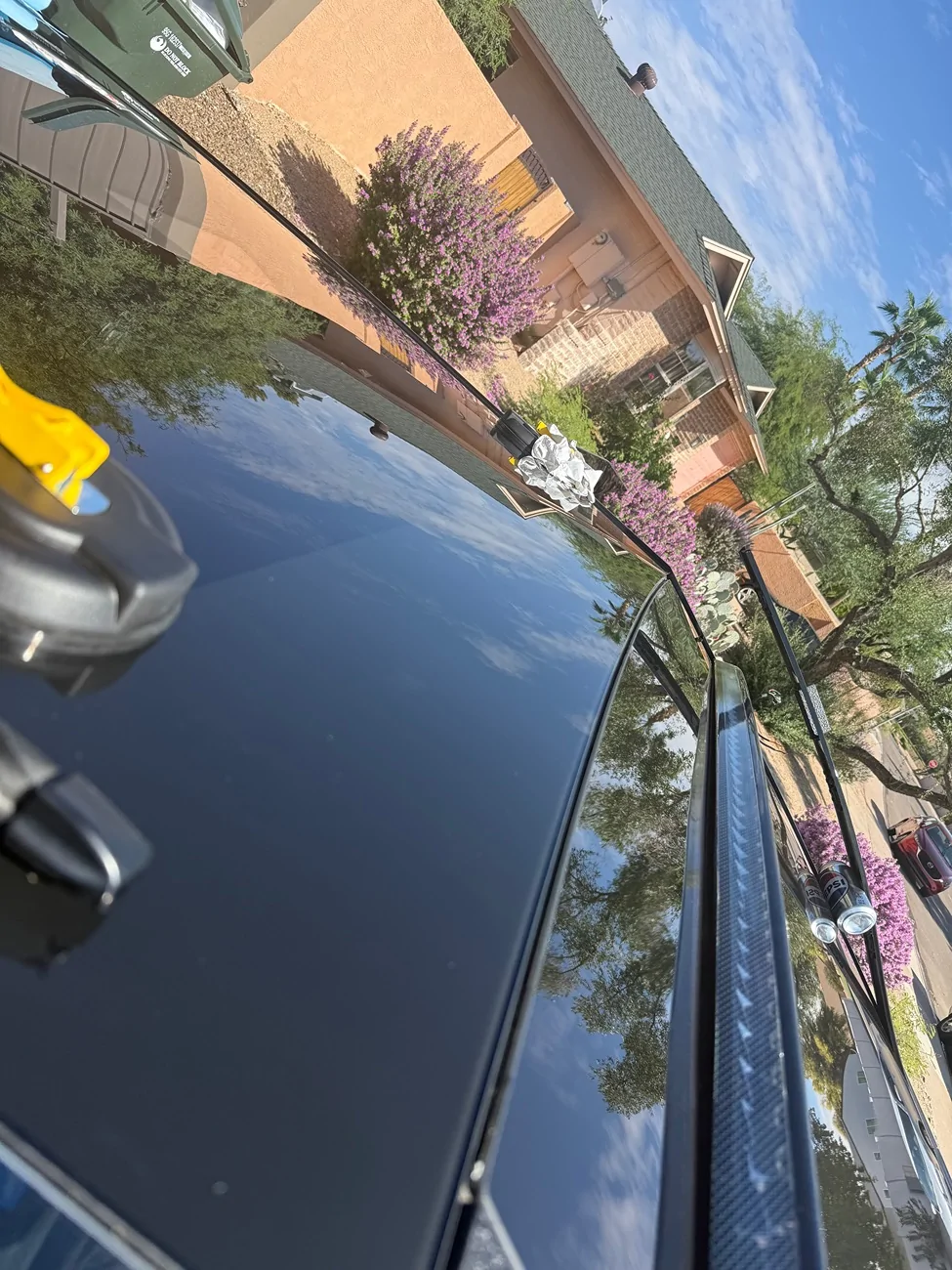

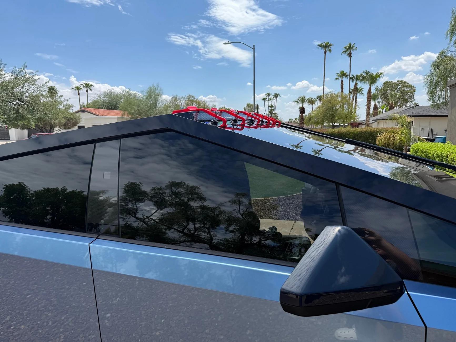

So installation day is finally here. Now that the cantrails are adjusted. I wrapped the bar in the same dark blue as my cantrails and applied the same iridescent film to the front I have on my DRL. After connecting the three wires I previously tested back up with crimp connectors, we cleaned the glass with rubbing alcohol, applied adhesive promoter and then lined it up (thank you @CT_AZ_4x4 for coming over to help). The maybe authentic 3m tape gripped super hard and is very confidence inspiring.
The suction cups may not be necessary but I bought two pack in the interest of overkill and torqued them all down nice and tight.
Will likely leave them on about 48hrs.
Will keep you guys posted.
And yes….the lightbar conclusively works with the AWD.
Thanks again to all of you for the solid advice.

So if any of you ever thought you had to answer a lot of questions about your truck at a supercharger, try rolling up with a bunch of suction cups attached to your roof and a new light bar. Holy shit……the paparazzi was intense.

Great idea with the suction cup thingys, Tesla just threw some sand bags on mine while it curred

Thanks. They are still on there. Probably going to pull them off in the morning.

Tesla is using a completely different attachment method. VHB tape is pressure activated and requires around 15 psi. Tesla uses a urethane, so the sand bags are just to hold it in position during cure.

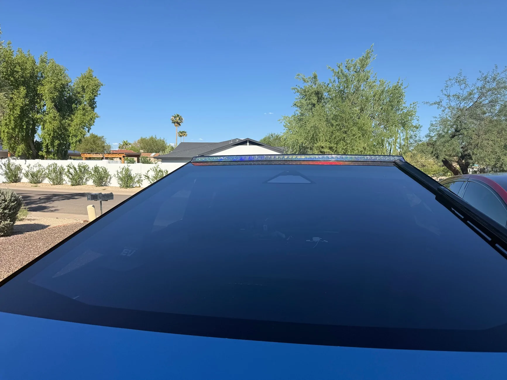

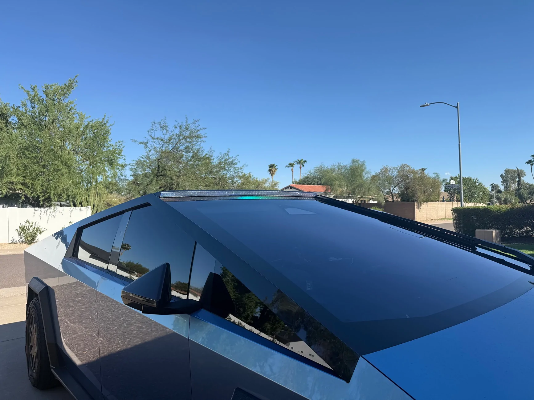

Alright. Short term follow up. Suctions cups are removed and that thing is freaking ON THERE. I hand wrestled it some this morning and I have total confidence in it going absolutely nowhere.
The dark blue wrap like my cantrails and the matching hex Film to my DRL look much better than I thought. With the glass it produces a cool rainbow effect in the reflection and almost looks like a double bar. Not visible from the cabin.
Hard to photograph but I tried. Truck is a little dirty but you’ll get the idea.
Overall, I love it.

Photos make it look kind of narrow and monochrome but in the sun it’s like a strip of “rainbow road” across the entire windshield. Very cool effect.
And the Ditch and center light features as well as the brightness control on the screen are SO cool.
happy I did it.

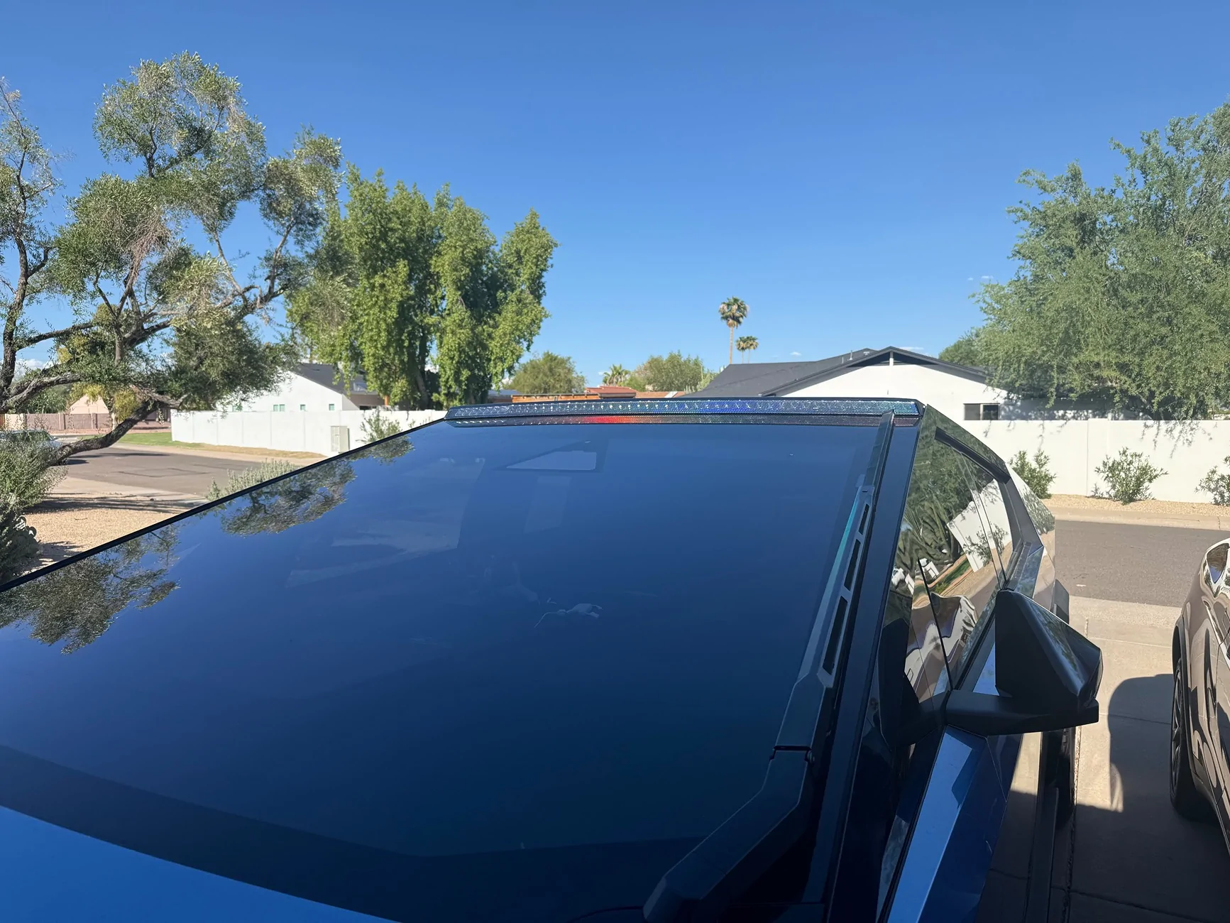

Ran through an automatic car wash with it today. Tthis thing is completely fused to the glass. No way it’s coming off at least in the short term.
Will report long term but I highly recommend this method over Tesla’s.
Also tried to get you all a better picture of the hex film in the sun but it really is hard to photograph.
