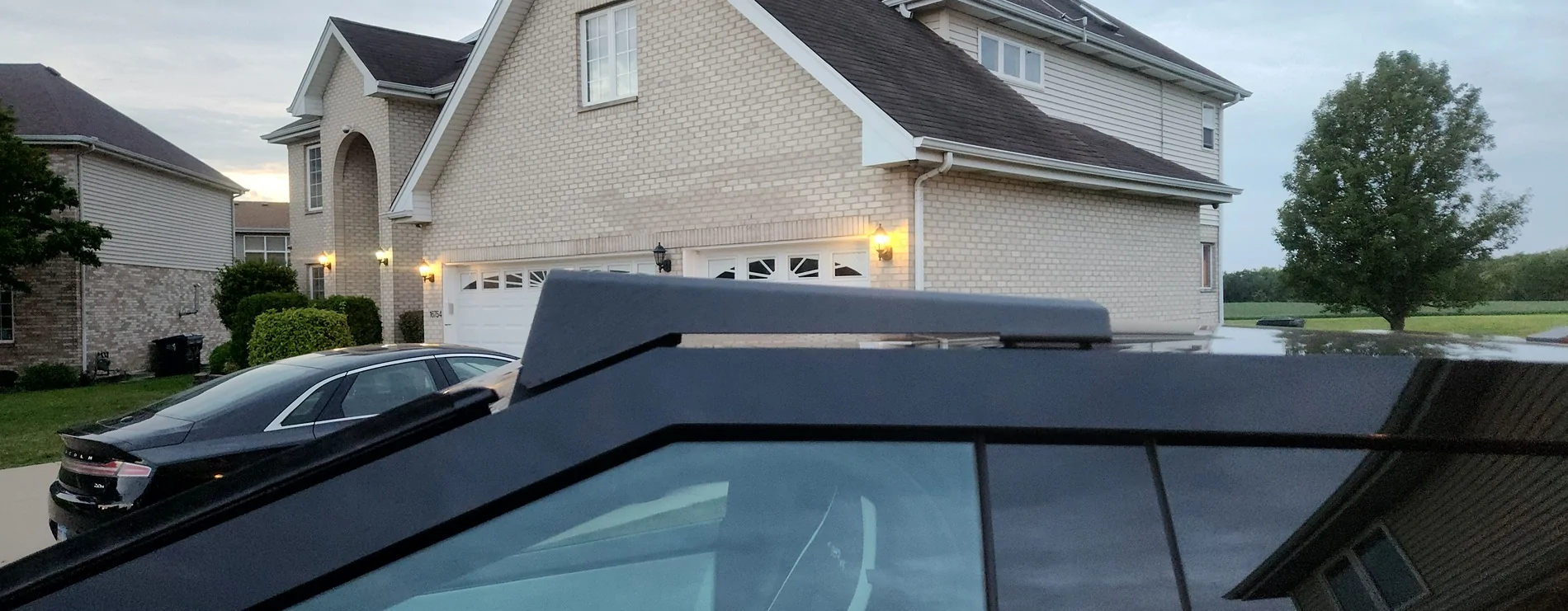

I did this the second time (second OEM lightbar) around (click below): I even purchased the exact primer recommended by Tesla and everything. .
Off Road Lightbar (Retrofit)
That one is on I80 in Indiana somewhere on the side of the road in a ditch.
Now I have the 3rd party bolt on (no adhesive or tape or anything - perfect fit).
Tesla Cybertruck Best way to glue on a used OEM Beast bar 20250829_192658

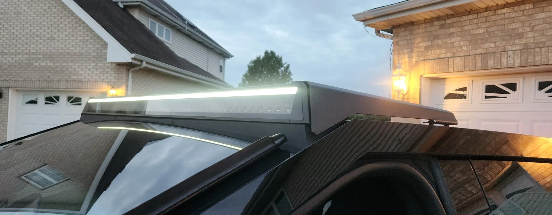

With the lightbar DRL on.
Tesla Cybertruck Best way to glue on a used OEM Beast bar 20250829_192816

@gtgarner - can you give more information about the 2 pictures you posted?
Tesla Cybertruck Best way to glue on a used OEM Beast bar 1756739133976-kt
Tesla Cybertruck Best way to glue on a used OEM Beast bar 1756739097176-4k
Is that the OEM light bar with an aftermarket bolt-on cover or full aftermarket light bar that comes with that cover? I'm thinking it's a full aftermarket, but it looks so clean and close (appearance-wise) to the OEM that I'm split 50/50 on which one it is. :D
EDIT/UPDATE - it looks like the above is the XKGlow light bar (https://store.xkglow.com/catalog/pr...esla-cybertruck-rgbw-chasing-drl-app-control/)... would appreciate you confirming.

My appologies.
Those pictures are from the 3rd (current) lightbar I installed.
1. OEM (Tesla)
2. OEM (Tesla) Following these explicit instructions to a tee. Off Road Lightbar (Retrofit)
3. Fully 3rd party bolt on light bar. XKmax Cybertruck Roof LED Off-road Light Bar w/ RGBW DRL | XKGLOW
The 3rd option is an absolute perfect fit - only made for the Cybertruck.

Appreciate the clarification - thank you! It helps me to understand what I'm looking at...so many of the aftermarket light bars are so similar and nuanced in their differences that it's difficult to keep track of them. The XKmax looks fantastic.
