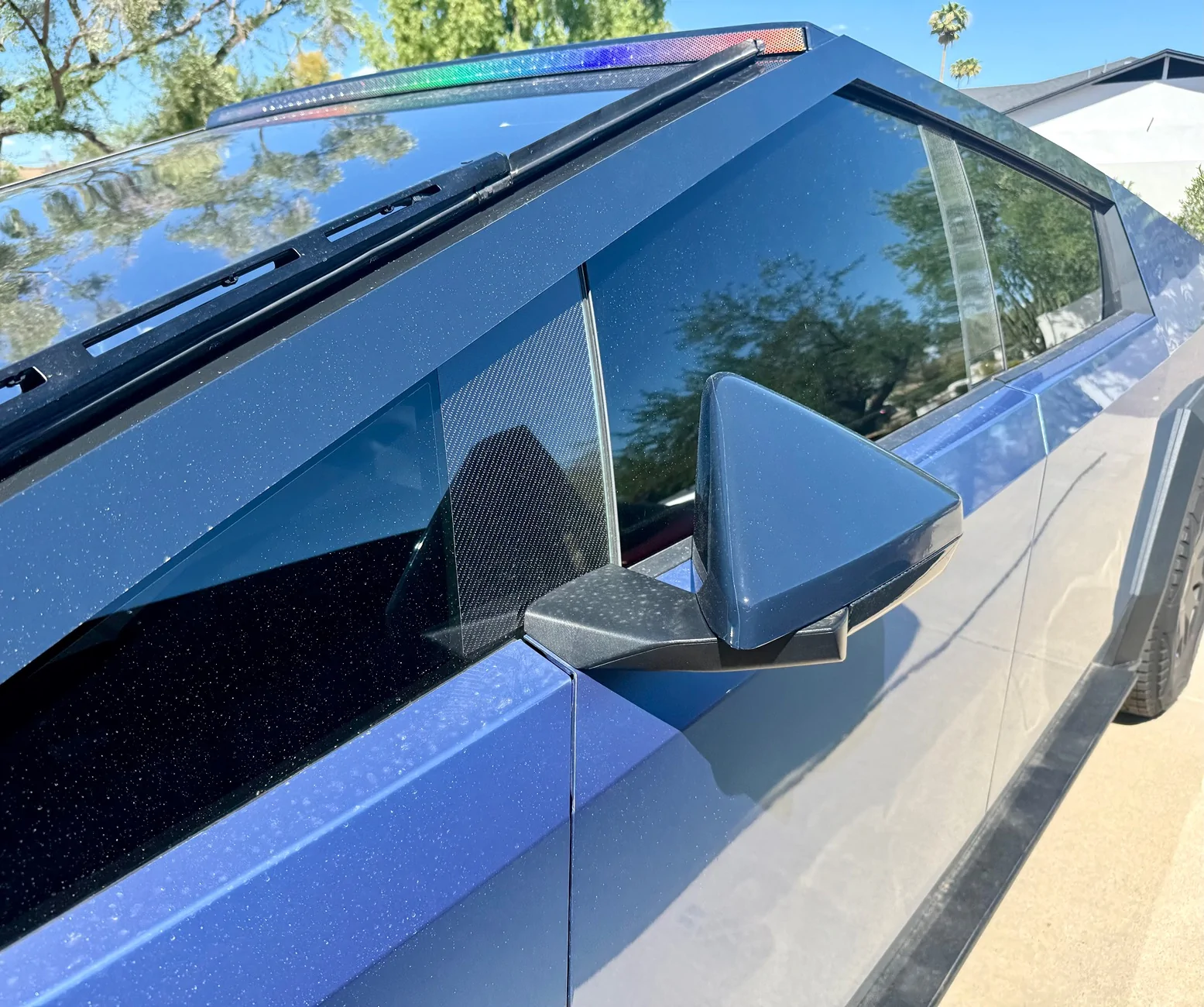

Ran through an automatic car wash with it today. Tthis thing is completely fused to the glass. No way it’s coming off at least in the short term.
Will report long term but I highly recommend this method over Tesla’s.
Also tried to get you all a better picture of the hex film in the sun but it really is hard to photograph.
