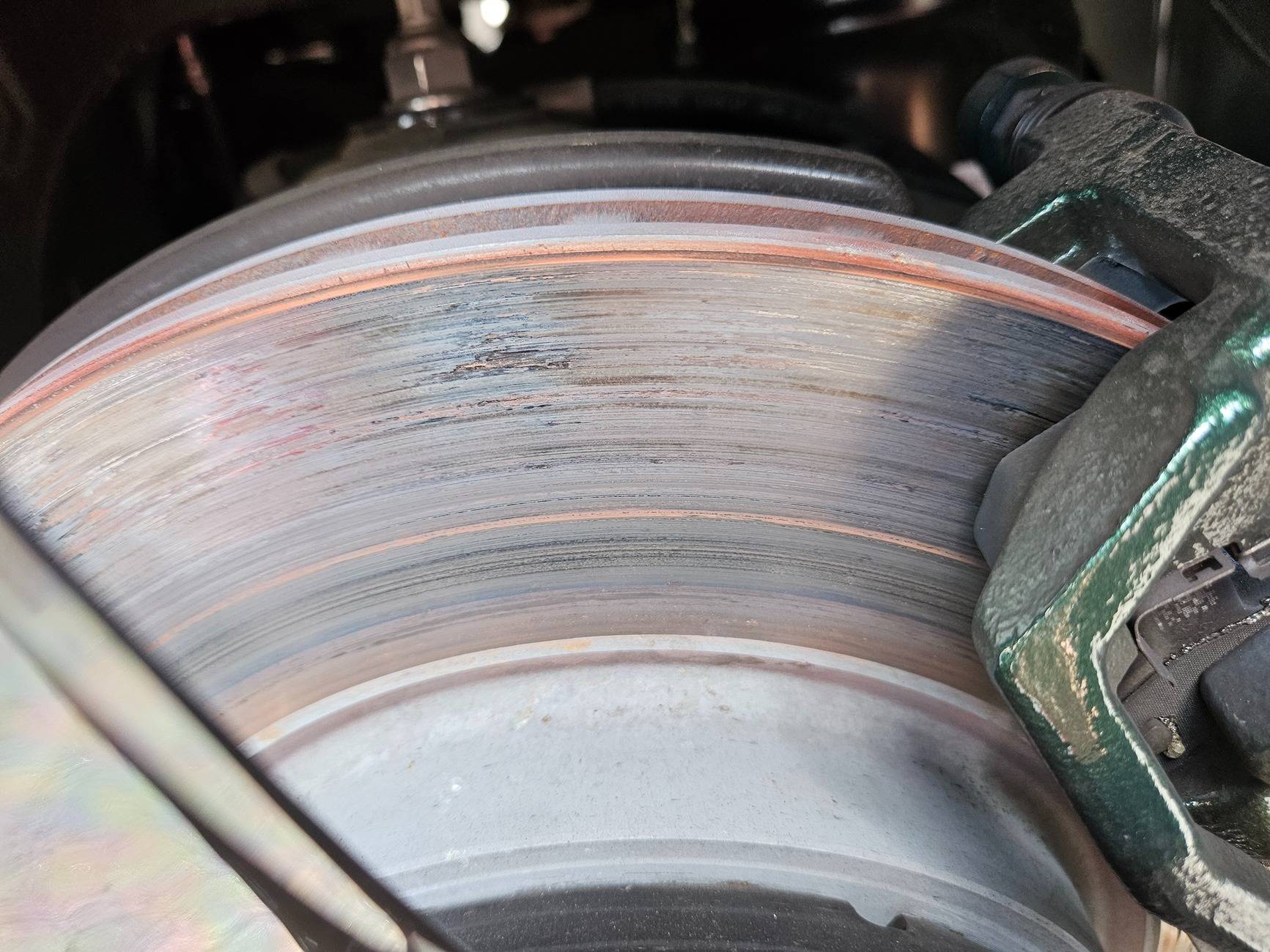

I had a ten mile drive, 50 mph average, last week. Pull into the store parking lot, a guy is pounding on my window saying you're on fire. WTF? Jump out, smoke pouring out of left rear wheel well along with a small orange flame coming from brake pads. Fortunately, it was small enough for me to blow out. So glad the trip wasn't longer. I recall seeing semis burnt to the ground from seized brake fires. Have no idea if the wheel was locked when I left the house or it engaged enroute. Called for a flatbed back home. After it cooled somewhat, I backed to pickup location. Tow driver said it was turning freely. It goes to SC in two days for replacement rotor and pads. Since we cannot control the parking brake mechanically, like back in the day with that lever under the dash, was this not an electrical or software anomaly? There was no indication on the touch screen of a malfunction. How does the brake on one wheel decide to lock up?

Your caliper and bracket appear to be painted and/or powder coated - what was actually done? If you rattle canned it on with some high temp paint, one of the pins/pistons could’ve seized.
if you did it correctly, and removed the bracket and the caliper for powder coat — did you isolate all moving parts and bleed the brakes properly after?

Truck was wrapped with color coordinated calipers by one of the big name professional shops one year ago. At this late date I'm confident their work did not cause this. I'm sure the SC will attribute the fire to the paint.

Yes, no indication of scorched paint.

Do you have an update on the SC feedback?
Electrical malfunction causing that one wheel to seize. They had it for three days, gave me a CT loaner. Replaced rotor, caliper and pads under warranty. Excellent service from my SC. Could have ended differently had I driven another mile or so.
