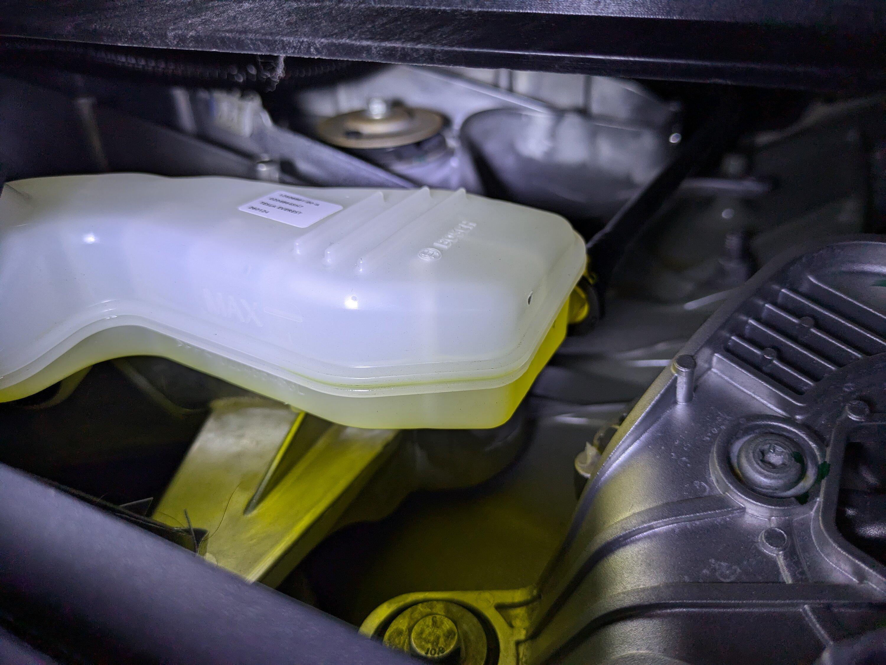

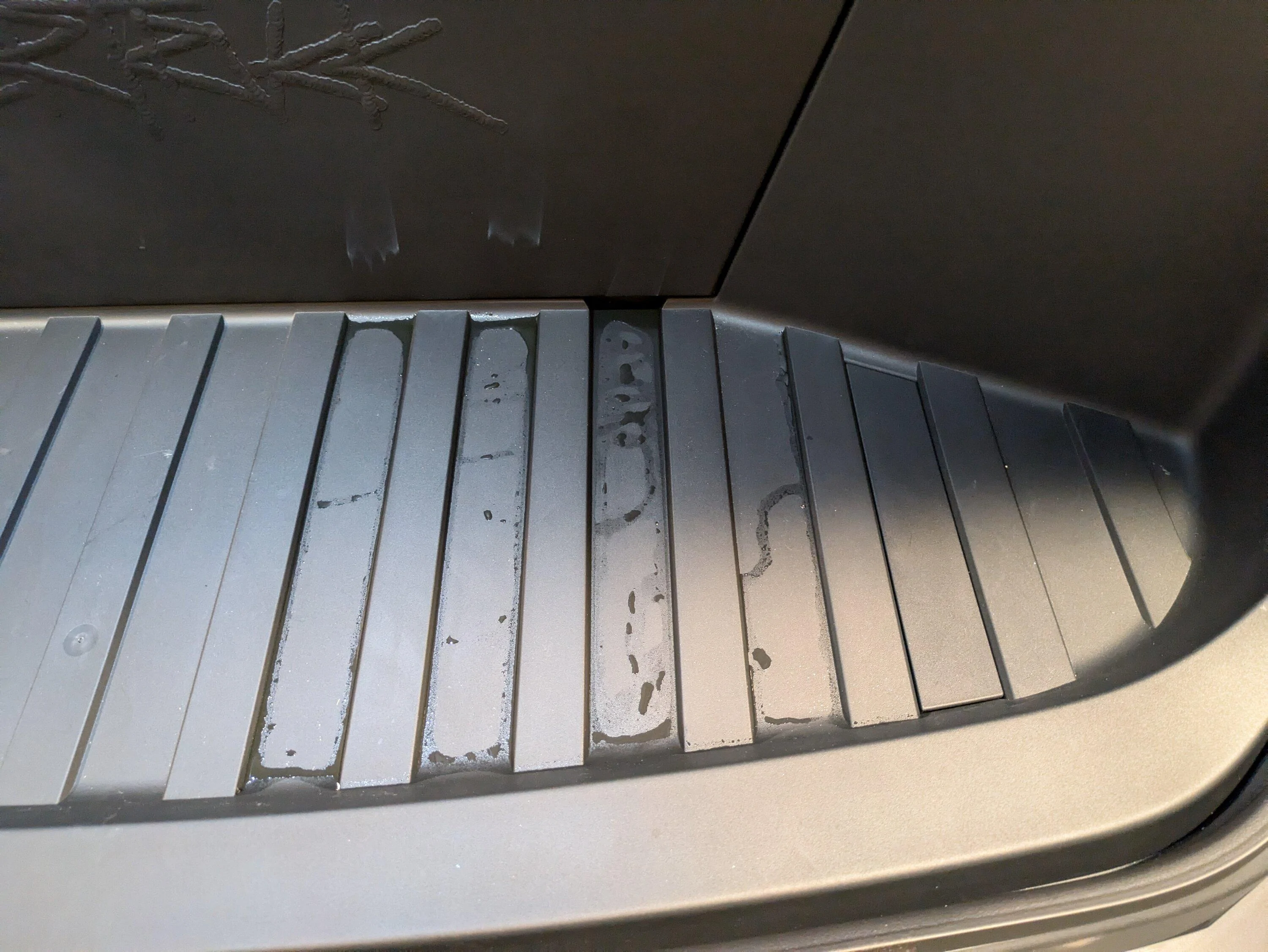

I noticed when I took delivery that there was a little liquid in the frunk but thought it was just water from the detailing. The next couple times when I opened the frunk I saw liquid and just wiped it up. This time when I wiped it up I noticed the liquid had a yellow tinge to it so popped off the maintenance cover and saw the brake fluid reservoir was wet and the inside of the maintenance area had small droplets all around the reservoir. The reservoir still looks about half full.
Anyone else have this issue? I just put in a service request but it will be a couple days before I can go in.

I tried tightening the cap but it was on there good. I think it's leaking out the seam in the middle of the plastic. That seam was wet all the way around that I could reach.

Might be a bad plastic weld on the reservoir.
If that's it, it's a super-easy fix.

Hopefully they can just swap out the reservoir and be done. Any idea if it's the same as other models and something they might have on hand?

Update: after initially scheduling my service appointment for a few days out, the next day they changed the date to today (2 weeks after initial request) to wait for the replacement part to arrive. I went it and they fixed it in an hour with no hassle. Pretty easy service appointment.
